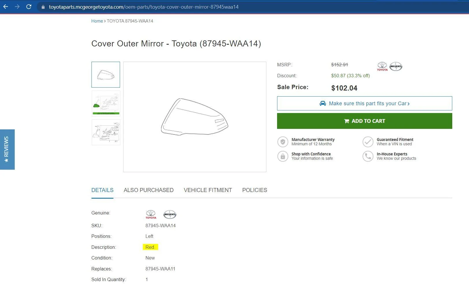

Hey guys,
Does anyone have a confirmed VIN number for a launch edition? I'm wanting to order the red mirror caps, but when I provided the correct part numbers (87945-WAA14 & 87915-WAA14), Toyota still sent me black since as that's what my car came with, stupid I know.

I know of one, but I'm not sure how it would play out with you being in Scotland and all..and those are not the part numbers of the Red caps you have listed. If you want the Red LE caps, the part numbers are 87915-WAA15 and 87945-WAA15.
You provided the wrong numbers if you were hoping to get Red, so it's not Toyota's fault. The WAA14s are satin black, like they're supposed to be.

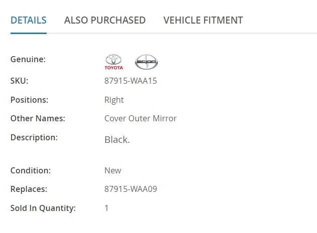

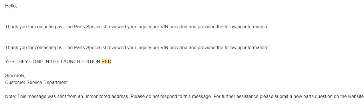

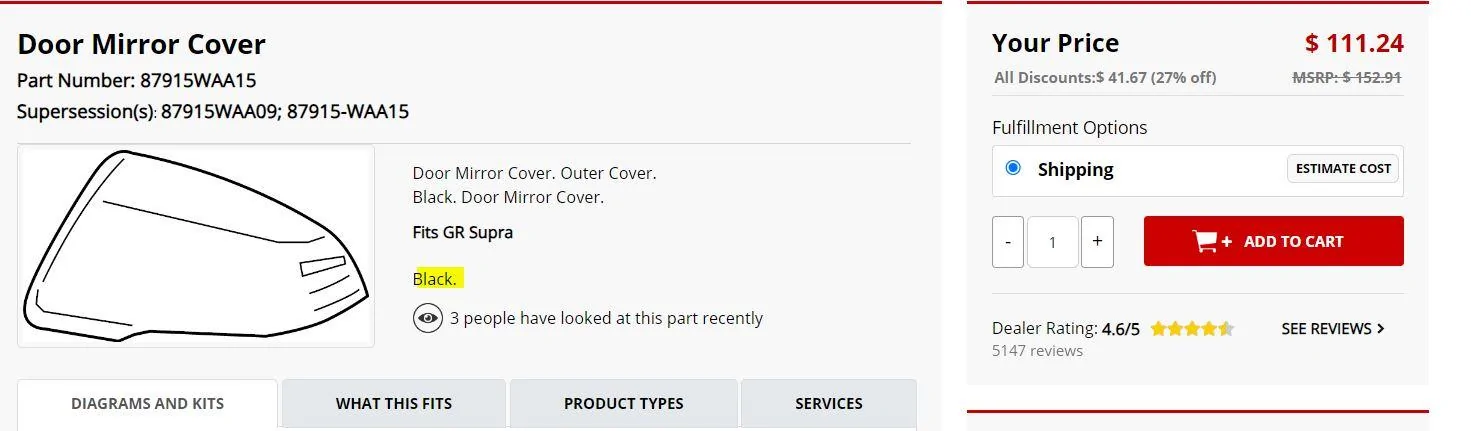

Thanks for the information regarding that part number, not seen those numbers before. However, I would disagree with you, Toyota dealer were wrong! I also didn't say I was buying in the UK.
This is their website and email confirmation.
Part number you provided is black.

I'm also seeing 87945-WAA15 for red
https://parts.elmhursttoyota.com/oe...lease-series-red-left-mirror-cover-87945waa15

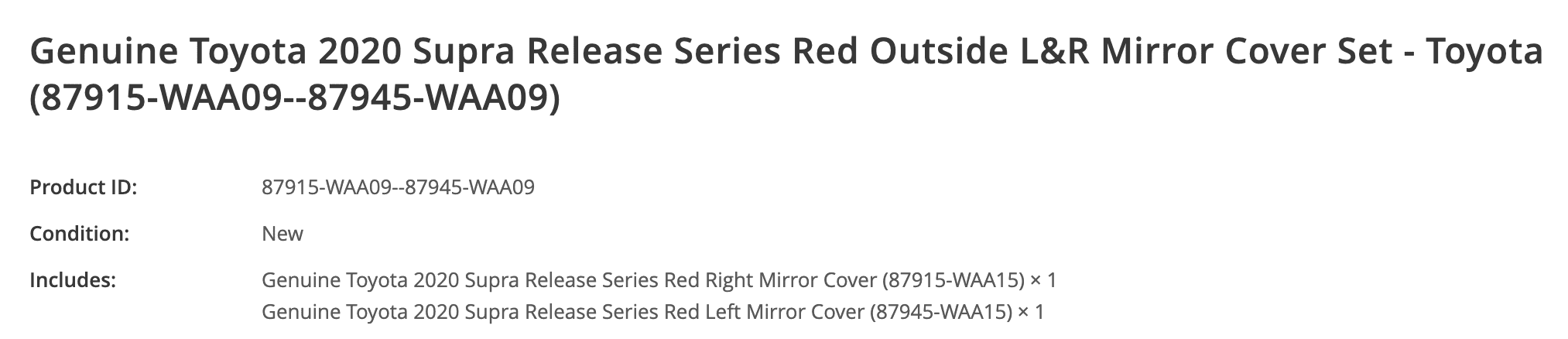

and WAA09 for red as well. lol
https://parts.elmhursttoyota.com/p-...ide-l-r-mirror-cover-set-87915waa0987945waa09
but then contradicts itself later in the listing:
However, this thread confirms WAA15 as red:
https://www.supramkv.com/threads/oe...ack-for-all-you-renaissance-red-supras.15852/
