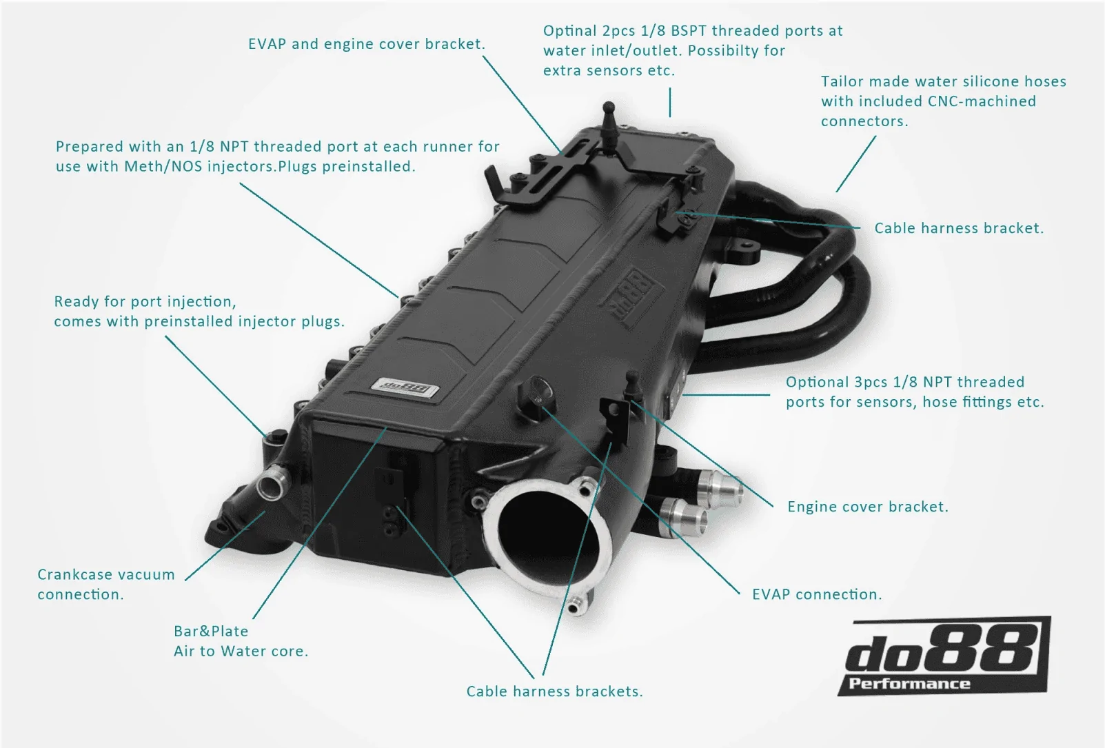

Checked do88's website and apparently, they removed their intake manifold utilizing the Garret bar & plate core.
I presume that the cost vs cooling efficiency compared to the initial core they used was not cost effective for the extra price of the Garrett core, or perhaps they are tweaking the end tanks in order for the core to have better cooling properties.
That is my thought. I might be mistaken, but time will tell.
it’s releasing in March.
