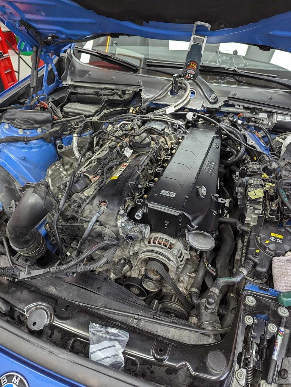

Standard version fitted to this M140i. Tested at the track today, the highest IAT we saw after a 20 min session with several laps of hard driving, was 112F/44C.
Car is running a MHD Stage 2+ multimap with E40.
8,823
17,311

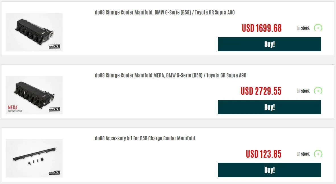

I really want to know if the MERA version using the garrett core is worth the extra 1k over the standard. On their website they have the exact same specs/features with the only difference is they state the MERA supposedly cooled 3C (37.4F) better than the standard
This is the comparison i did from their graphs:
23c = 73.4f (mera)
26c = 78.8f (standard)
~5.4f difference between the peaks.
To me, it wasn't worth $1k for ~5.4f difference.
