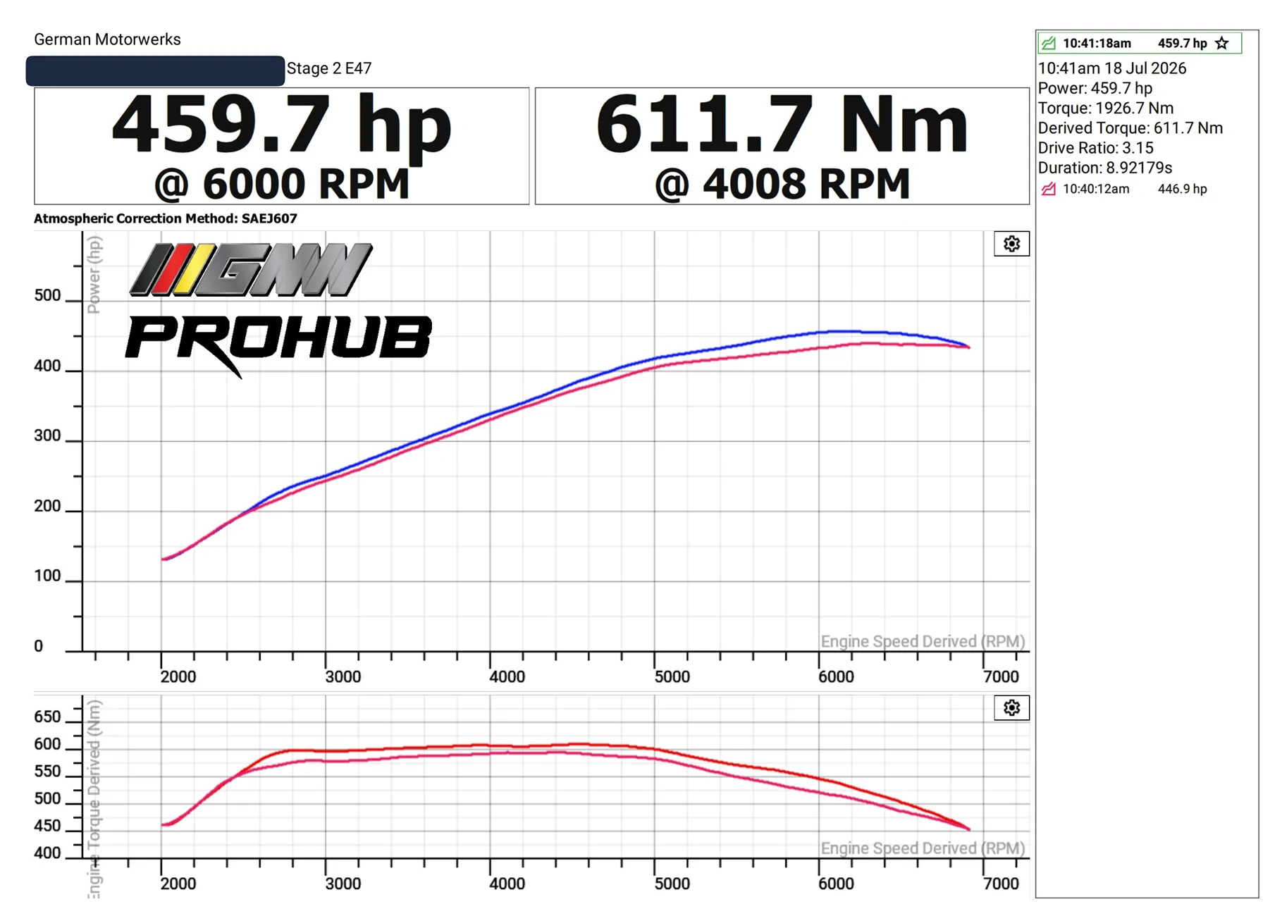

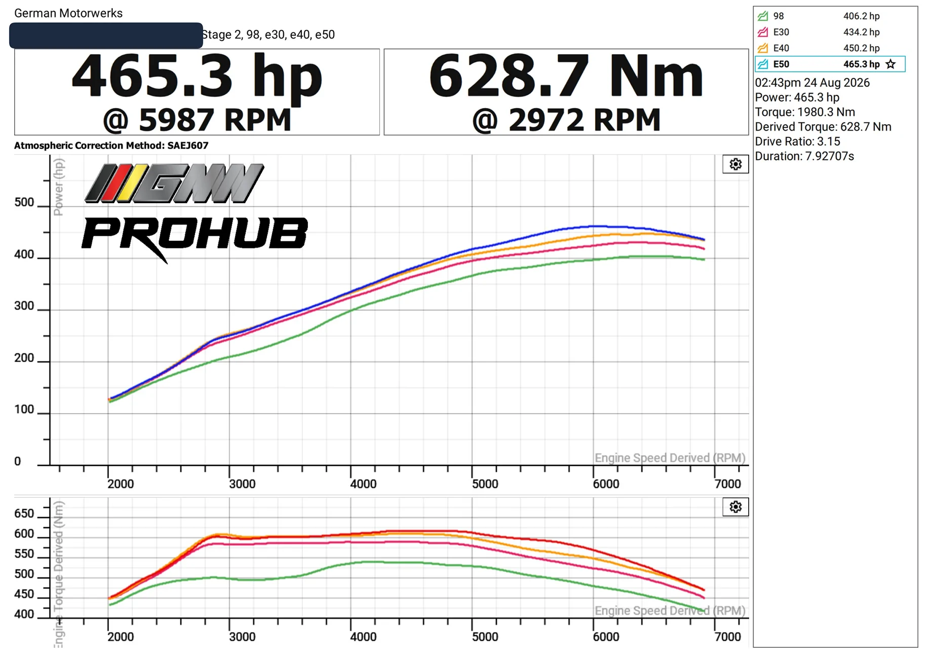

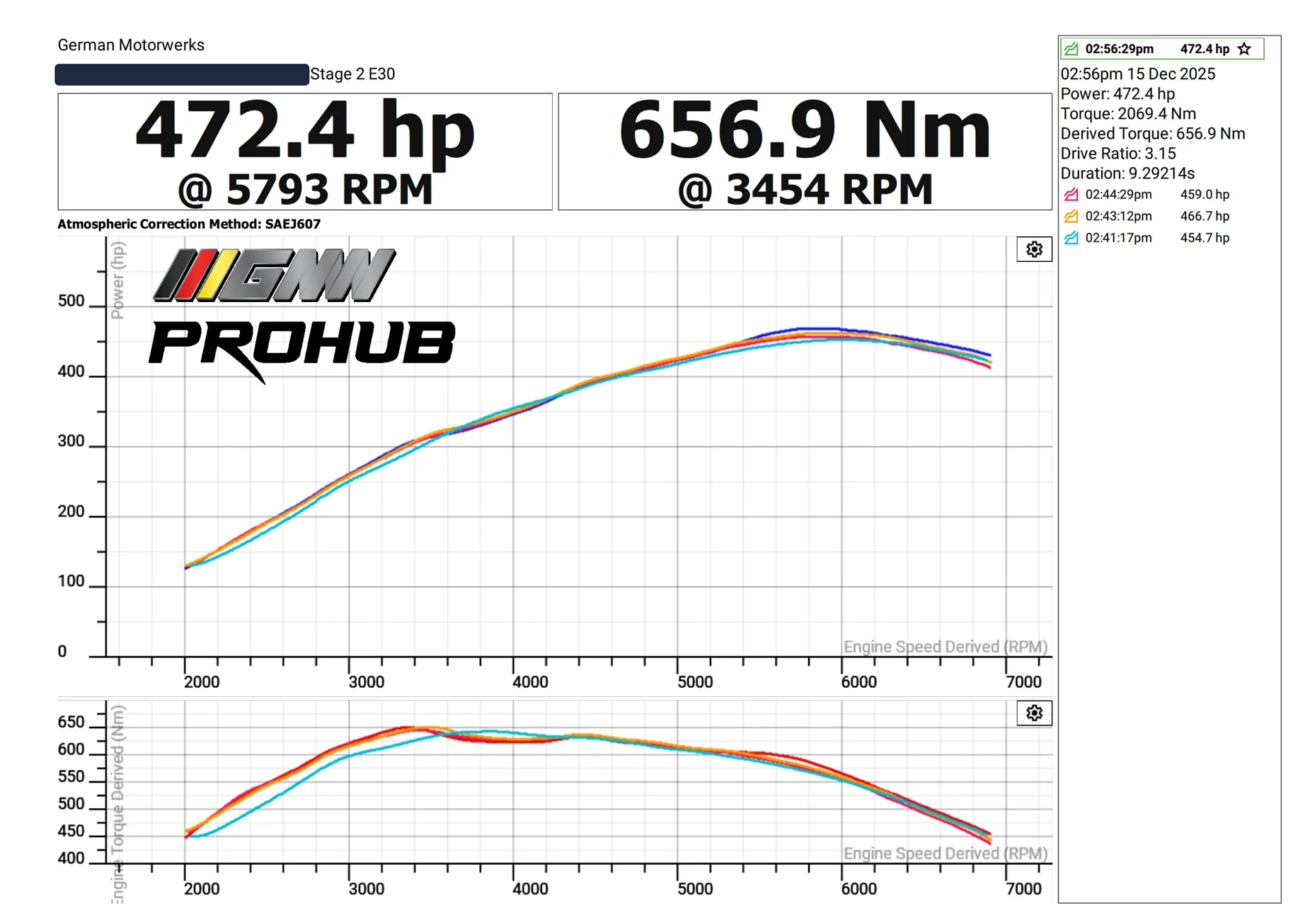

Great that it worked out for you. The accelerator pedal sensitivity has remain the same for me.
I'm going to get my car re-dynoed later next week, running a ~E30 flex fuel tune. I will post back the results and see if my performance has been impacted. There's a lag or something I can't put my finger on it yet.
Yup, I have experience lag and the OTS tune (93 Stage 2) doesn't run as smooth as it did before. My car exhaust volume also increased a notch or two. I've done multiple pulls and runs with my friends behind me and they also noticed it too. Let us know if you experience the same issues after your dyno day.
