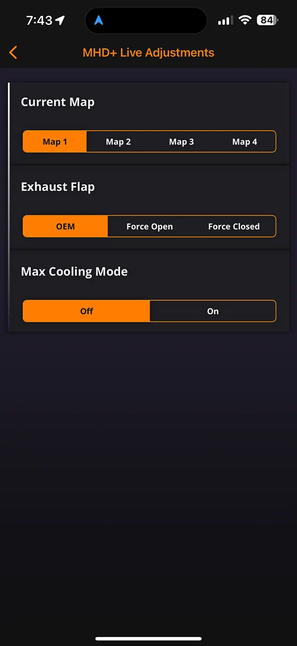

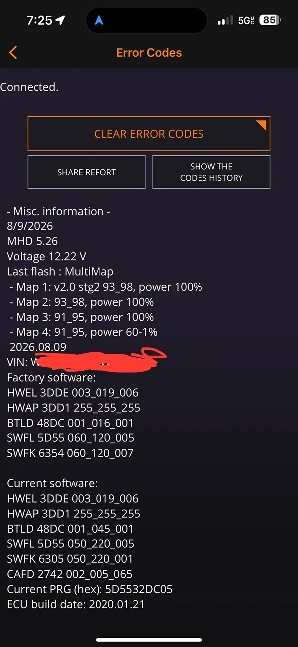

@WaveZero MHD got back to me and I was able to flash MHD+ back into my car.
If your car is on software ROM version 5D 55 32 DC 05 (5D 55 050 220 005), in the MHD flash options, go down to the bottom in the "force software field" paste or enter this value 0000630532DC and reflash. If the intial reflash fails, disconnect from your wifi dongle, and restart the app and redo the reflash process again (it happened to me)
If your car is on software ROM version 5D 55 050 230 005, same steps as above but enter this value 0000630532DC01
MHD also mention you should switch to 5D 55 050 220 005 software instead of 230 because MHD+ functions will be available with the 220 version.
After two weeks of testing involving multiple restore from my backups and reflashing on MHD+ - safe to say if you're tuned it isn't worth it. The car will run funny with MHD+ OTS tune with this remote start coding and the car's exhaust note is louder than normal.
If you're on MHD+ the only way to close the exhaust valve is to use your BC Button to go through your MHD+ menu to force it close as OEM option doesn't work. This can get quite annoying overtime.

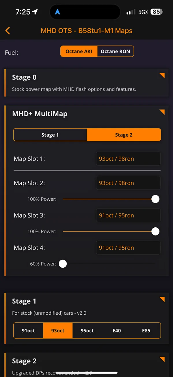

Thanks for this. I used code 0000630532DC01, and it appeared to let me install MHD+ and get my ECA flex fuel working again. It downgraded my software to 220 version.
Exhaust valves are still weird, but it seems to be half-working between Sport and Comfort modes on the OEM setting and it isn't always stuck in open. I will need to play around a bit more to confirm.
Also, I'm not sure if the MHD OTS tune performance is any different with this remote start flash, but the performance is still there. However, I think if I'm not imagining things, it changed my accelerator pedal sensitivity. That might explain why it feels different. Can @ky.supra confirm or something?

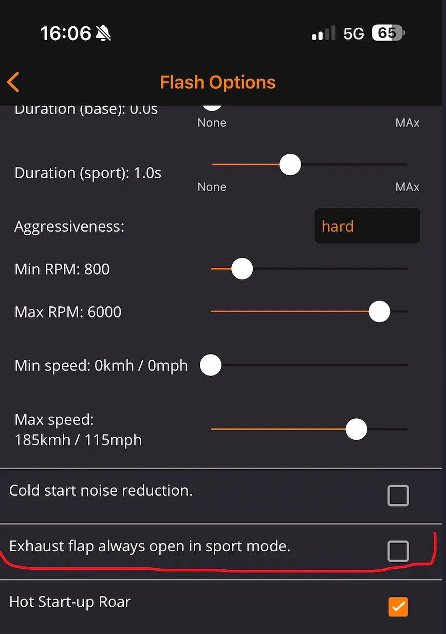

On a separate note, I’ve been playing around with my MHD+ OTS flex fuel tune.
I think I’ve managed to get the exhaust flaps working more reliably in Comfort mode now. It definitely actuates properly.
Try disabling “Exhaust flap always open in Sport mode” that seems to have fixed the weird exhaust flap behaviour I was seeing.

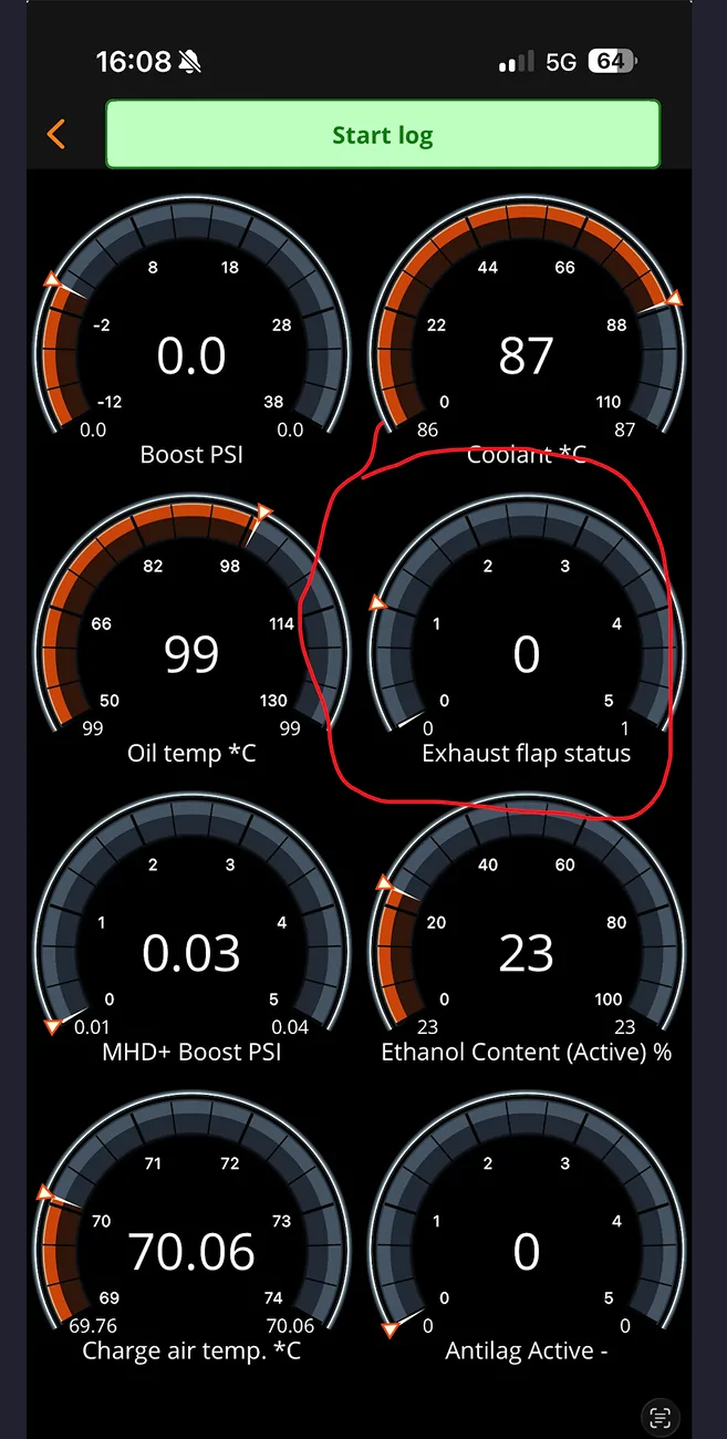

You can also confirm whether the DME is opening or closing the exhaust flap using the MHD gauges. From what I can see:
0 = open
1 = closed
0 = open
1 = closed
I've tried that - doesn't work on USA spec Supra's
