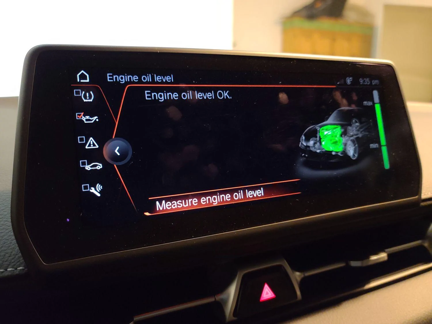

Well, my lower performance engine puts 500 whp since 1300 miles and yet 0 oil consumption (now 6400, changed the oil at 4300).
Whatever, I don't care, I am just pointing out that the 2020 and even tuned 2020 doesn't have this "not a problem" thing of "normal oil consumption", that's all.
The oil level on my low performance car:

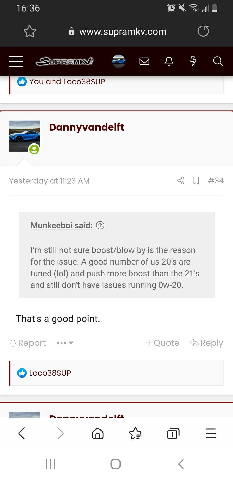

You obviously missed this post, if only you read a little further ahead. Or, maybe ignored it on purpose?

His main point was already made by someone else, and I acknowledged that was indeed a good point. So his post was useless.
I've also acknowledged that some have a genuine problem. My car is fine however. So I don't need you to be there for me, but I appreciate it :grouphug:
