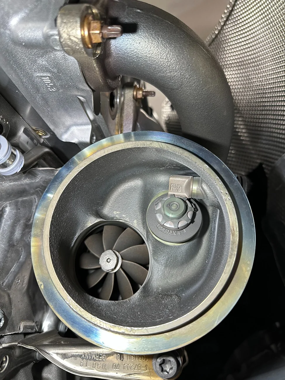

IF my turbo is the cause of the coolant and oil consumption issue I have, how do I diagnose this? Would it be obvious if I were to take it off? What should I be looking for?

I guess you could remove the downpipe and check the exhaust housing if there is some wetness or / and an oil film.
This.
Normal should look like this:
