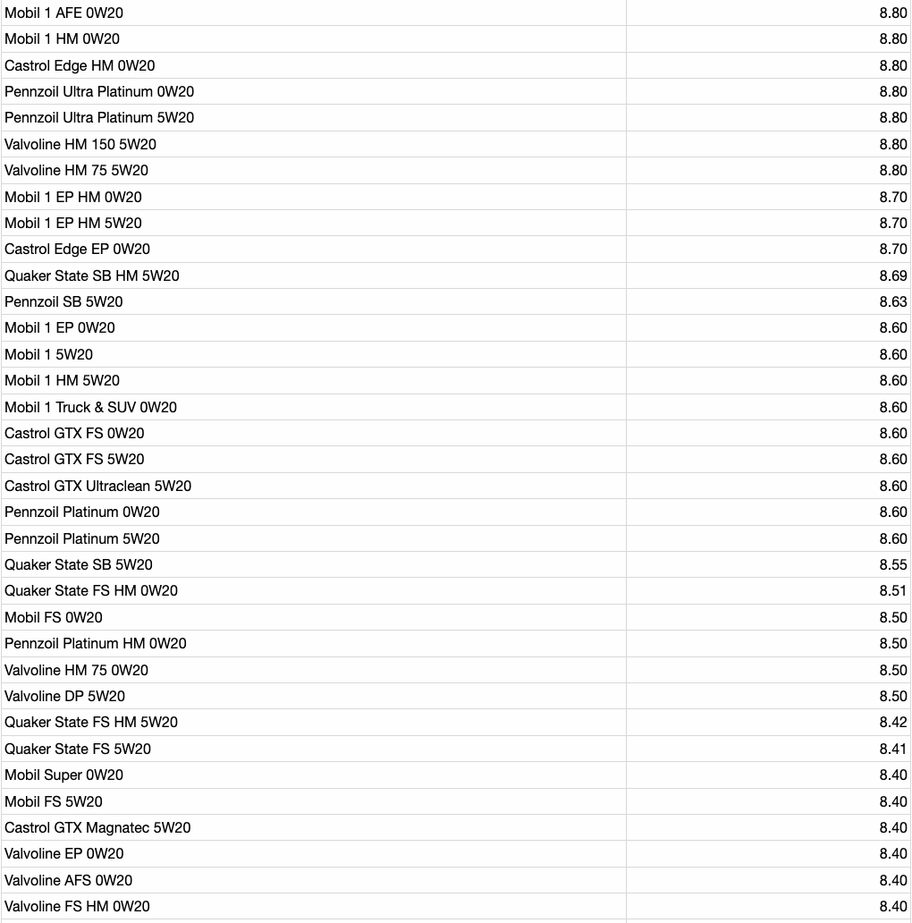

One oil brand of the same labelled viscosity can be thicker or thinner than the other. Like most labels viscosity identifiers have a range. So one 0W-20 brand can have a higher or lower upper 20 viscosity than another and almost always do although both are still in the same 20 weight viscosity range. If you look at the actual measured viscosity at 100C for any oil in the same indicated viscosity you'll often find they are slightly different. Some can actually be bordering on the threshold of the next higher or lower viscosity range and if compared to another oil at the opposite end of the range spread the difference can be noteworthy. If you are interested in that sort of detail that is.
You guys are getting WAYYYYYYYYYYY too pedantic. You guys really do yell at clouds.
We are talking very slight point differences here.
Here are six different 0W-20 oils and their viscosity measured at 100c:
Here are a bunch more:

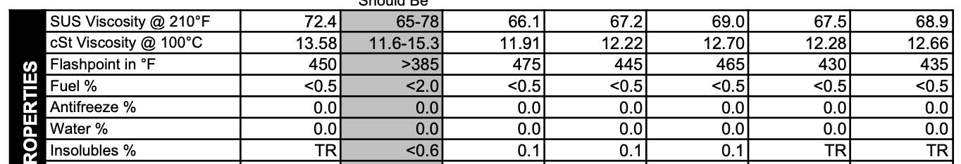

Here is Motul 8100 X-Cess 5w40 that I have run since I bought my Supra. Each test has about 4-5 track days on it. 50+ track days across all these samples.
I share this ACTUAL REAL WORLD data because we don't just fill our cars with oil and never run the engine while standing around yelling at clouds.
