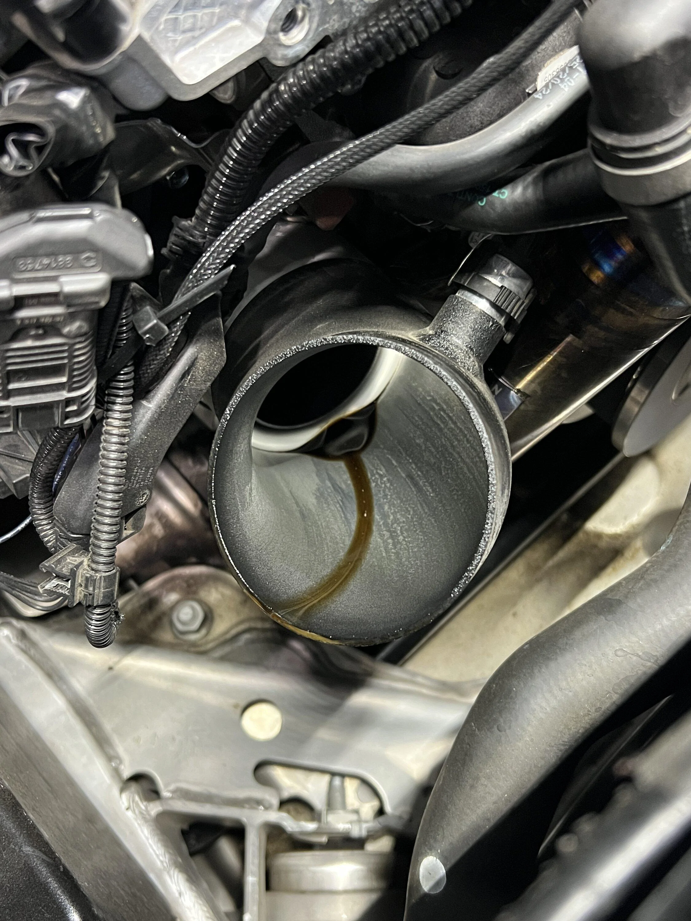

Hey all, I know I have seen this prior. Is this normal? What is the cause and how do we stop it if possible?

Will a catch can solve this? I haven’t seen many with one.

Looks like the Versus AOS kit and their drain line will sort this.

That's a lot of oil to have in your intake. When was the last time you cracked the intake system open?

You need dual catch can to solve this. Oil can contaminate from PCV and CCV on the Supra (like most other cars).
I ordered the VERSUS today with the return line. Are you suggesting else as well?

You also need a crank vent (CCV) solution.

Catch cans don’t catch anything.
the b58 always eats a little oil through intake
vent crankcase does more good
Verus kit I've had on my car has caught squat. BUT, the motor has 7k miles on it. I'm interested to see how much of an issue, if any, blowby will become as these motors pile on the miles. The Verus AOS is coming off for an aftermarket intake this winter.
I already have it ordered as well as the return line which is also a vent.
