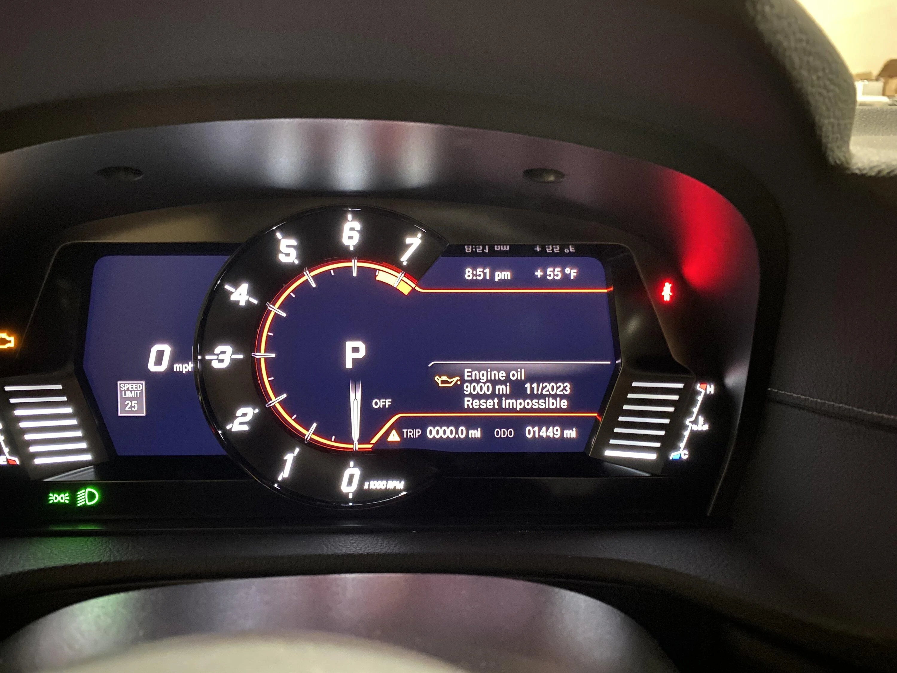

Oil maintenance reset light “Impossible”

So I was told by a Toyota Supra tech that either I need to get them to reset it at Toyota with their scan tool or get to around 40% of the 10k miles interval before I can reset it myself with the dash board button. Lol Who knows!!

Found this, might work.
Nope, tried that. Lol I wish.
There is really only three options to turn off the oil reset light if you haven’t reached a percentage of your miles service interval. 1. Reset the year to trick the car into thinking it’s not due yet. 2. Have a Toyota scan tool to reset it. 3. Reach a certain % of the miles interval and the oil maintenance reset will be possible.
