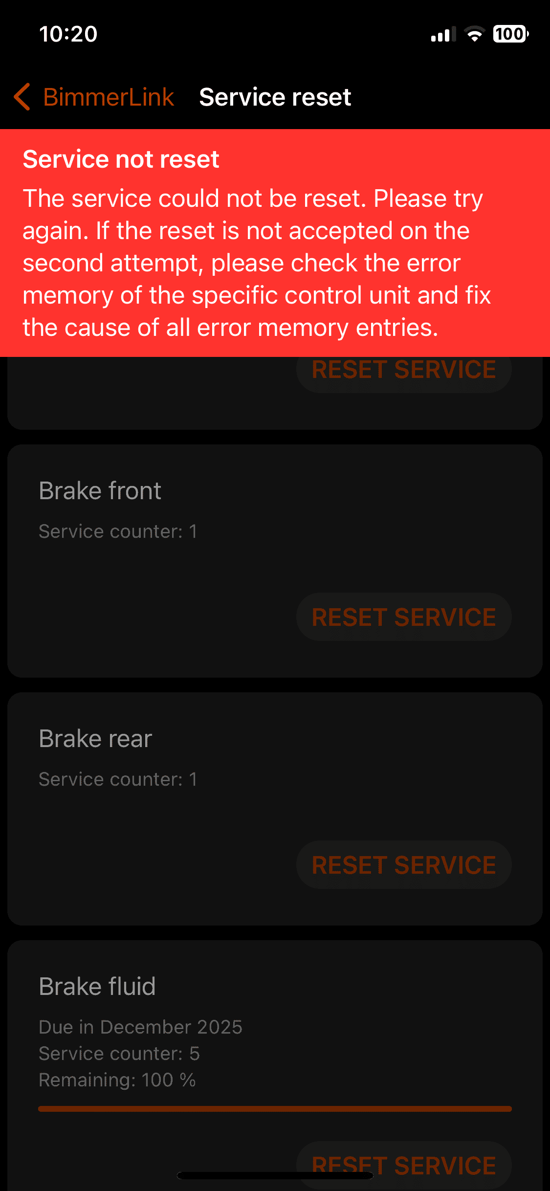

Actually it’s tricky bc it made me clear out some temporary error messages first before it would alllow me to do it….
It will tell you tho.
I posted the error message below if you don’t clear out some of the messsages..

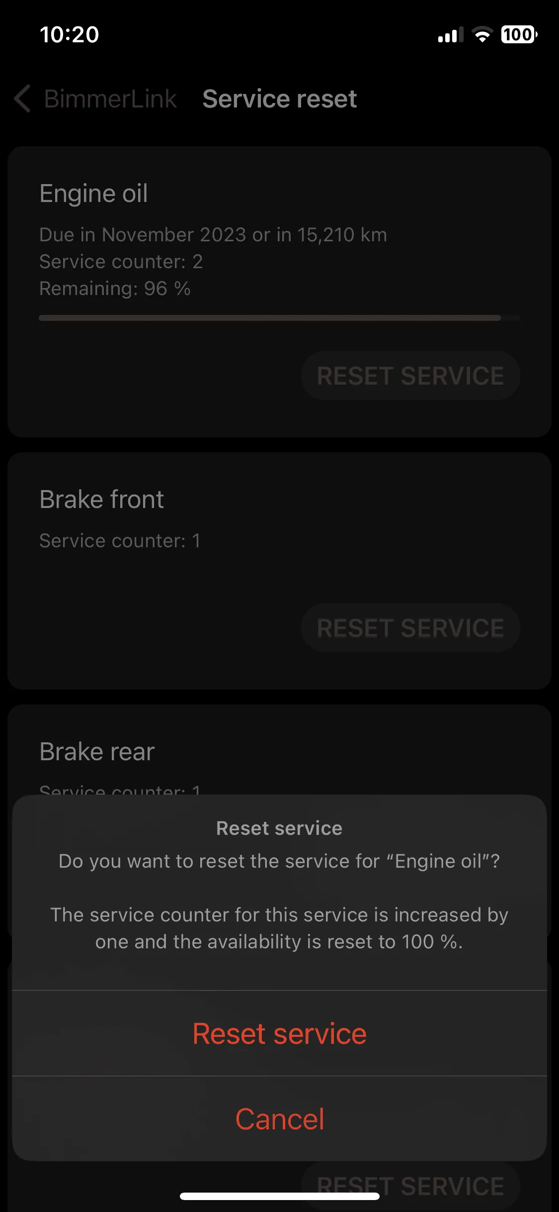

I can confirm that draining the oil has nothing to do with the “reset oil” maintenance issue. I am just shy of 500 miles and did an oil change. And it’s still “impossible” to reset the oil change.
I’ve read on here I need to get the bimmerlink app on ios in order to reset it? is that correct? I have jb4. I was hoping I could do it on there somehow.
Anyways, is bimmerlink app my only option?

There may be other ways but BimmerLink is the easiest/simplest method.

you can go to Toyota and have them reset with their scan tool, buy your own super expensive scan tool, wait for time/miles, or reset the date to a year back…

Yea umm I like to avoid the stealership at all costs other than to buy the damn car lmao. And I think I will just do the whole bimmerlink thing. Looks like it can be useful anyway.
