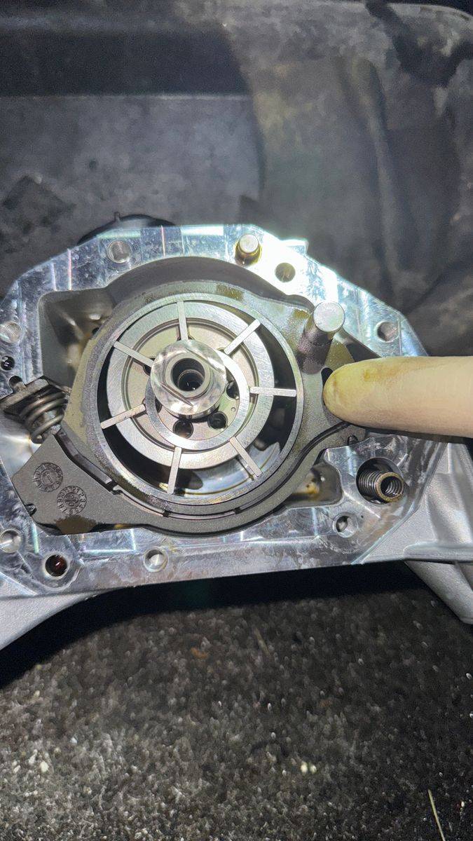

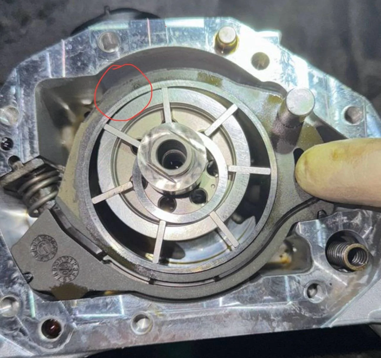

UPDATE: Old oil pump has been taken out. Supra build date was 7/20. Picture attached under.
Was replaced with the new part number for the oil pump. I ordered an updated BMW Z4 oil pump since it was like almost $1000 cheaper.
I can now measure my oil to the max and it no longer stops at 18%. Max PSI I have seen during WOT as of now has been 85psi.
+1 to the Oil Pump TSB!

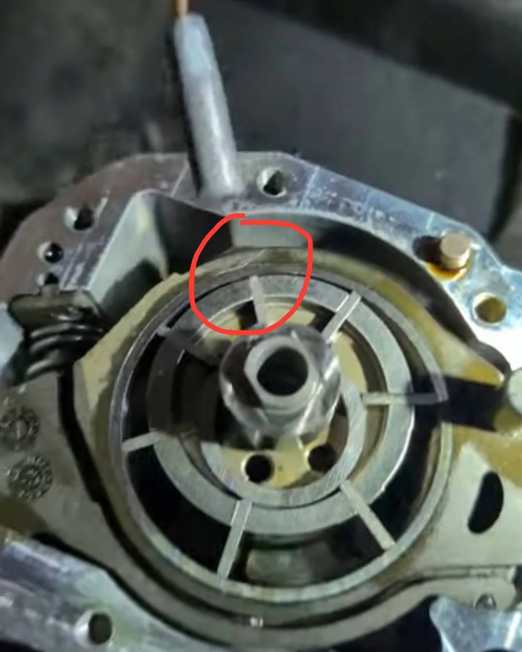

Nice! Am I blind though, I don't see any damage to that pump?
No you're not blind lol. I don't see any damage either. I am assuming it's on the other side as I've seen in a video. I will ask the shop if they still have it and can take out the piece.
