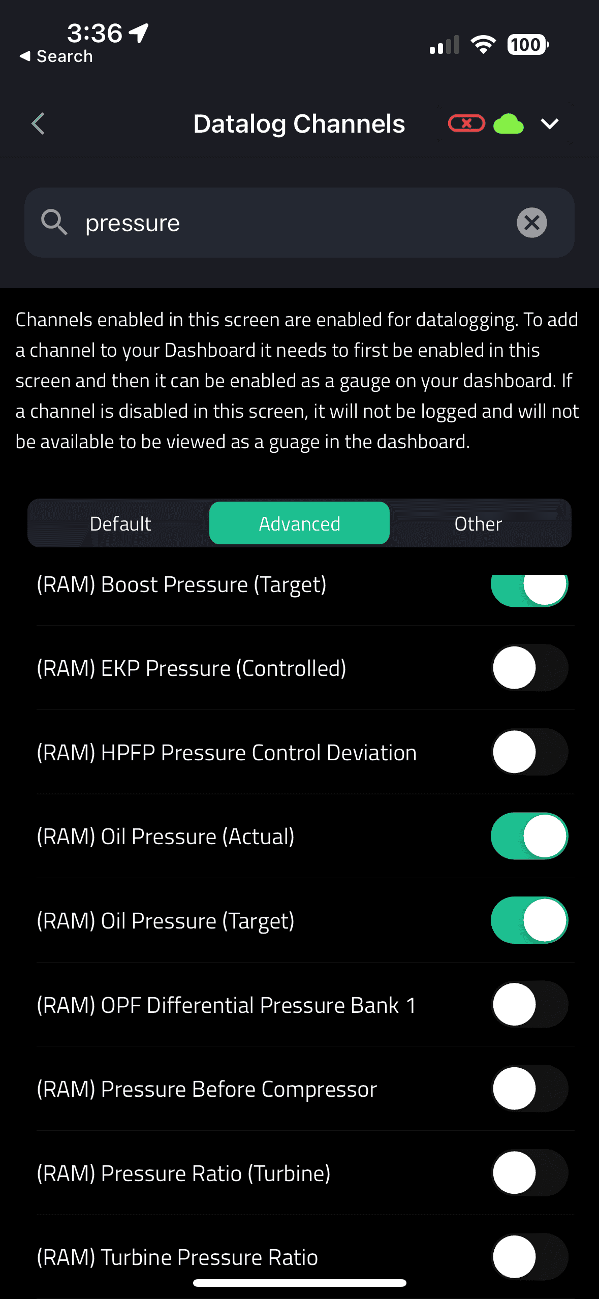

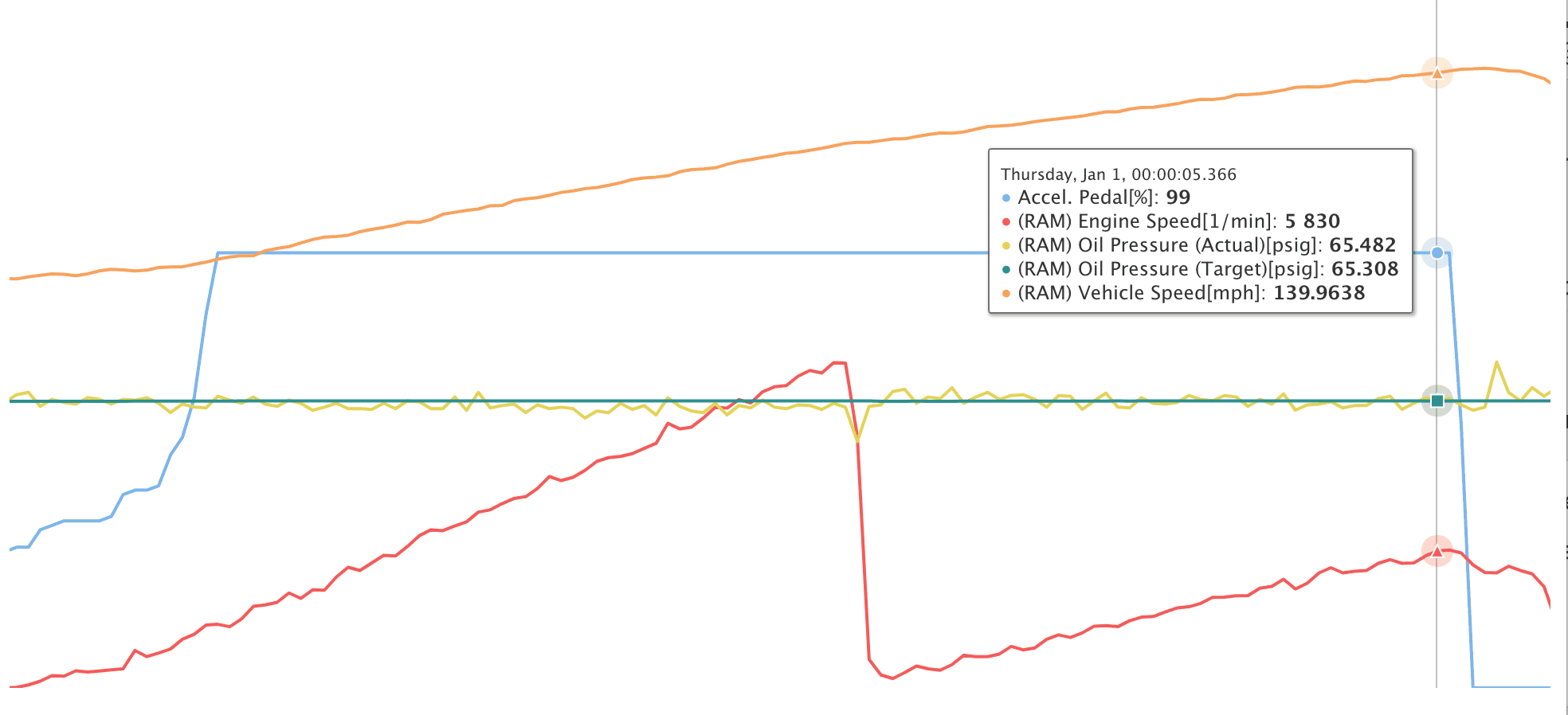

Yup, I've been logging oil pressure target and actual all last year via BM3 app.
