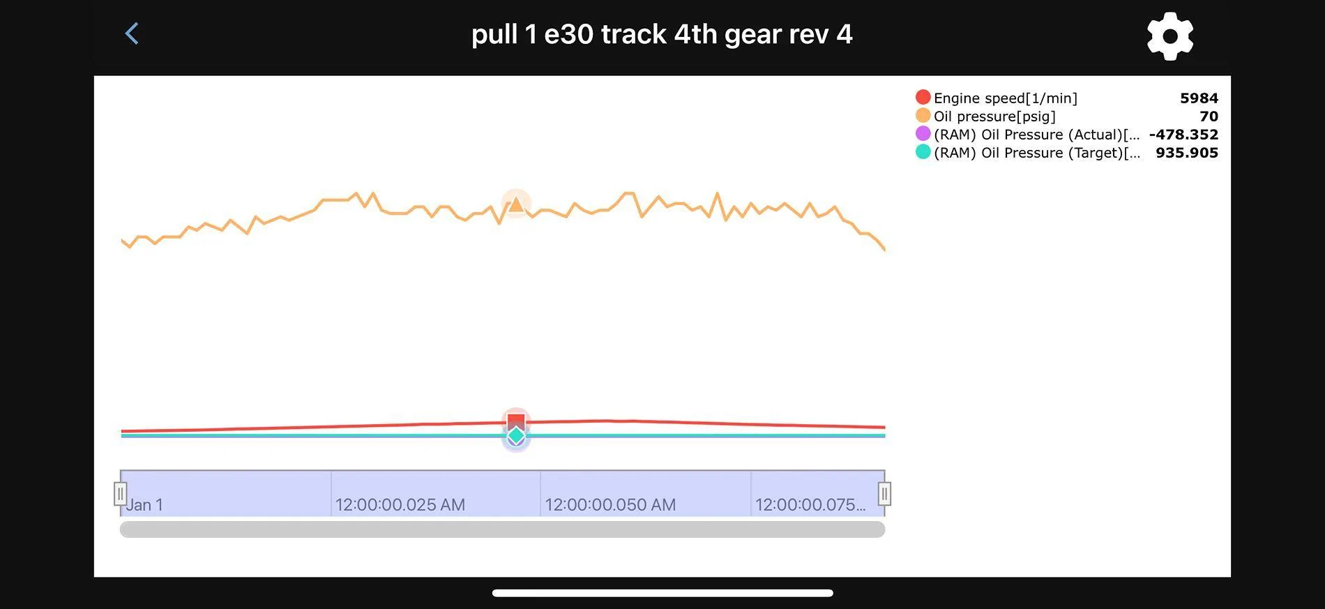

Yeah I get some weird stuff in bm3 as well using the RAM channel.
this thread was very helpful, as my tuner had to adjust oil pressure for the VANOS exhaust target, and I didn’t have a baseline.
Yea the oil pressure RAM channels have been broken in BM3 for awhile. They did tell me earlier this week they did a huge update to logging items. Have you tried updating and logging this week?

I noticed the app update and the fonts all different lol, but haven’t logged yet. I’ve had issues in prior versions logging PSIG vs PSIA and I needed to completely delete the app and reinstall.

The log shows 0 for setpoint oil pressure. As for the absolute pressure it's low 40ish psi at idle with ambient pressure around 13.7-13.8psi. Gives me the value around 28psi give or take. What should I make of this?

Also forgot to add, the car was at 112psi at 2.8k RPM with an ambient pressure of 13.51 while in sport mode too. So that leaves us with 98.49psi.
Not too bad, about 7psi over. This is with the car fully warmed up? Did you log oil temp too?

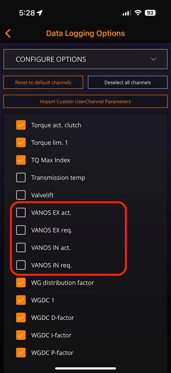

Vanos:

Did another log with those parameters on. It looks like both VANOS EX act. and VANOS IN act. stay together with VANOS EX req. and VANOS IN req. Is there a specific value I should be looking at or is that fine?
Rail pressure is already at 5000 by 1.4k RPMs too.
