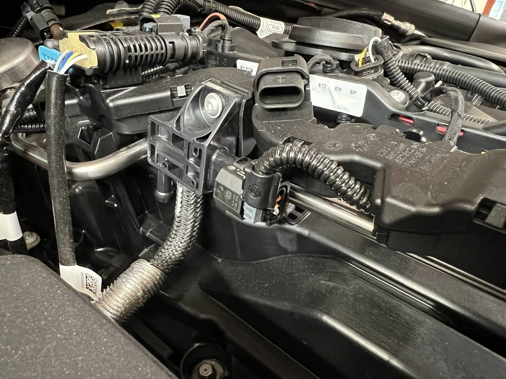

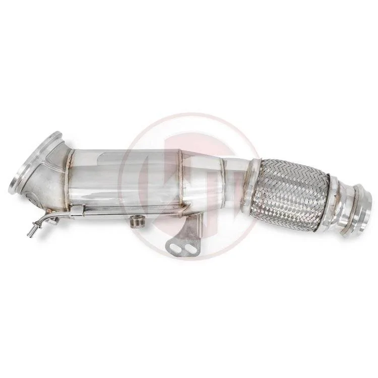

That's correct. We have an extra line right after the cat on the downpipe that connect's to a back pressure sensor located on the valve cover. Only found on EU and in some asian countries AFAIK.
so deleting everything after that line would not cause any CEL

Deleting the OPF normaly causes CEL, as the back pressure would be out of normal reading range.
It's easy to disable in MHD/BM3/Ecutek. But for people still running stock DME tune, a "OPF delete harness" is an option. It's basically just a small harness piece with a resistor to fool the sensor reading.
