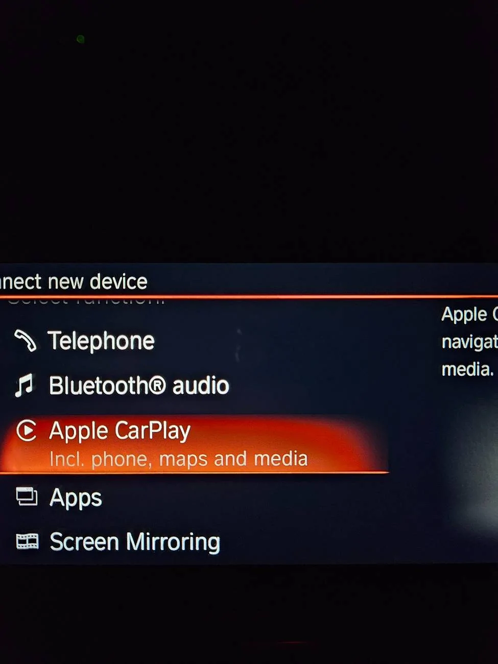

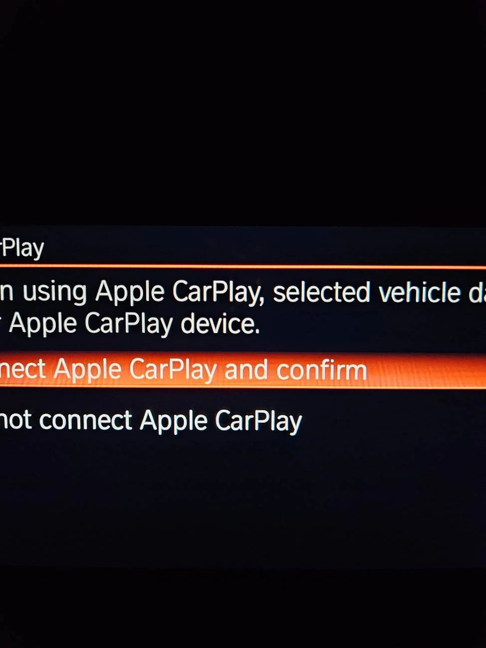

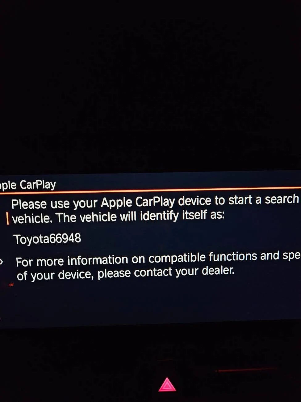

Bought another Ottocast i3 AI Box to try again. Having no luck in getting it to work.
Specifically:
2024 Supra Premium MT with JBL system.
Unpaired every other bluetooth device, including my iPhone used for Carplay.
Plugged in Ottocast i3 to USB.
Ottocast started to flash on and off.
Went to 'Connect to New Device' screen
Selected 'Apple Carplay' option
Next screen: Connect Carplay and confirm selected
Next screen: Use Carplay device to start a search for Carplay
Results: Nothing. Ottocast sits and blinks for a while and then goes to a steady blue light.
Seems like the system is waiting for a response from the Ottocast box, like when I pair my iPhone.
What am I doing wrong?
Thx

Not sure why it's not connecting for you unfortunately, worked for me first time with it being on the exact same screen as yours.
The ottocast unit has a blue steady light while connecting to the iDrive system, and just worked from there really ...
