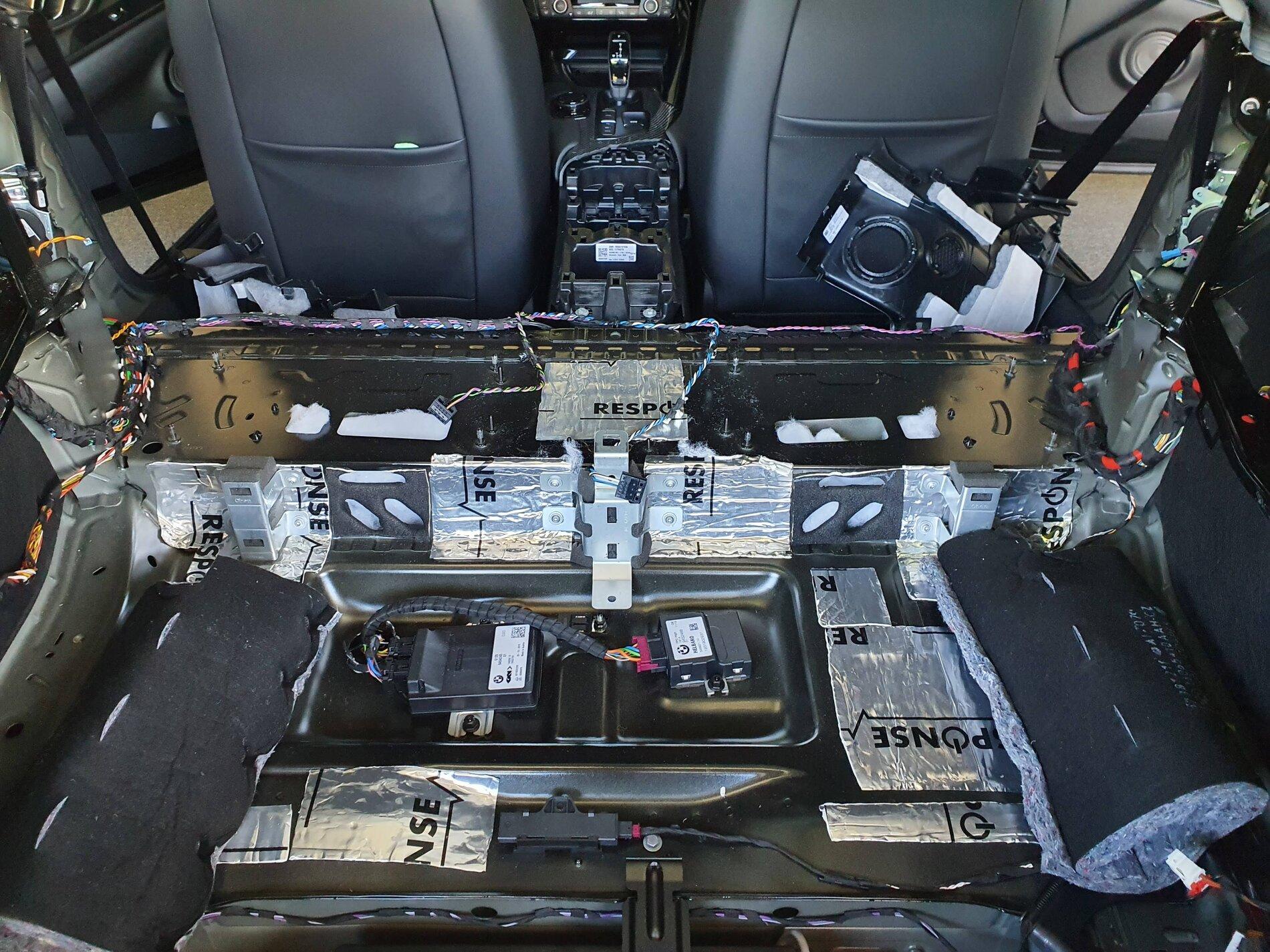

So far I have eliminated the rear rattles and squeaks in the Supra completely this is a big relief. I stripped everything I used rubber adhesive seals around the woofers so the sound projects out. I uses felt tape over the metal clips on carpeted speaker cover and panel. I used sound deadening on many surfaces including thick sound deadener under that carpeted plastic moulding.
Every Plastic panel has some sound deadener added to the underside and felt tape where it rests against another panel. The metal brackets beneath the plastic and carpeted panels in the trunk are flimsy so I stuck sound deadener on those brackets. I shoved sponge and speaker wadding into gaps in the rear fender to fill the cavities.
I filled the aluminium fake chassis brace with sponge to deaden it as it transmits noise like a speaker.
I placed sound deadener on the inside of my doors panel and some thicker sponge where the door lock mechanism goes through the hole as this is a source of a known rattle.
So the car is far better now. Its just the creaks from the centre console carbon fibre and front facia that needs to be sorted which I have not tackled yet.
With these rear rattles and creaks fixed the car feels like it rides smoother which is the placebo effect and my OCD.

I had a vibration sounded like suspension/spring loose. I watched a you tube clip that mentioned they placed rubber underneath the plastic panels underneath the under carriage the clip didn't point to where it was it was just mentioned it. I watched so many supra clips I don't recall which one it was. I put the car on ramps and got under there with sticky butyl rubberised foam deadening its about only about 3mm thick purchased at my local electronics store that I used in areas inside the car for sound deadening and stuck on the inside of all the plastic panels bolted onto the underneath of the car in various areas. Very random and didn't believe that it was going to fix my issue. Once I did this the noise magically disappeared.
Perhaps it wasnt the rubber but simply loosening the plastic lining and re-seating it that fixed it. I don't know. It similar to the panels in the rear of the car sometime they go on and creak like crazy and then you pull them off and re-seat them and they seem to be free of any noises.
Its tiring trying to sort all these issues out. Just trial and error keep at it until all the noises are gone. I have taken my car apart in the rear about 3 times. 3rd time I am more familiar with how to take it apart.
If I get a chance I will try crawl under there and take some shots and post it.
Almost gave up on this car but I am starting to properly enjoy it now.

This is the rear completely stripped with some sound deadening
Amazing! That is borderline pornograohic as I would kill to do this on mine!
The underpanels are my final hope. Are there tons of them to sort? My sound seems like itā€™s coming from up top directly above the strut towers-is that how yours was? It was a very high pitch/mid range harsh metallic vibration rattle

Sorry mine was more a knocking sound, sometimes a vibration like a spring vibration sound I couldn't tell if was coming from top I just knew it was somewhere from the front left shock.
There is a thread on a what appears to be the noise you may have that ended up being a plastic cover in the engine bay that needed a little bit of attention. I didnt have to touch that panel. Sorrry its somewhere in this forum myabe under recalls, tsm, etc.
You may have the same issue as mine but in a different spot. There aren't many panels just crawl under there and take a look.
By the way I am no mechanic or expert at this. I have very basic tools and not the best at using them. I always say if I can do this stuff anyone can.
