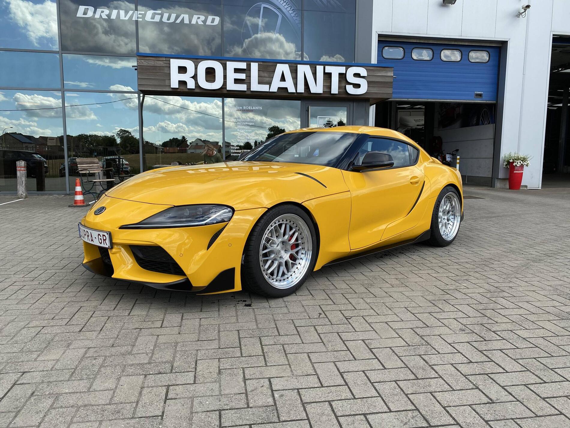

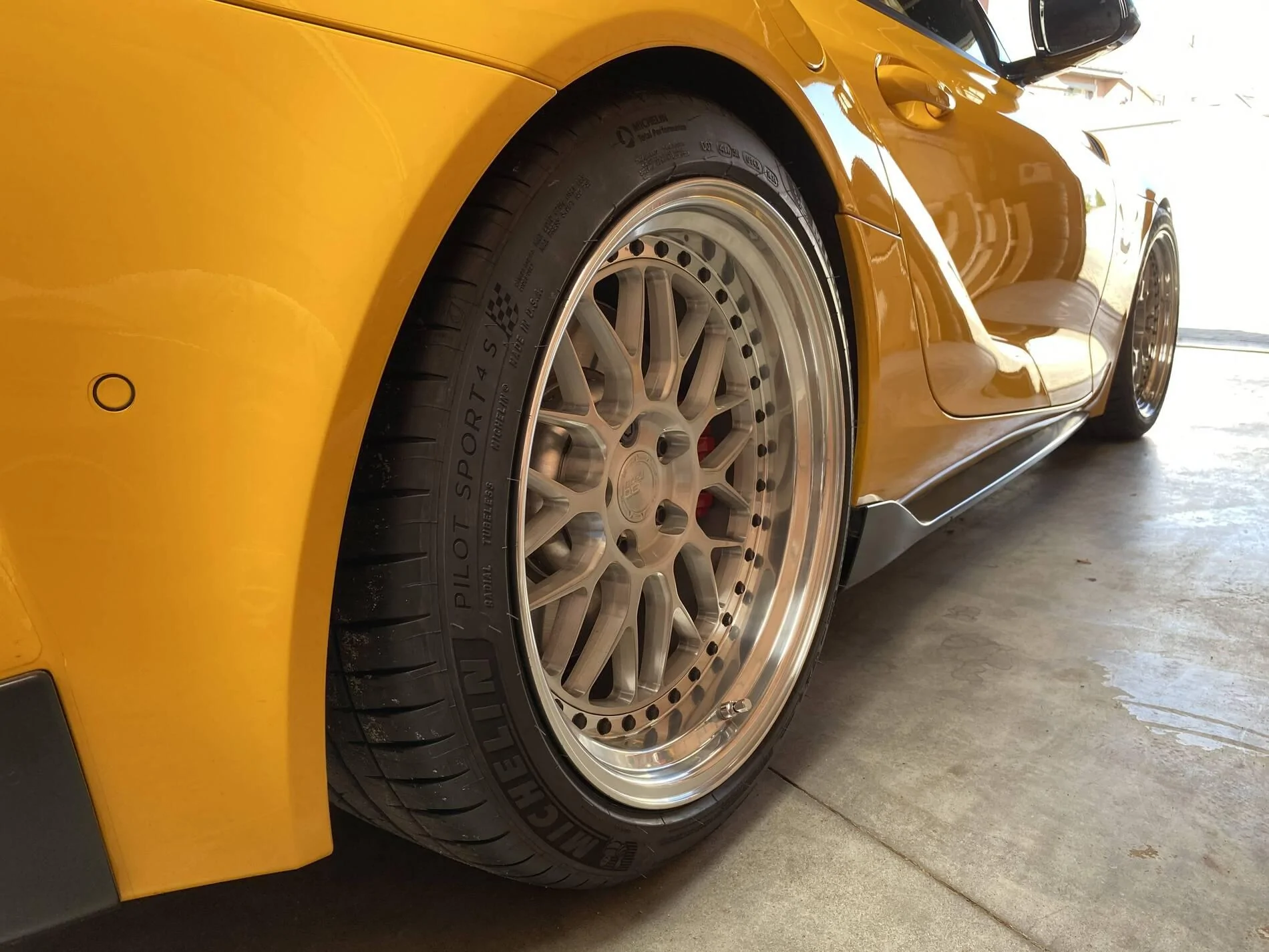

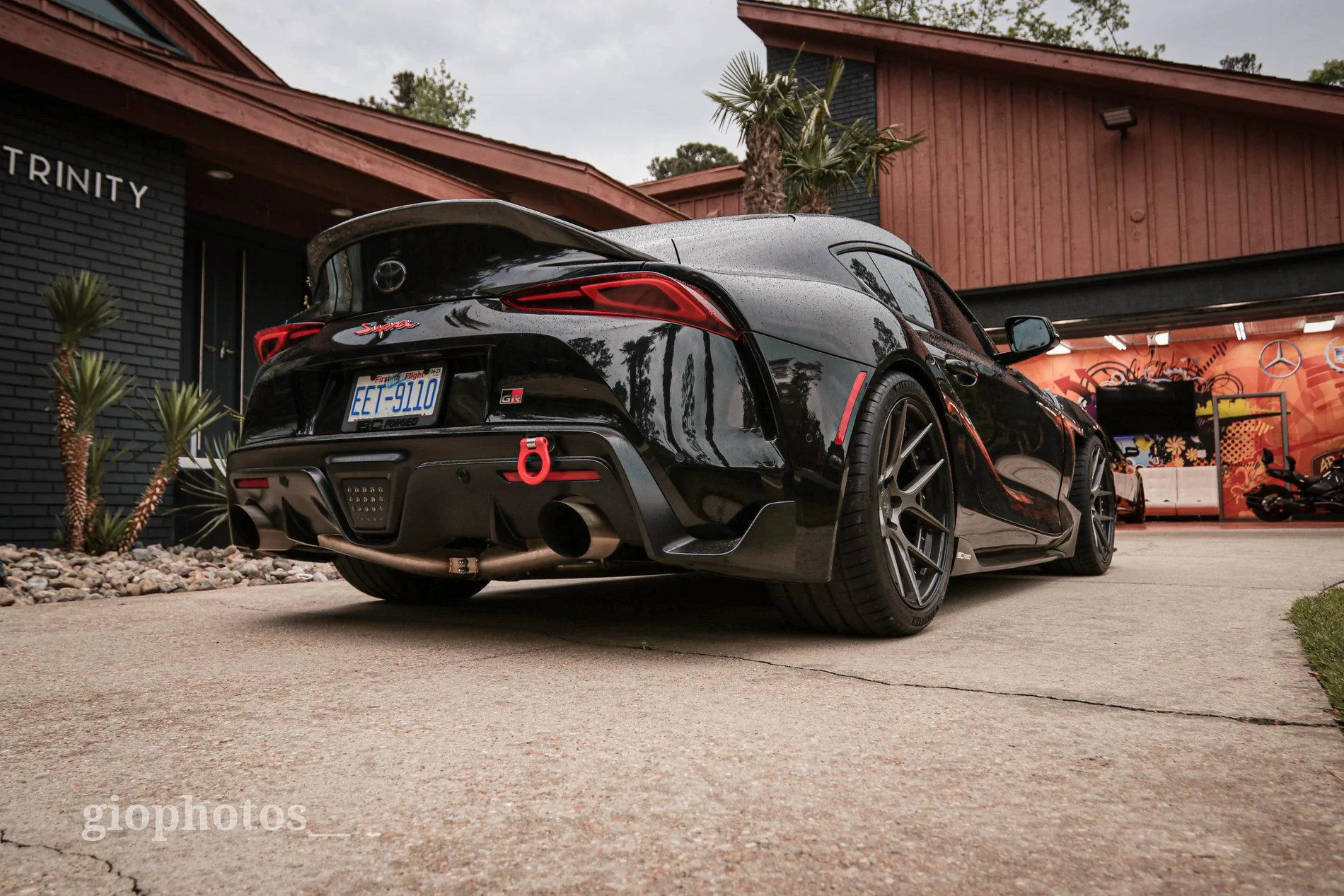

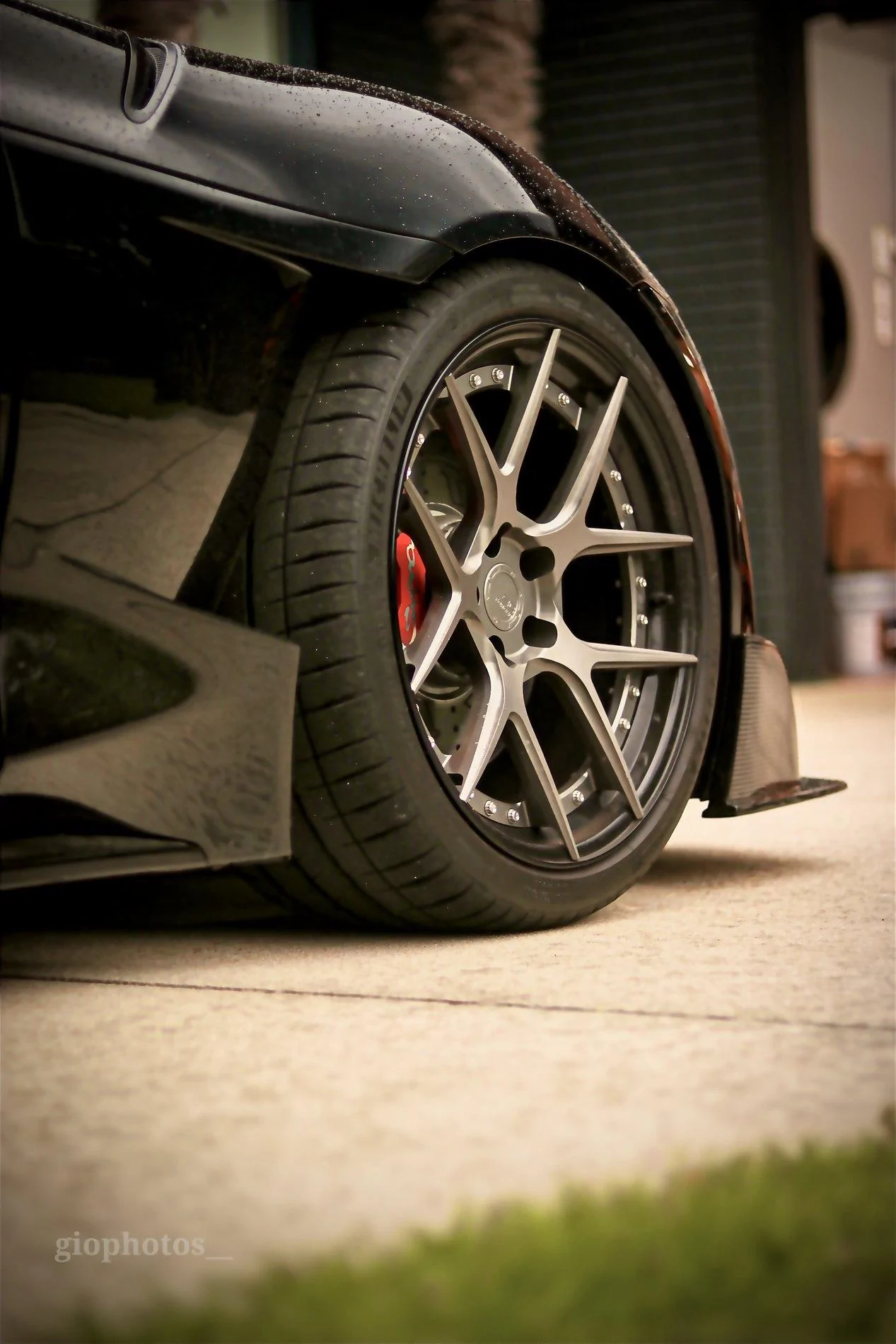

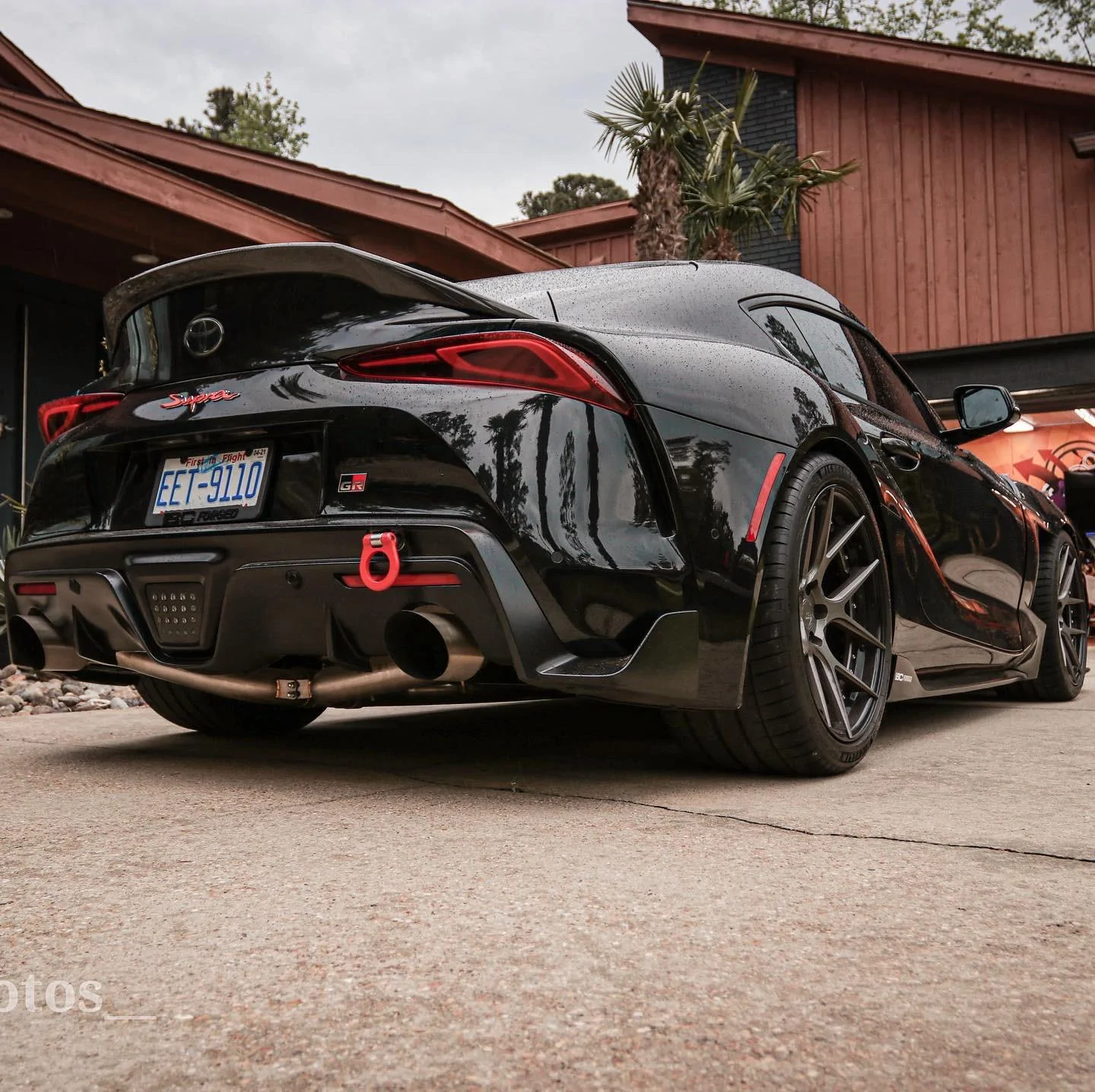

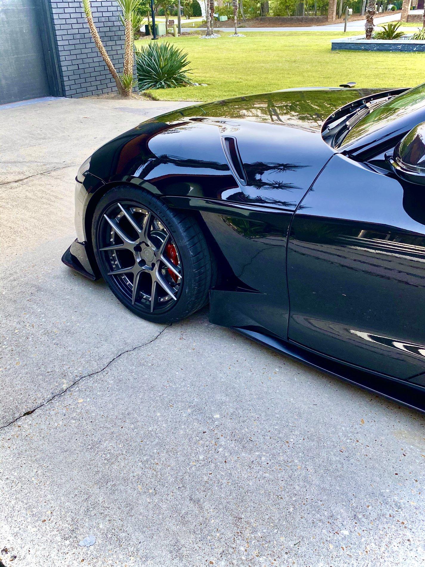

Today fitted my new wheels: BCforged MLE81 on Michelin Pilot sport 4s
  • 265/35/19 on the front
  • 285/35/19 on the back
Car is lowered on HKS springs

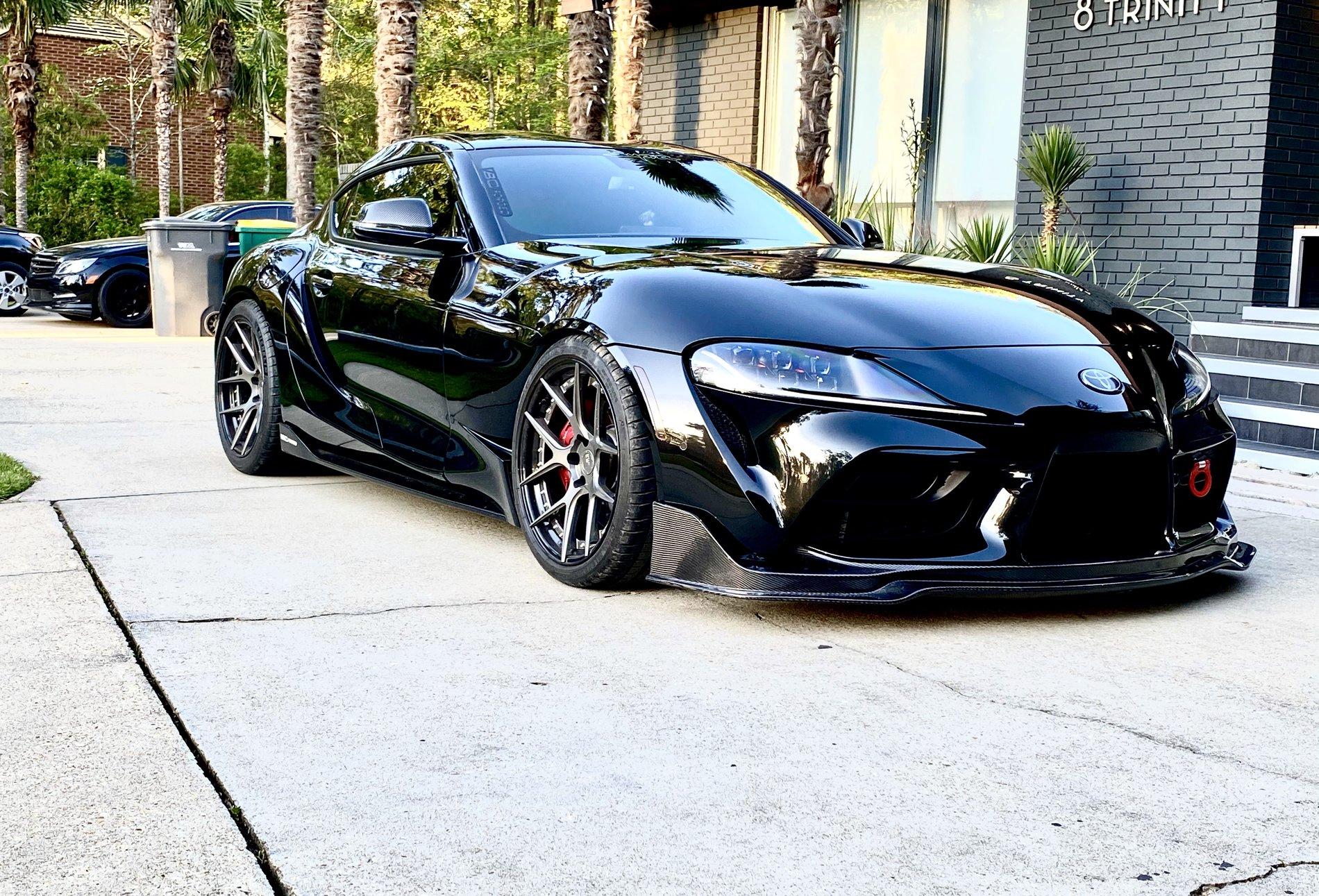

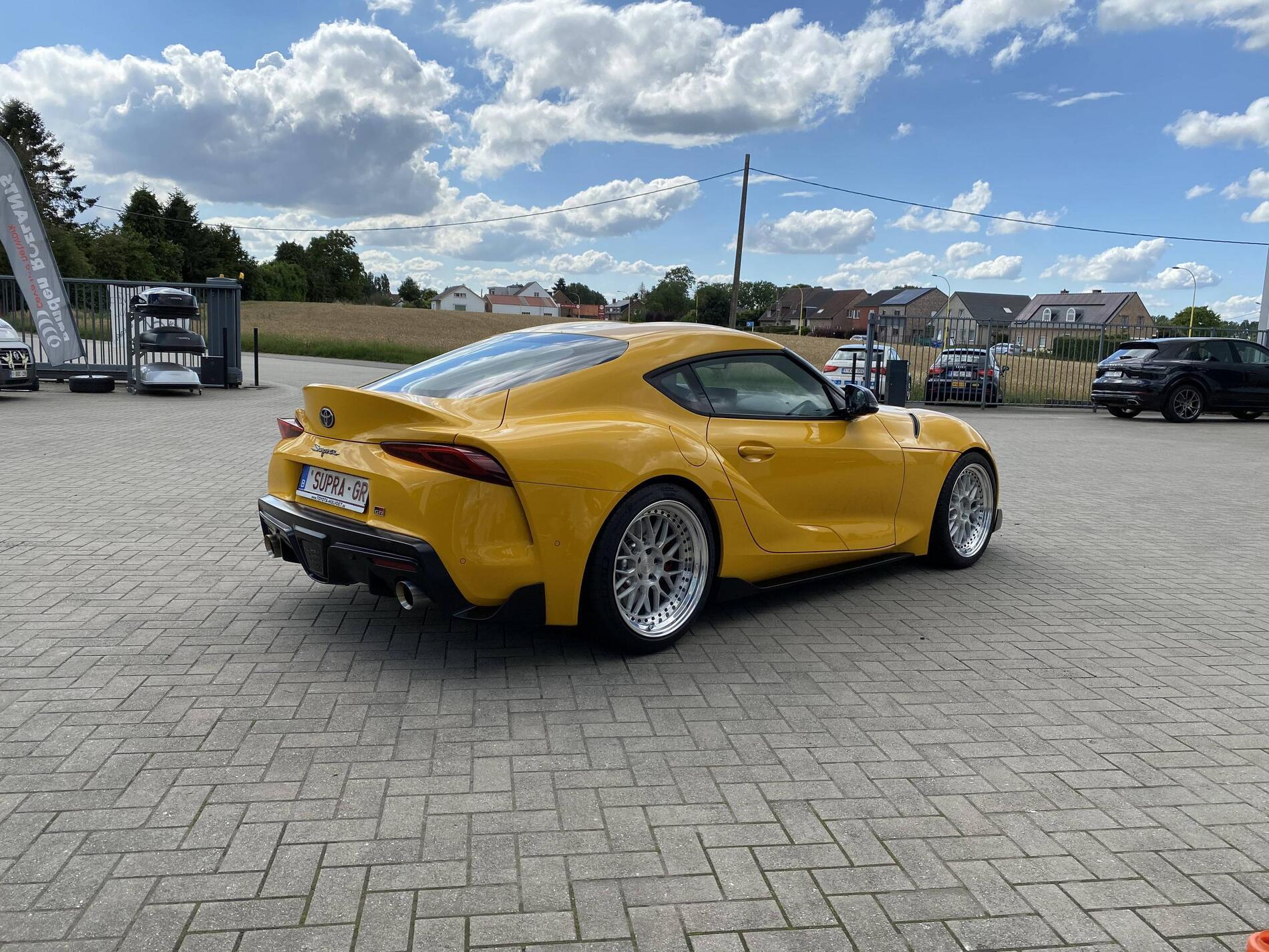

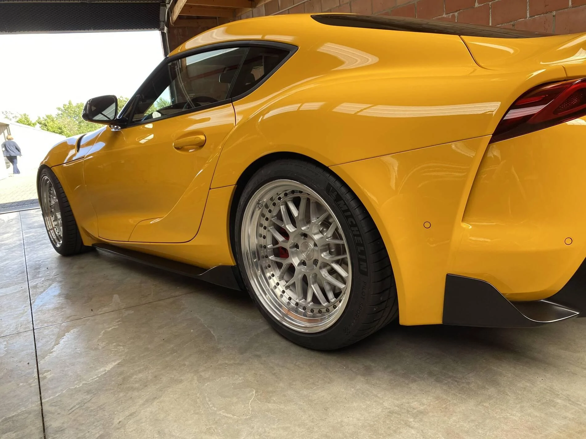

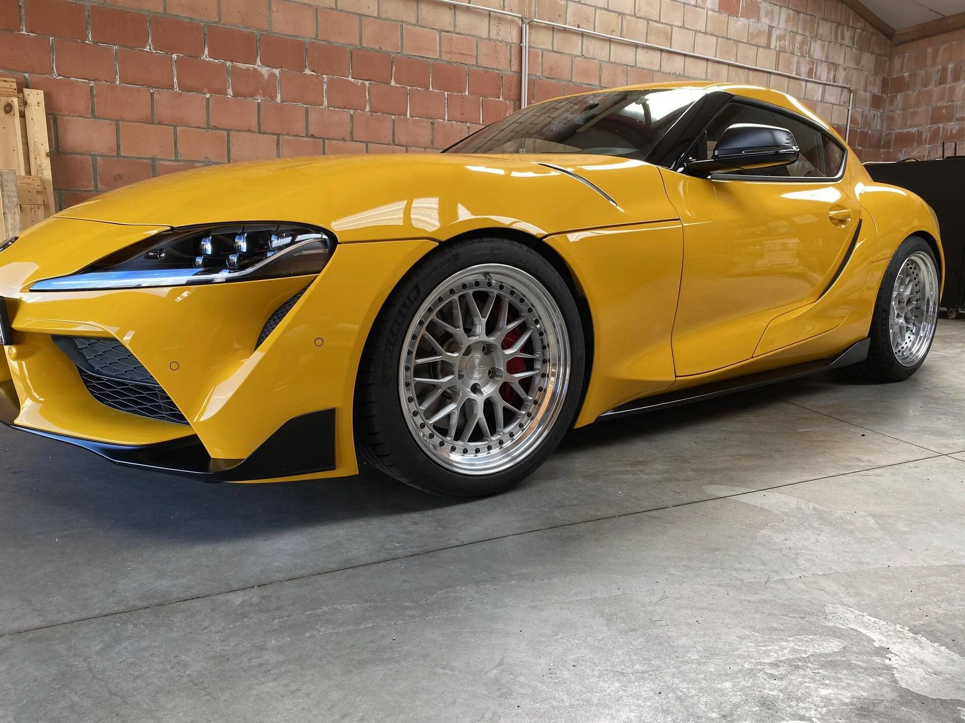

This looks great. Right now, this wheel with polished lip and black center is at the top of my list. I'll get HKS or H&R springs, and I think i'll go 11" wide wheel and 305 tire in the rear as long as nobody reports any rubbing issues by the time I purchase. Is your rear a 10.5" wide?
geert.bieseman
Geert
Oct 4, 2019
253
274
Belgium
Nissan GT-R R33 ; Toyota Supra MKV

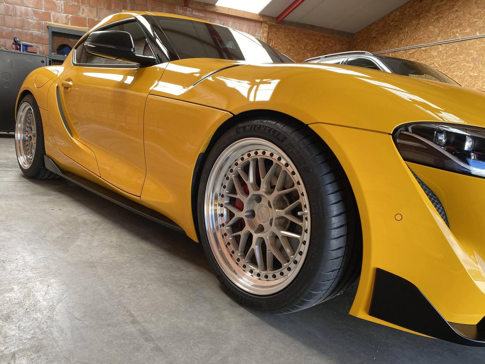

Thanks.
No it is 11" wide on the rear. I have the same sizes as published on their website:
  • Front wheels 19x9.5 ET+22
  • Rear wheels 19x11 ET+35

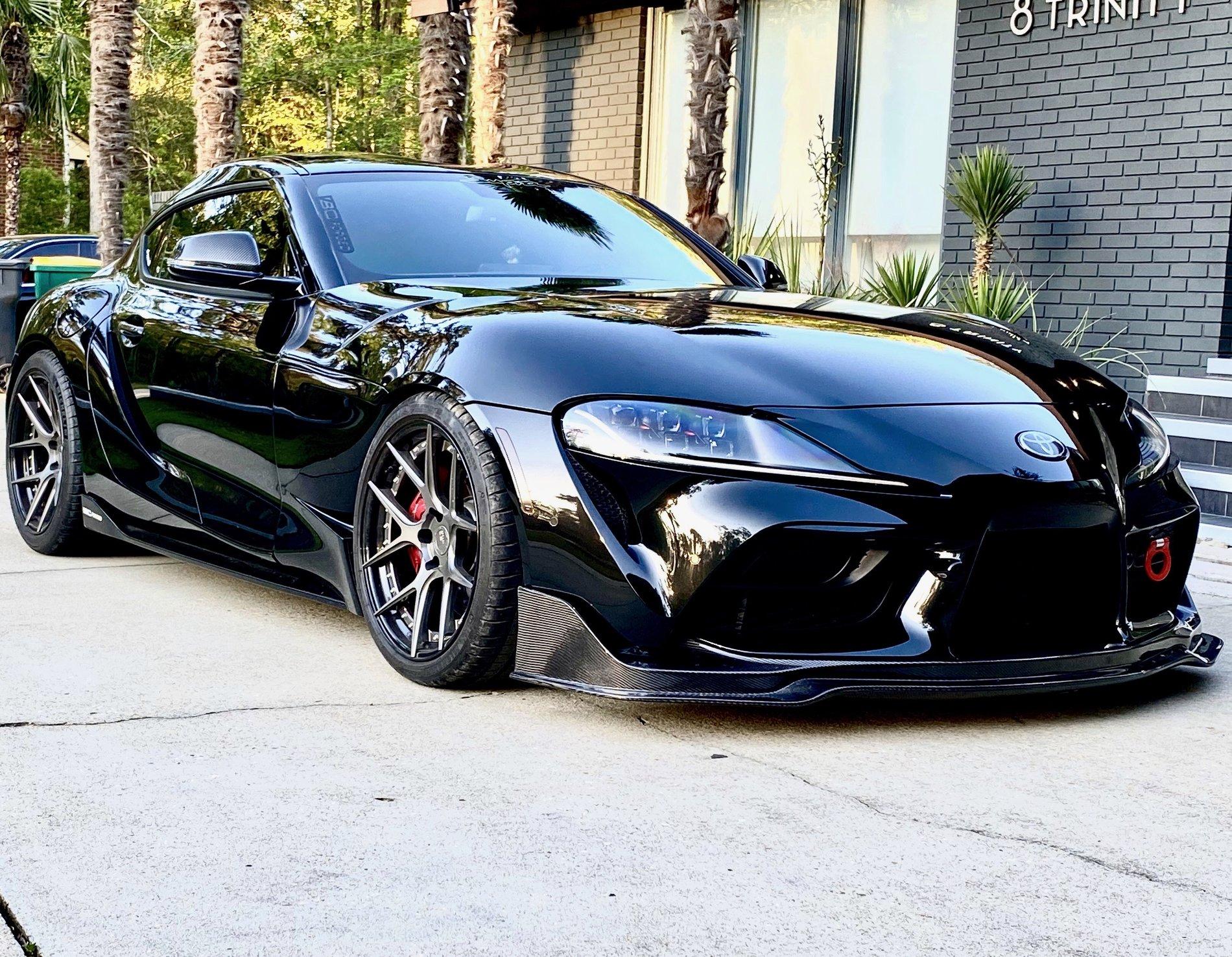

Hey guys quick question I’m lowered on eibach springs and I’m running 19x10.5 +33 TE37s in the rear I’m trying to decided tire size.. has anyone ran a 305/30 in the rear with that wheel spec before? I’m trying to see if I will have and issues with it rubbing

I run a 295/35 (bigger tire) on H&R and have no rubbing issues

Thats good to know. I know the eibach springs lower the car more than H&R springs do. Are you on TE37s as well. What tires are you on?

Rays 57CR 10.5 width rear on Michilen Supersports

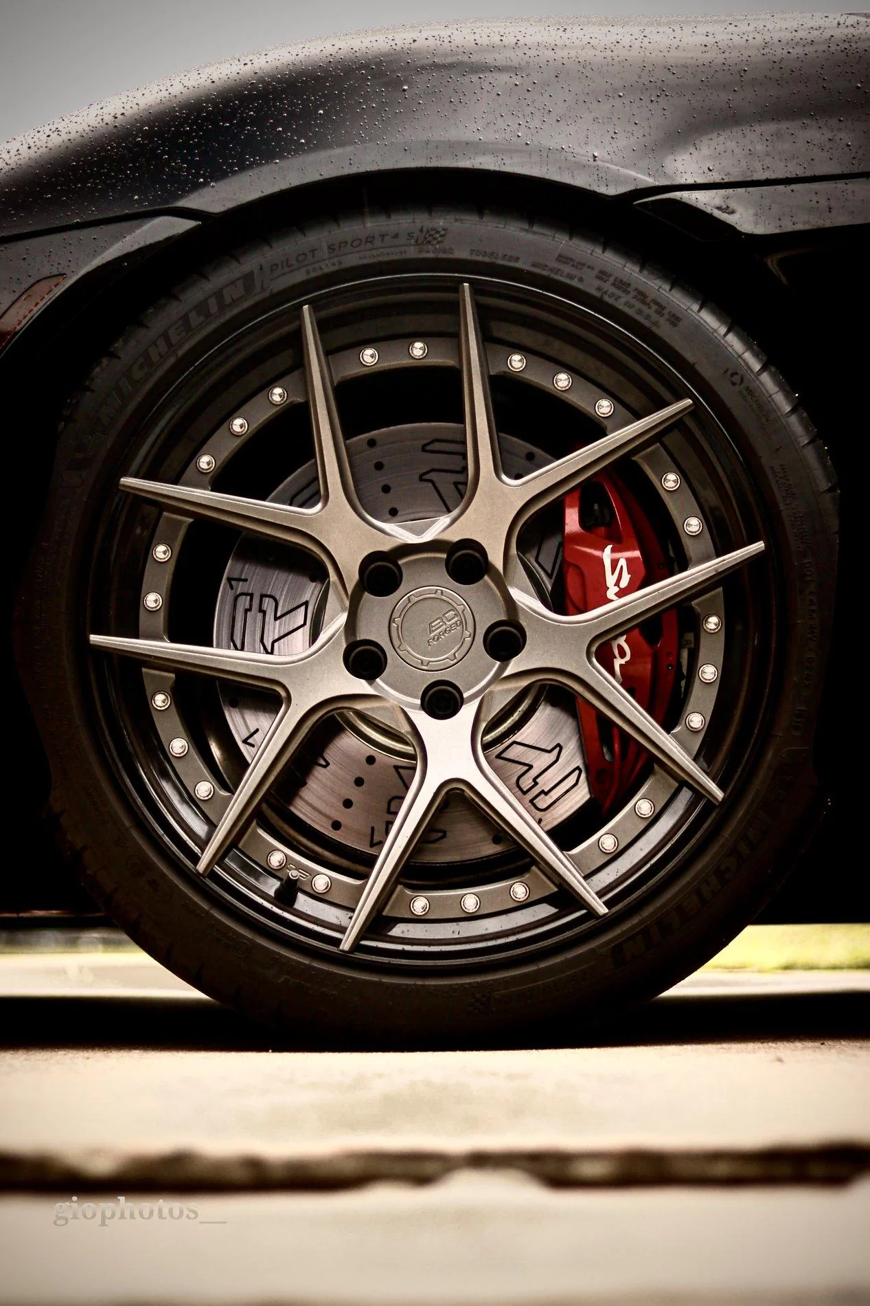

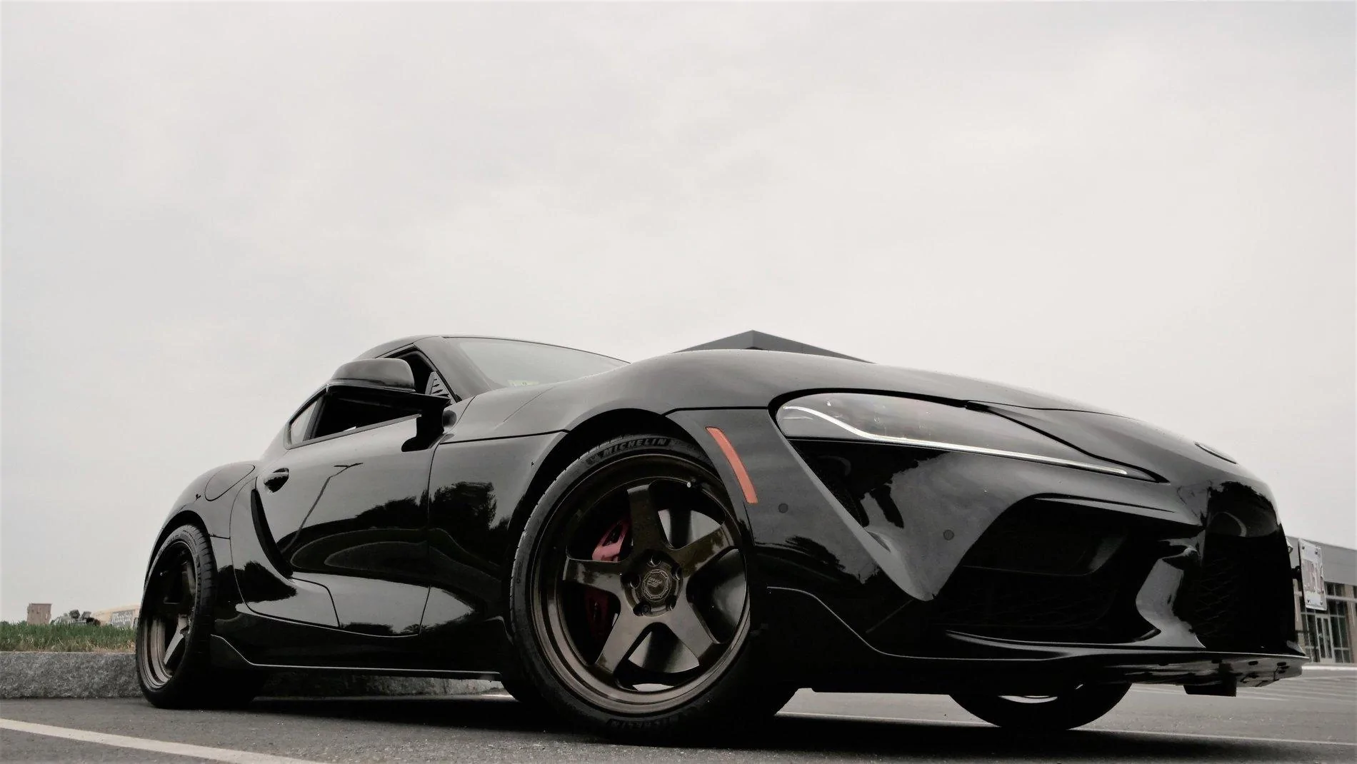

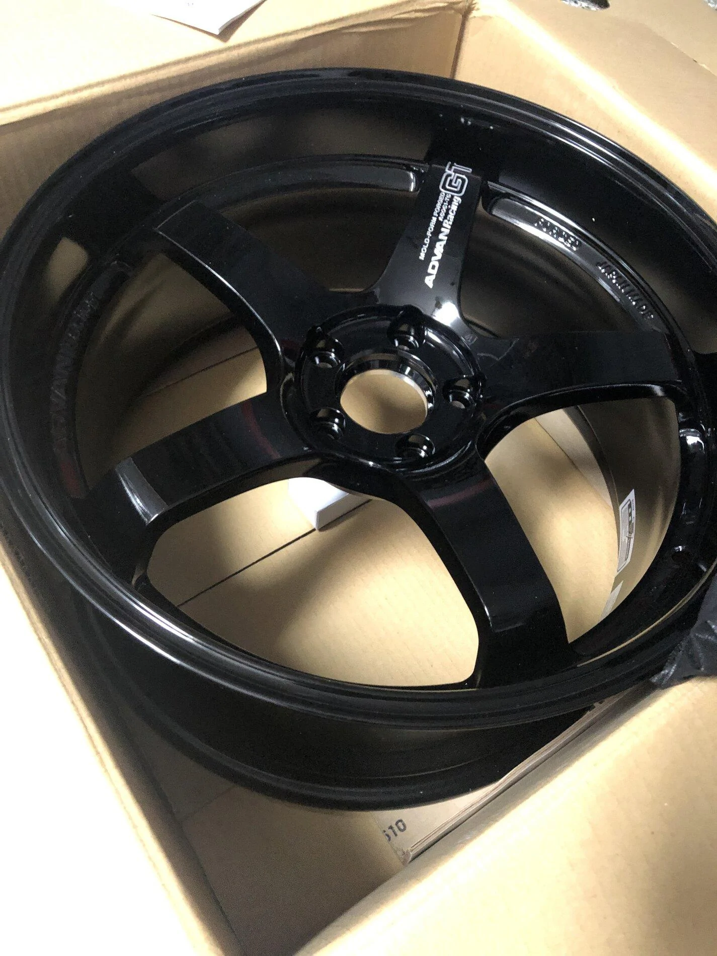

Finally my advans are here. Well at least one front wheel. The other front and both rears should be here tomorrow. Tires are here as well 265/35/19 mps4s. The matching mps4s 295/35/19 Are on National backorder. Still waiting on center caps. Can’t wait to get them on!

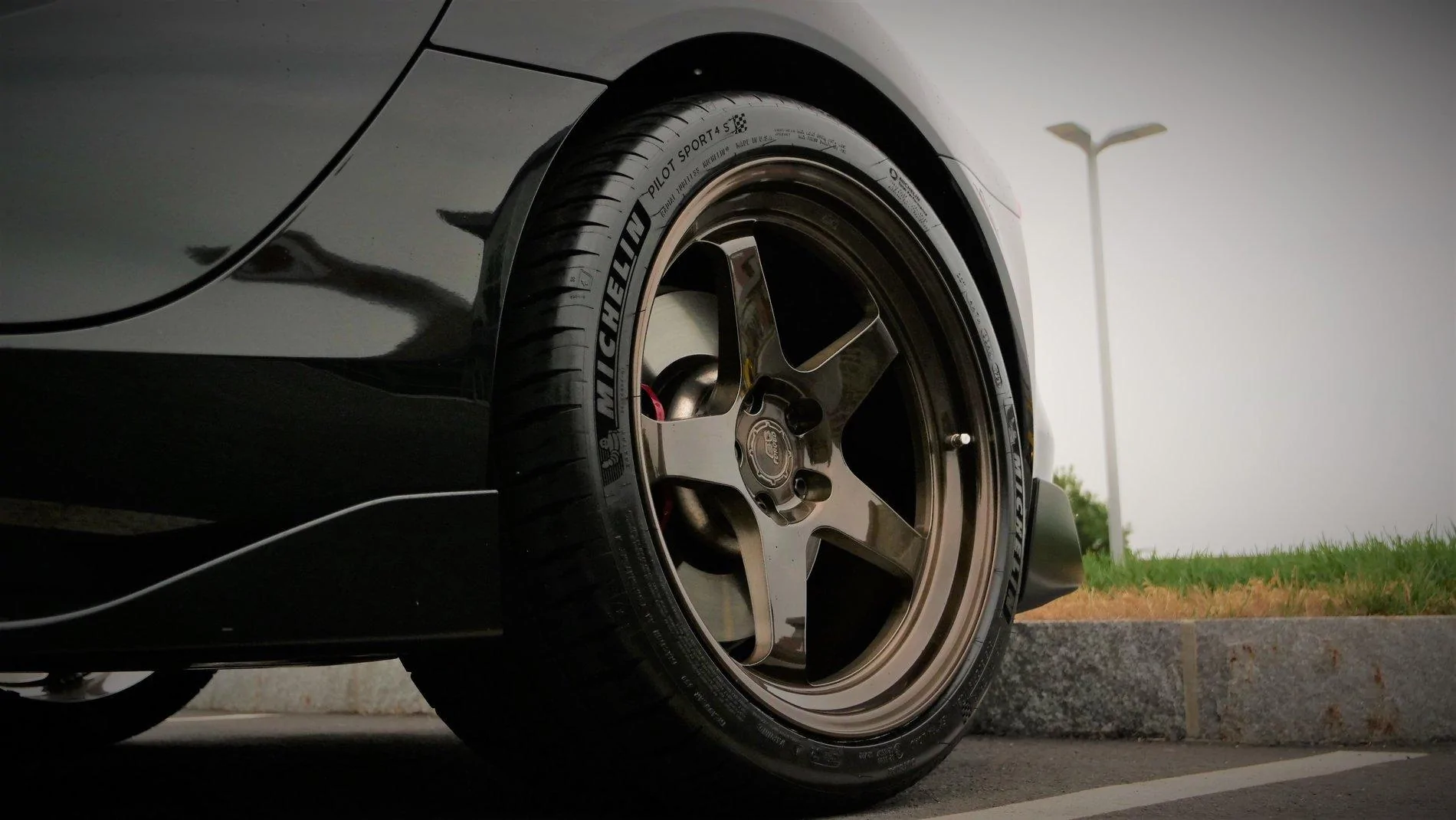

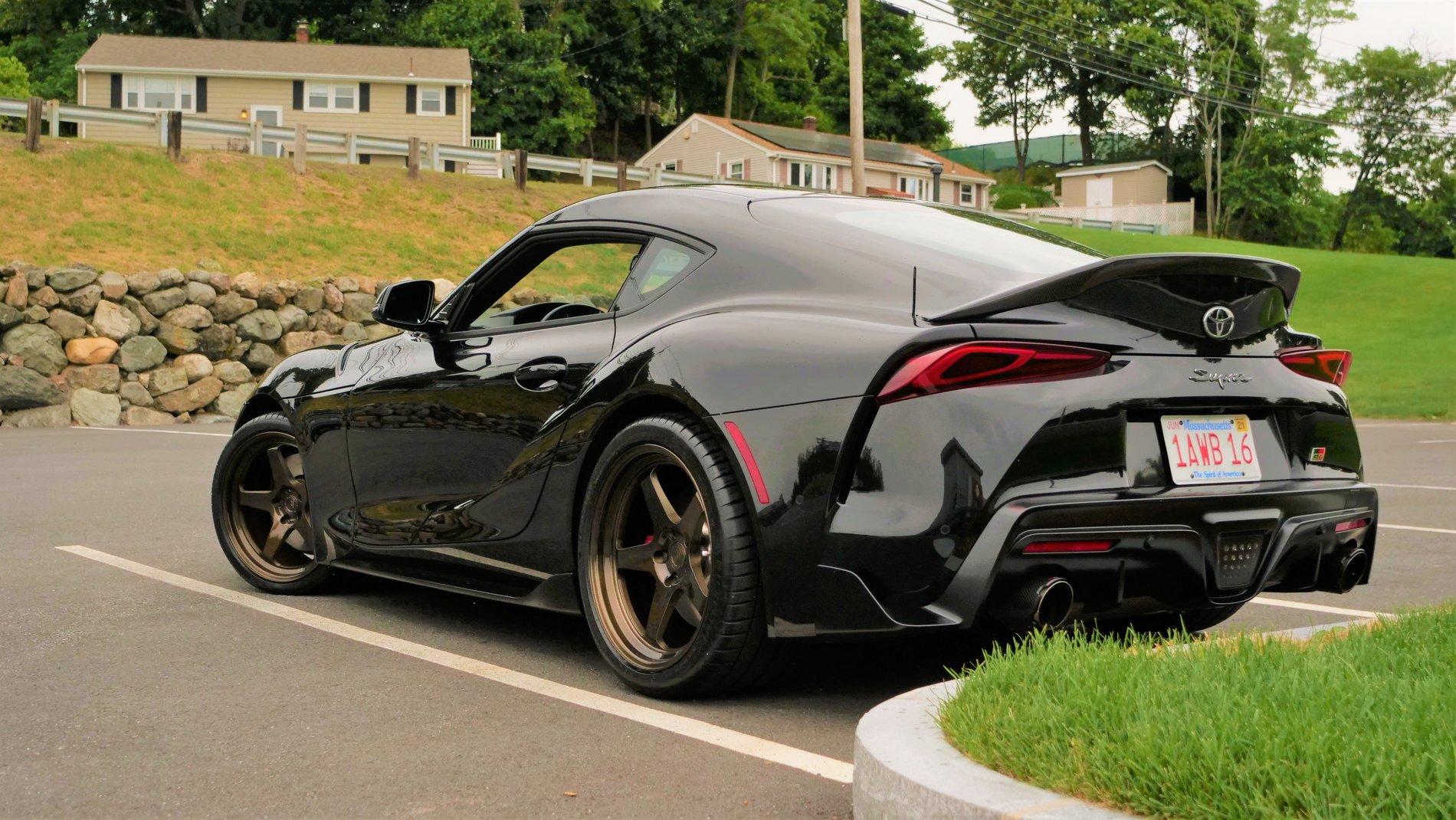

New BC Forged (TD03) wheels in Brushed Bronze wrapped in Michelin P4S tires.
Wheel specs are: 19X9.5 Front, 19X11 Rear.
Tire specs are: 275/30/19 Front, 305/30/19 Rear.
No spacers, or adjustments needed. No rubbing or issues with this setup on stock suspension.
Love the wheels and the bronze on the nocturnal black paint.
