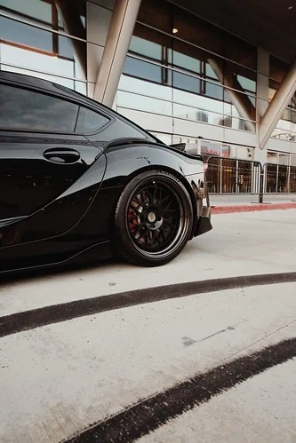

Thinking about going with some work wheels myself, what are the specs and offset of these ?
Let us know if we can help, we're a Works dealer.
-Josh

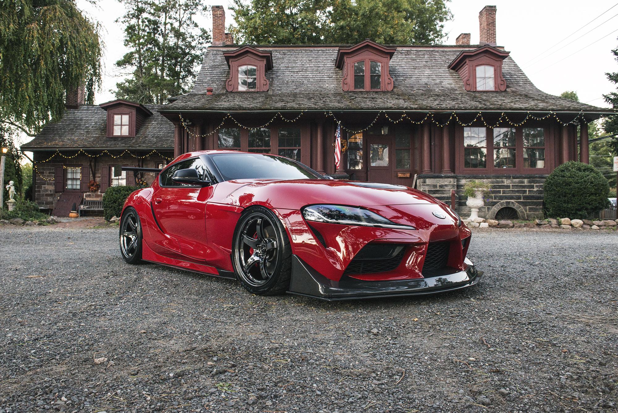

Anyone have success with 19x11.5 +40 with a 325/30 tire in the rear? What modifications am I looking at? I feel like an SPL rear control arm may be able to help.
@Meraki Autoworks
@Blaque Diamond Wheels
Just wait for your widebody. :p
Thats pretty darn aggressive, not sure if it'll fit under without massive camber.

I was actually just thinking about skipping going wide... but I'm torn. I'll have a decision made one the rest of my performance mods are done.
Edit: The body shop here may have an idea for the Infamous kit.

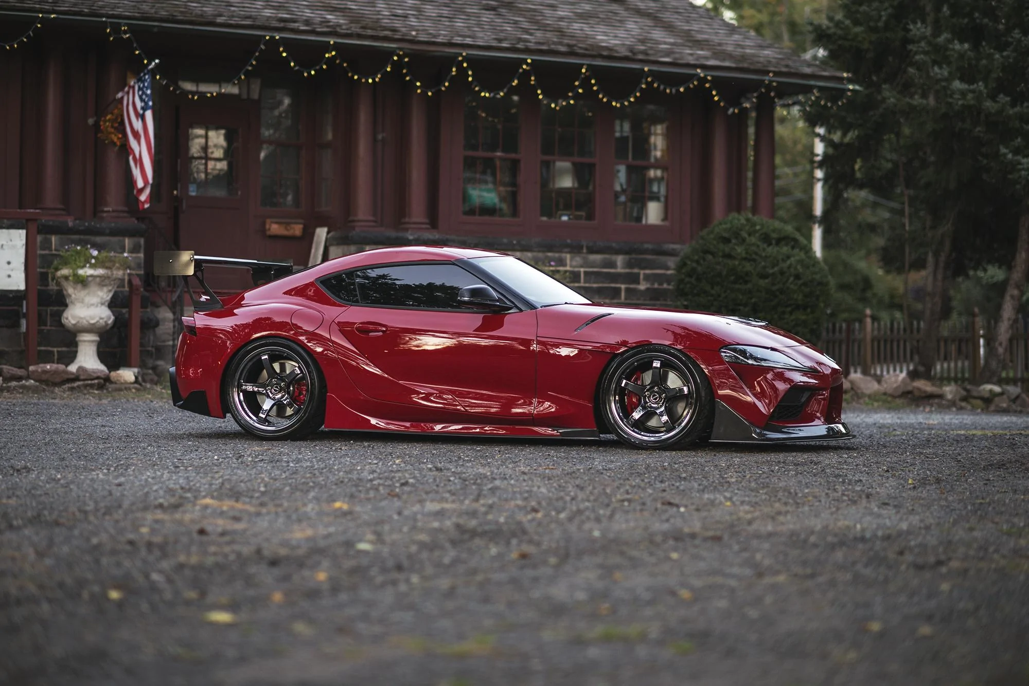

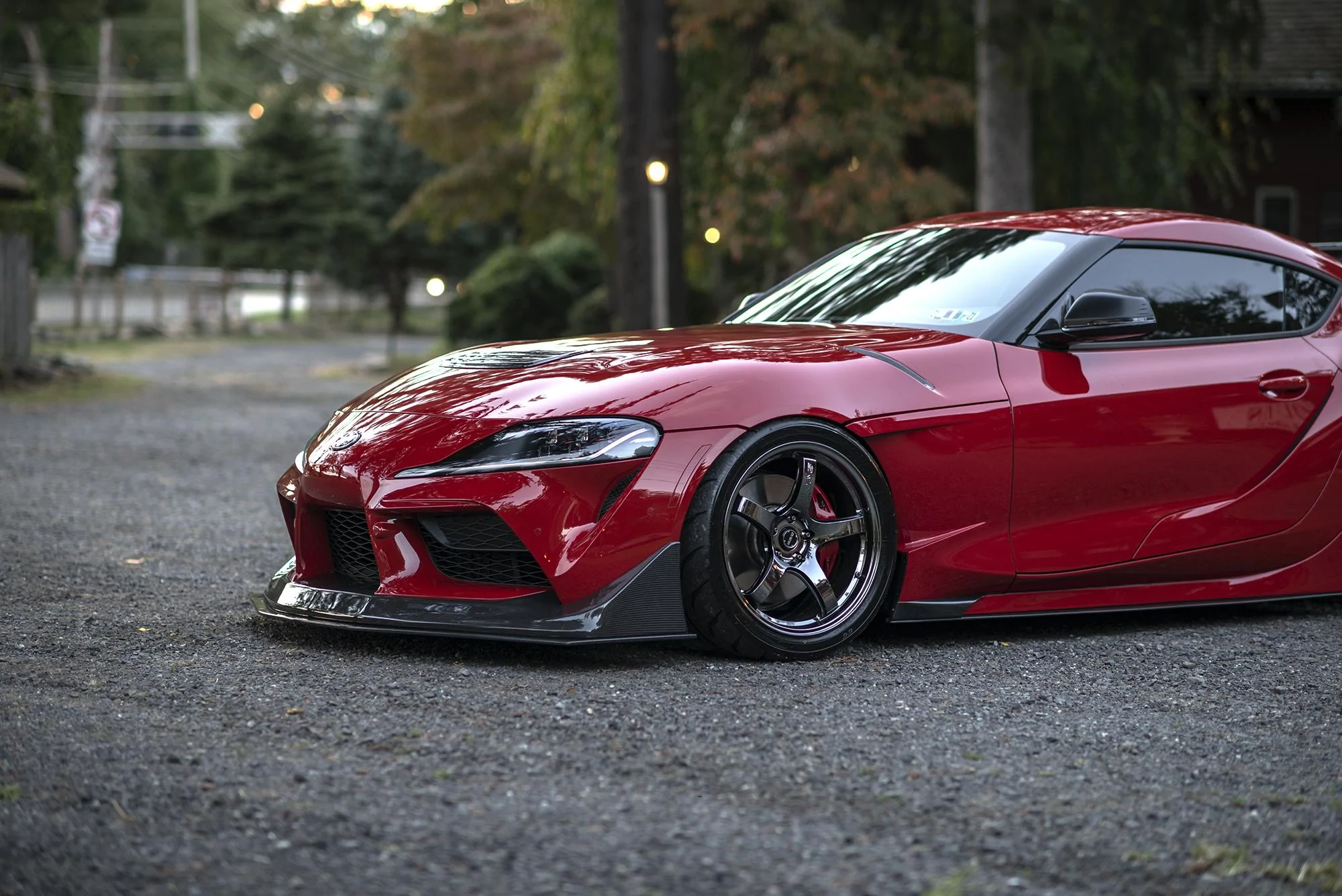

19" VS-5RS Renders:
Front:
19x9.5 ET25
Rear: 19x11 ET40
Finish: Brushed Clear

Is this supra lowered at all, if so what's it on? The reason I'm asking is that I've pledged on these exact wheels and I'm lowered on the eibach springs and want to make sure they won't rub if I have 305/35/19 on.
Yes it is lowered on Megan Racing coilovers, but we used and recommend 305/30-19 tires rather than 305/35-19 in the rear to prevent rubbing. That photo is a render but it is based on an identical SM-10 setup with the same wheel widths and offsets as well as tire sizes (305/30-19 rear) which were a direct fit. I don't know how much the car was lowered overall though.
