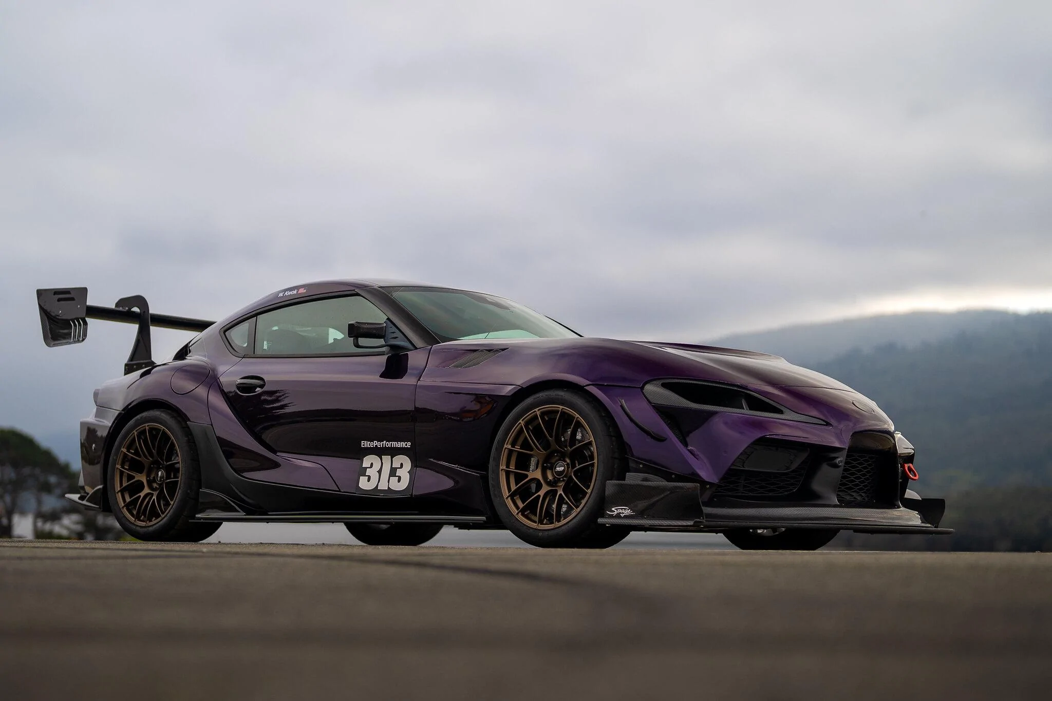

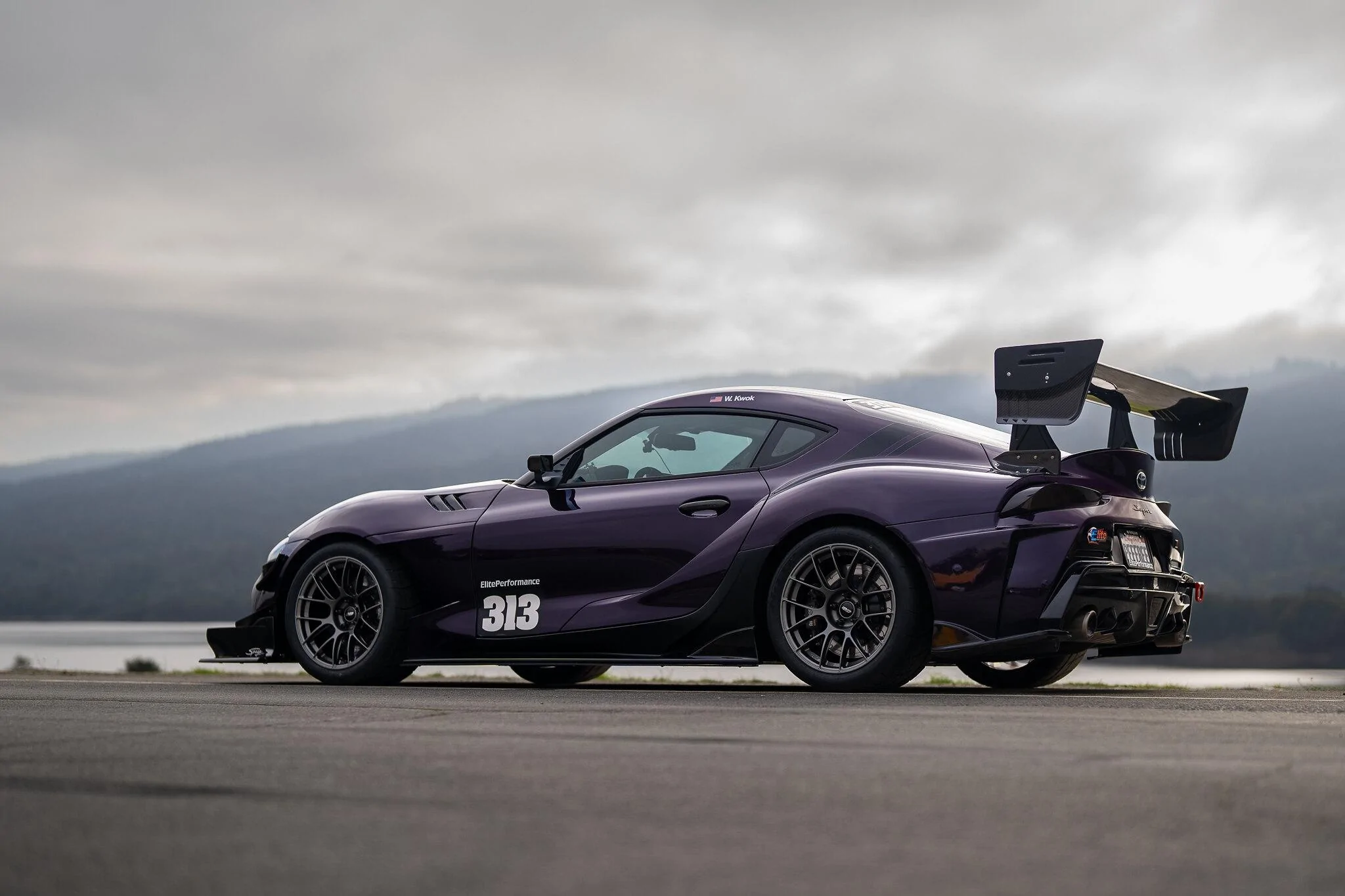

@ipeefreely's Inozotek Midnight Purple Supra on 18" EC-7RS wheels
Wheels & Tires:
Wheels:
Front & Rear: 18x11 ET40
Tires: Nitto NT01
Front & Rear: 315/30-18
Alignment:
Front: -3.5° Camber
Rear: -2.2° Camber
A full Feature Thread is live in our sponsored section, but we figured we'd drop in the video taken during our photoshoot as a teaser. Head over to the full thread to view more photos and a full mod list! Will's build thread can be found here: https://www.supramkv.com/threads/peefrees-a90-supra-build.6528/
