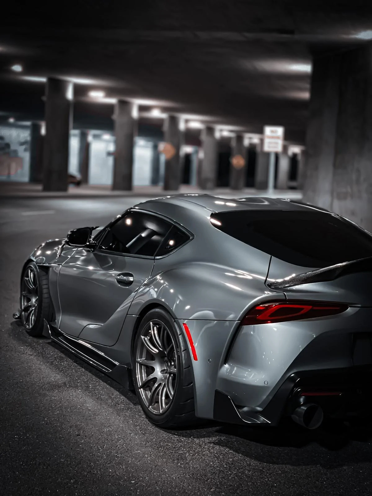

Makes me wish I had ordered 20’s. ?Done with fitment on this car: Final Specs
Suspension
Hope this helps someone looking to obtain similar fitment.
- RSR Best I Active Coilvers
- Rear springs are sitting on an a pair of Allstar Performance 1" Perch Spacers. We were maxing out the threading just to keep the wheels from tucking, so this was the fix.
- I left just enough gap to where my knuckles would not fit.
- Remember. You'll have to do at least one drive cycle for the struts to settle in to get the actual ride height.
- SPL Front Lower Control Arms(to adjust Camber)
- The bracket needs to have an extra hole drill on the bracket for the ride height sensor.
- I ended just removing it completely and mounting it directly to the FLCA. I'll try to provide a picture this weekend.
- Front Camber
- Left: -2.0
- Right: -2.0
- Rear Camber
- Left: -1.9
- Right: -2.1
- Wheels
- SSR Professor SP1s
- Front 20x9.5 +22
- Uses a 3mm spacer. Final offset is +19
- Rear 20x10.5 +30
- Tires
- Michelin Pilot Sport 4S
- Front 275/30 20
- Rear 305/30 20
