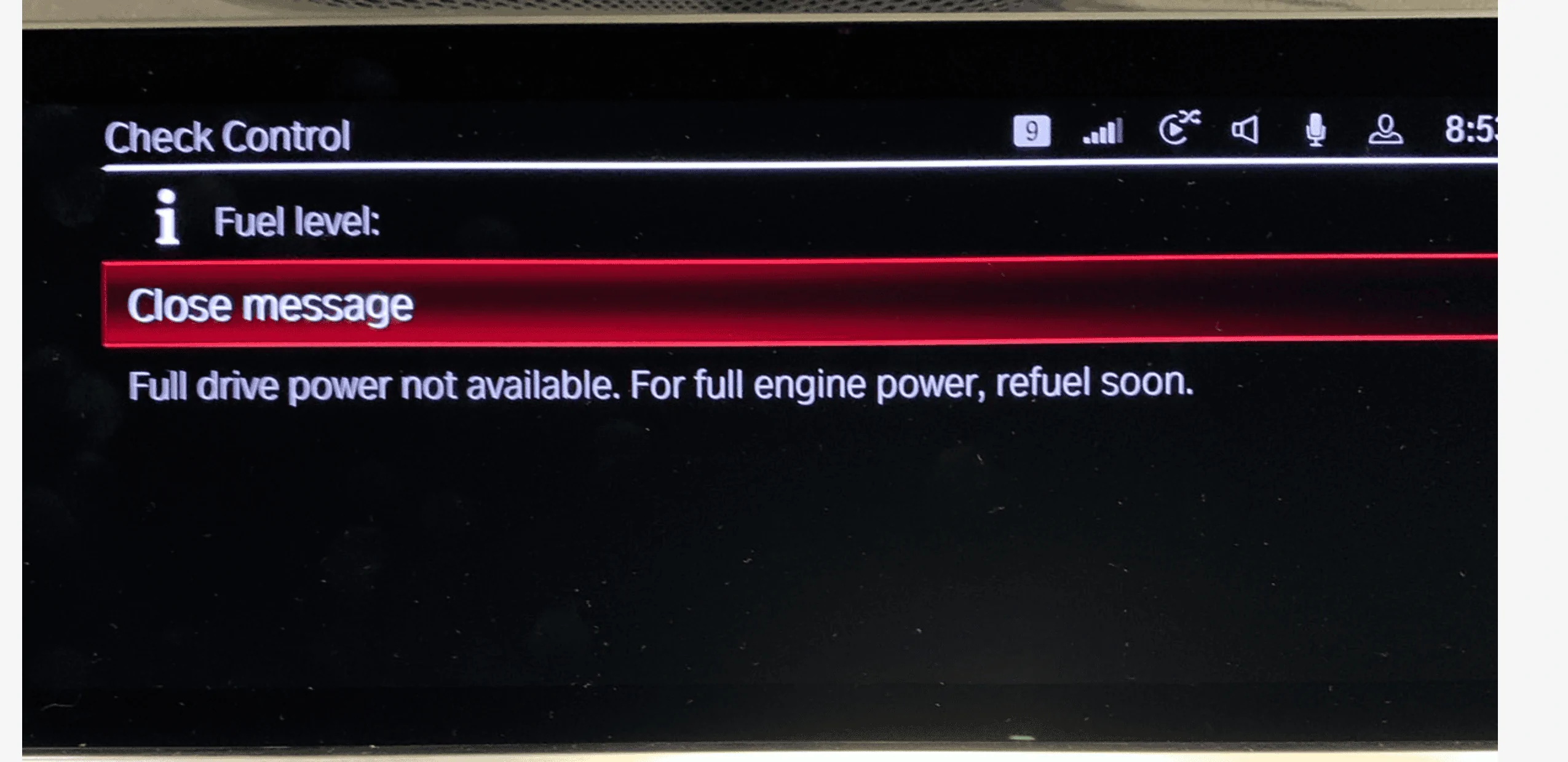

Our BMWs do not explicitly say it compared to the newer models, but it's build into our ECUs
New ones show it. On fuel reserve, it will cut power

Sorry, you are wrong. This will and does happen on track with lateral forces under half a tank on right hand corners. With pump gas you can go lower but with higher ethanol content and higher power demands it happens sooner.
Many of the modified track (with corners when you turn the steering wheel) have encountered this.
Fuel surge tank is the fix. You will notice all the competitive track supras have surge tanks because of this very reason.
That threshold has to be.. like.. a liter or less. I've seen anyone have issue with very low fuel at the track. 2 gallons-ish is most folks are using.
Well fuck me sideways. I've never paid attention to the message and I've only ever gotten that low maybe twice. I notice things seem flat above reserve fuel levels too, which I would be very interested in having some evidence to support or not. Again, may just all be in my head.
