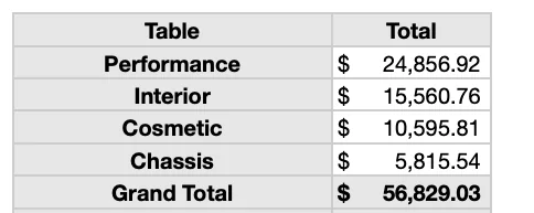

If we are talking about this turbo and it's guesstimated potential then the following parts will be needed on top to take advantage.
Cant forget the custom tune with dyno time and tuning the injectors/motive reflex $2500
Tans stage 1 ~+$3k on top of stage 0.
Driveshaft loop~ $500
Intake Manifold ~ $4k+
Heat exchanger ~ $1k-
Injectors/plugs ~ $1k+
Chargepipe optional
Flexfuel~ $500
Meth kit optional
I have a detailed excel spreadsheet with my parts not including labor spent.
Here's just the total:

Yeah, I have the same spreadsheet.
