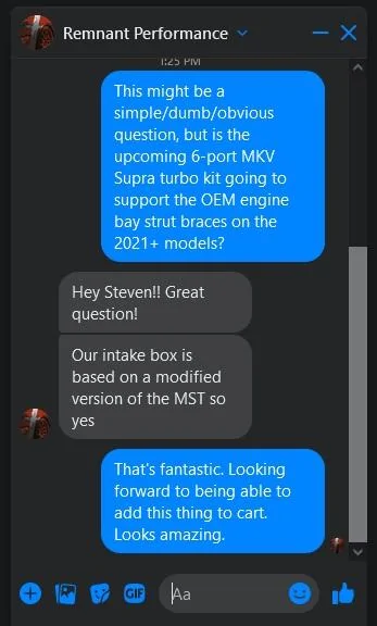

Just leaving this here as an FYI in case someone other than me had the same question.

Question is can I use my existing aftermarket intake (e.g. Eventuri, HKS, etc).
I had messaged remnant and he said no. He is releasing a video to explain this as well.
Edit: Video released
Happy to hear they are considering a closed intake box solution.
Yeah, same here. I also like the sound of the MST intake, so if they are basing theirs off of that it should hopefully sound great as well...you know, for people who care about that sort of thing.
