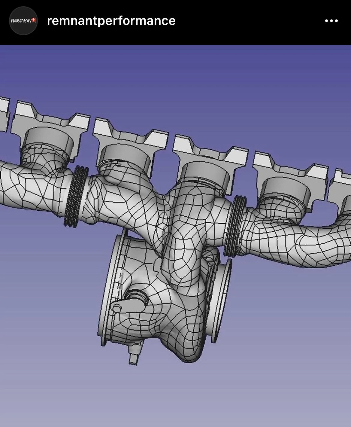

  1. Read this.
  2. Pure800 turbos are $2400 if you send in your turbo+manifold, $3900 if you don't.
  3. Top mount kits are, like, $7000.
  4. The company Remnant Performance is about to release a turbo kit for ~$2500 that includes all of this:
    1. A full charge pipe, compatible with port injection plates and meth injection.
    2. A 4" intake and airbox, roughly the diameter and size of the MST v2 setup
    3. A Verus-style cerakote heat shield.
    4. A 65mm ceramic ball bearing turbo with billet compressor wheel, water cooled, TWIN SCROLL, similar to the Garrett G30-900 -- capable of 800-1000WHP. This is an exceptionally fucking good turbo, pardon my language. Because of the 65mm diameter, lightweight wheel and CBB, the spool characteristics are roughly on-par with the OEM turbo. Fast as hell spool. And it BOLTS TO THE STOCK LOCATION. AFAIK there's no other turbo option on the market that spools like stock and generates power like a top mount. This is truly the "hybrid option" this damn car has sorely needed. Top mounts are usually drag/dyno queens, and Pure turbos are just crude stuffed turbos.
    5. Full compatibility with all aftermarket downpipes.
    6. Uses the factory EWG for easy-as-pie tuning.
    7. You can keep and sell your OEM turbo, charge pipe, intake. Think about how much money that will give back to you.
    8. Optional T51R mod for $250.
Think about this. $2500 for a twin scroll ceramic billet turbo. A heat shield. A charge pipe. An intake. And you can sell whatever you have now for well north of $1K back in your pocket.
As an aside: the same company is also going to release a 4" oval turbo back setup to dual 3" out. AFAIK that's the highest flowing exhaust on the market. All joints are v-banded, resonators are swappable with provided test pipes, mufflers are also swappable if you want to throw in a new muffler with V-bands. This setup INCLUDES a catless downpipe. Price? $1500.
So for $4K you get:
  1. Drop-in replacement twin scroll turbo
  2. Heat shield
  3. Charge pipe
  4. Intake
  5. 4" downpipe
  6. 4" exhaust
Orders on all of this open soon, within the next 60 days(ish).
There is absolutely no better deal on the market. Paging @zrk to +1 this.
Also paging @AustinGRSupra because he was interested as well.
