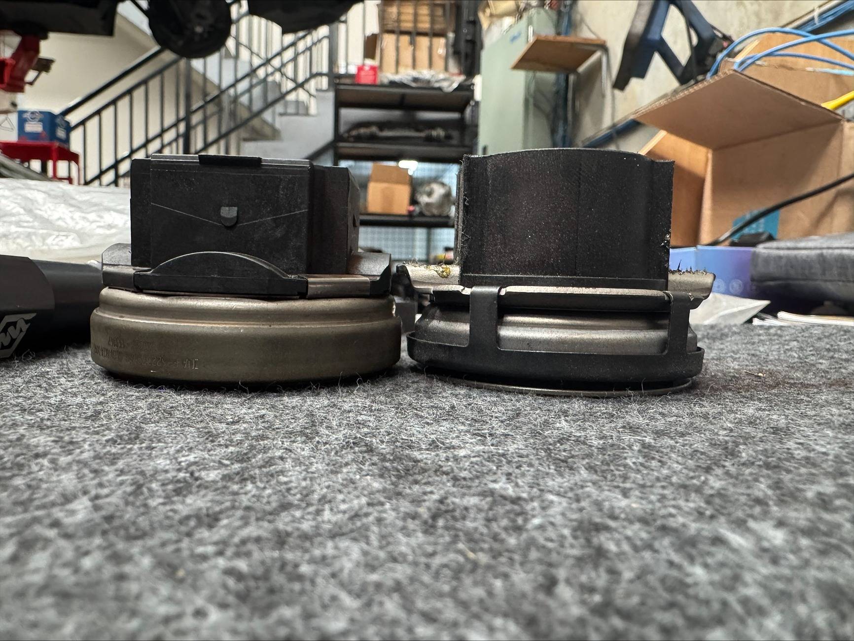

Just skimmed it and what I saw was PTB was good and they were having issues with clutchmasters which our Supra guys were having issues with also. I personally have the PTB organic/organic with the upgraded pressure plate and the billet flywheel and Release bearing and it’s perfect. The Shop also said PTB is the way to go at the moment maybe clutchmasters has or will get it together.
edit:added release bearing

So after reading through a lot of of those posts. I forgot when I first bought the car I put the BMS clutch stop in. I just removed it this morning and took care of 60-70% of the issues I was having. A lot also mentioned clutch bushing, and after reading more about it on clutch master’s website, I ordered that.. I believe once I install this, it’ll be back to normal. My car also just hit 5000 miles and the puddle has slop in it as that article describes.

You fitted a whole new clutch assy and that stupid thing was still fitted. No wonder you've got release problems.

-which bearing are you using? OEM?
-you should definitely remove the CDV if you haven't already.
-I went the sinter+organic disc with the performance pressure plate. I will be interested to see if it changes at 2-3k miles like you said.
-i get the same shudder in reverse already at 1k miles
