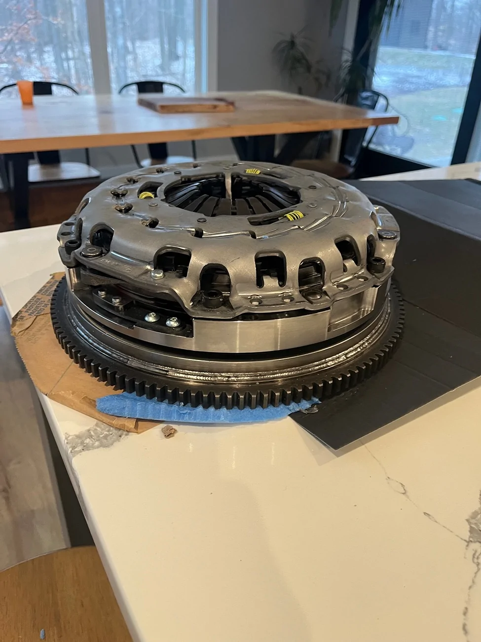

Got the clutch in. literally drives like stock. the only change is now the bite point is lower. i know some people like to run a pedal stopper, but with how low the clutch engages you would not be able to use it anymore. going to break it in, get some track days in and see how it holds up to abuse
How did you setup the release bearing?
Eastwood
Dec 20, 2022
802
1,131
SoCal
ex ex
unfortunately i sent it to my local supra shop for the local install
Do you know if they installed the release bearing on the longer setting or shorter? If you go back to them let us know.
