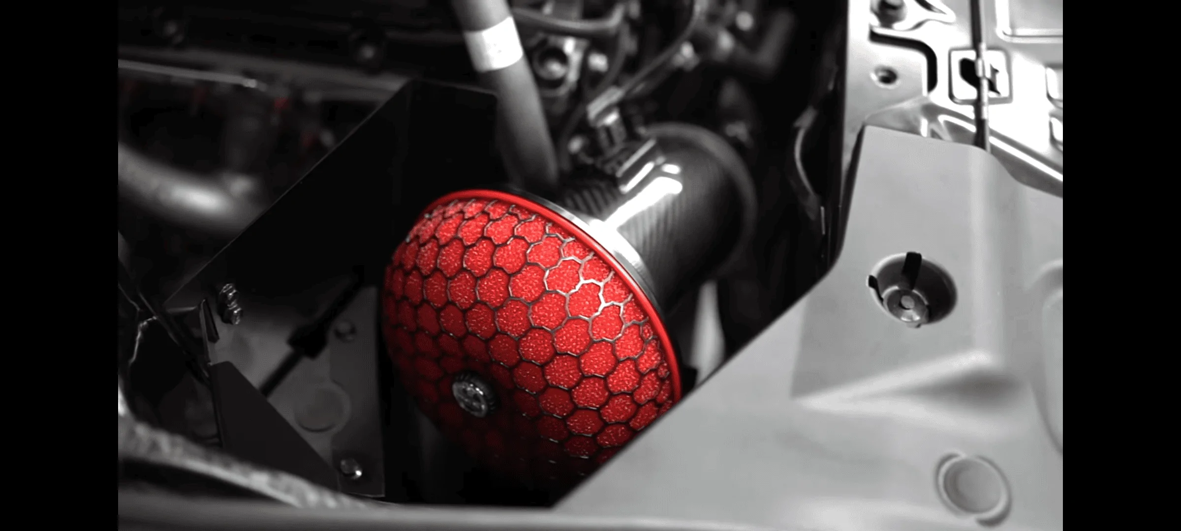

MST and Armaspeed both sound great, eventuri is a little on the quiet side for me, I have HKS and love it, the best intake in my opinion but it is definitely loud. CTS is a good one for the money too with the inlet pipe. Had that for a while on my 2020.

What's the difference between CAI with the filter exposed vs the ones that are closed in a box (i.e. HKS vs a EVenturi)
I assume mainly more sound for exposed, but does exposed make it potentially more harmful for air temps ?
Sound is the biggest difference.
In theory, closed-box intake has a lower IAT, but in reality, no data on the SUPRA has shown that closed-box outperforms open intakes.

Just do something simple like the Burger open intake on the stock box. No sense in spending tons of $$, especially when you upgrade the exhaust down the line. If I could do it again, I would keep the stock intake and just spend my time and $ doing the downpipe!

I ran both the injen and Armaspeed. With the Injen your IAT temps will most definitely be an issue in you live in a warmer climate. It's not sealed and cause the temps to get hot very quickly which pulls timing. You are better off with your stock Airbox. The Armaspeed had a noticeable sound improvement and I was pleased with it. And it didnt cause temp issues for me. Hope that helps.

Do you have data on the IAT difference?
