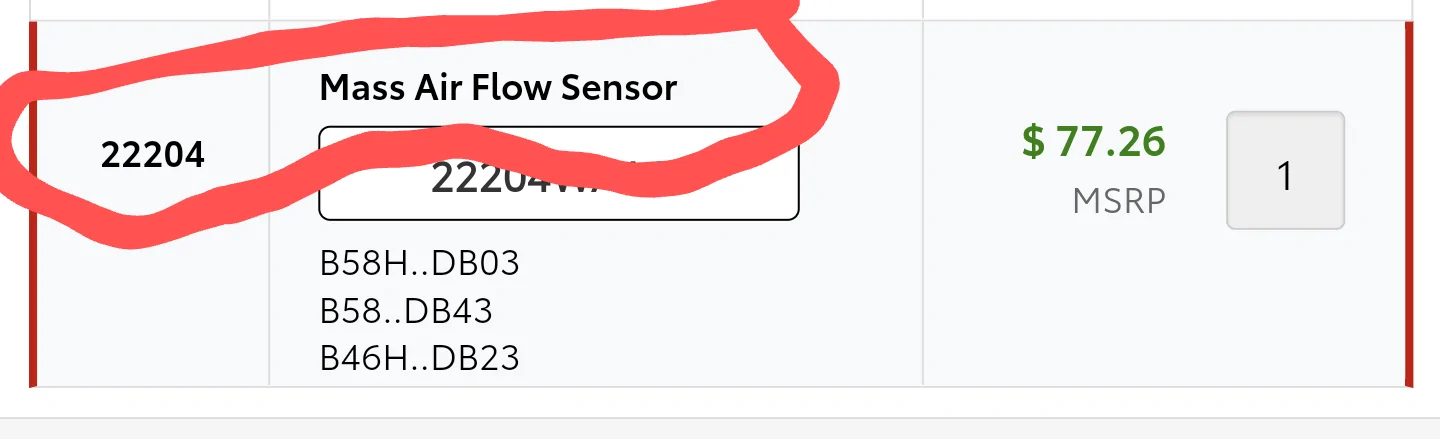

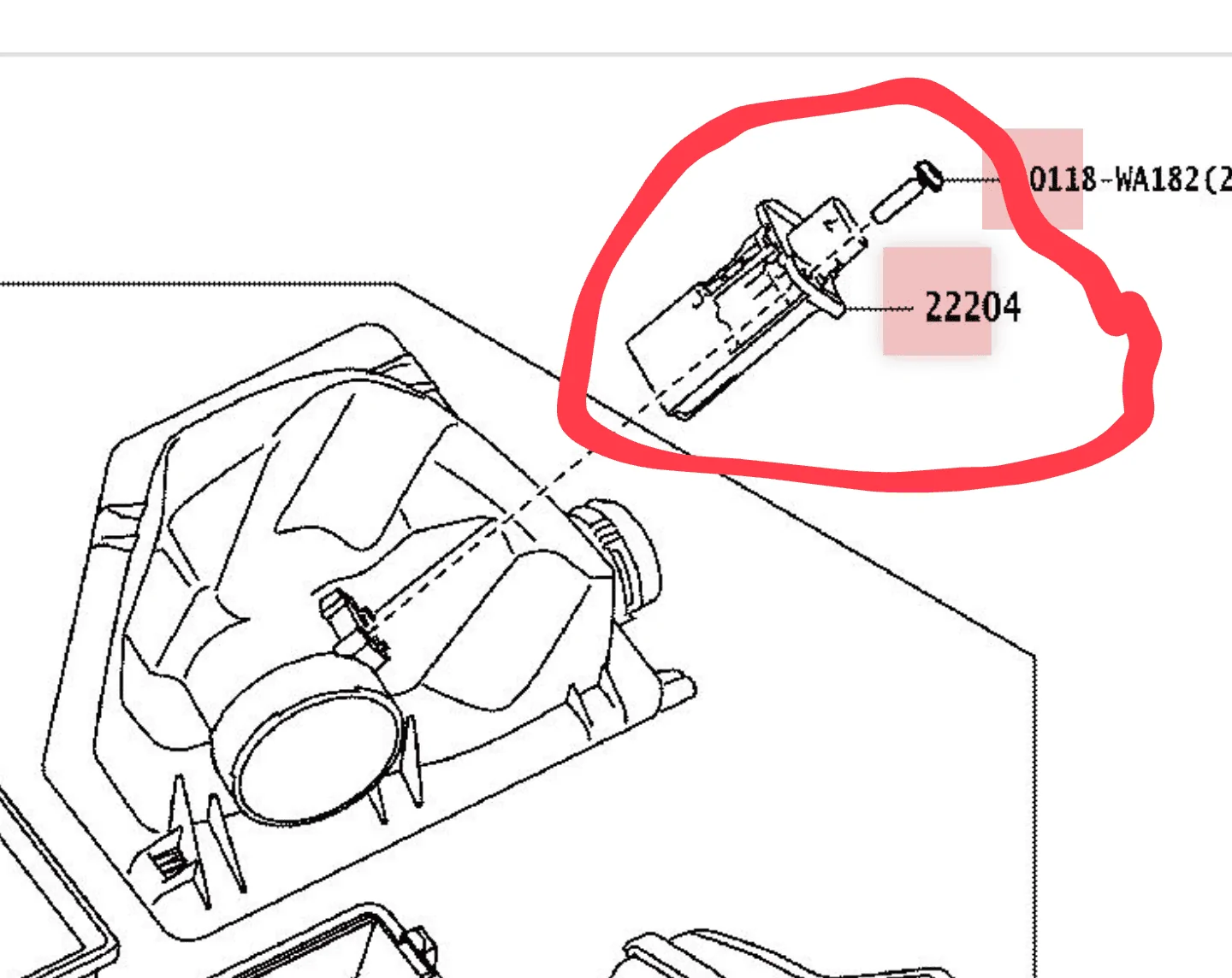

This isn't a mass airflow sensor; it's a temperature probe.
Toyota feels differently by name (from their official parts website):
It doesn't need to sit tight or make a seal. It's just a temp probe, and not even one that's used to measure IATs (that's from the MAP sensor on the chargepipe). Just getting it to sorta seat is more than enough. There's also no real pressure there, it's on the intake side. Leaks or whatever are fine.

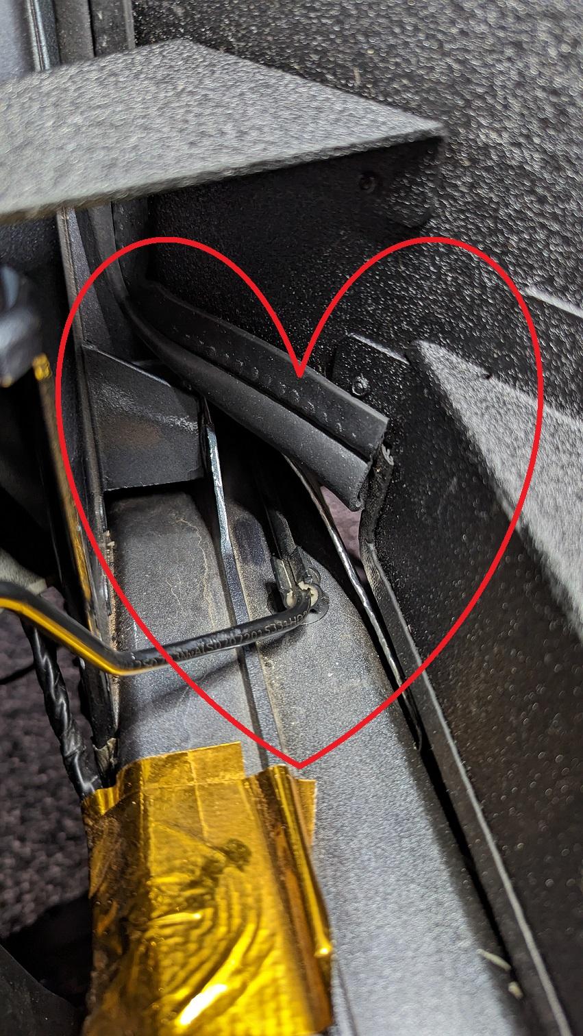

Got the replacement parts for the damaged stuff. Meant to post this earlier but my house has been a damn leper colony lately - can't stay healthy! I had noticed something while the car was sitting taken apart for a while. There seems to be a large hole at the bottom of the MST heatshield pointing directly at the turbo heat shield:
It's larger than it looks in the picture because of the angle of the shot - the length of the phone prevents a lower photo. Unless I flipped the phone and took it upside down, I suppose. At any rate, is everyone with this intake running around with this gap in the heat shield? I'm assume so, but I thought I would ask. I don't know if it would make any difference at all, but I figure I would block it before I finish the install. I want to put a big ol' glob of spray foam in the hole just because it would be so satisfying.

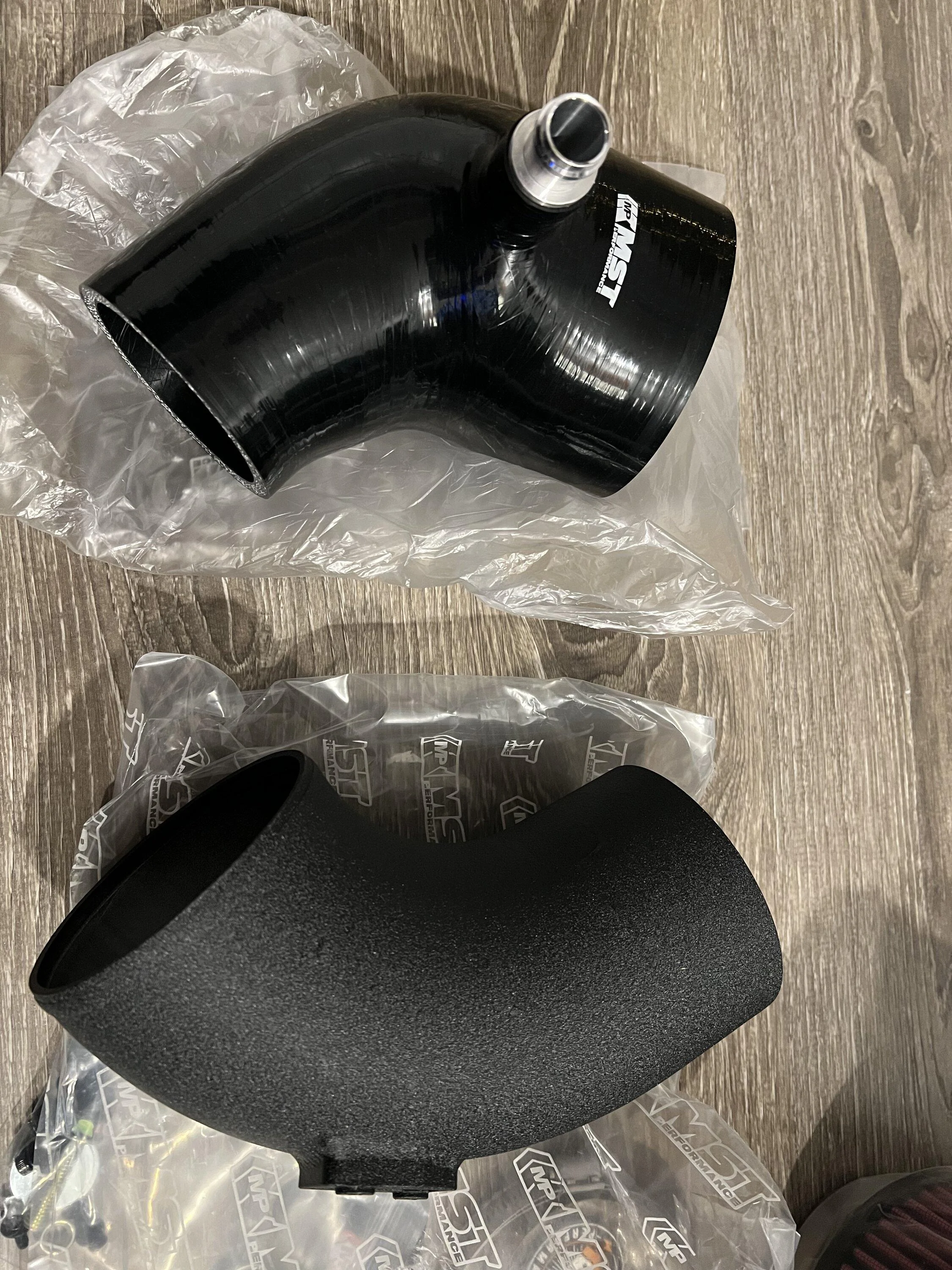

Also, as an aside, it's interesting that MST has moved to a rubber turbo inlet pipe that connects to the turbo inlet using a clamp and away from the metal pipe they used previously (which I have) that connects using the stock method of a c-clip. I'm guessing it's because it's much, much cheaper to produce and doesn't retain heat, but I'd like to know if anyone has any information about it. The picture on their website has been updated (https://www.mst-performance.com/products/ty-sup01l) but they don't mention the change to the kit.
I just installed the latest V2 kit with the silicon coupler. I was a bit surprised as I didn’t know they updated the kit until mine arrived. Installs easy and I’ve been checking every couple of drives to see if the connection is still ok. Seems solid enough.
I also have the exact same gap you are showing. My OCD kicked in and I got some rubber weather stripping to take up some of that gap as well as along the lid and the thick cable on the left side. Im sure it makes absolutely no difference in temps ?
Nice! I think I'm just too traumatized by my experience with the Eventuri intake to trust the silicone inlet pipe being attached to the inlet with a clamp (kept popping off when the motor torqued - but I had fitment considerations because of an AOS). In fact, it's the only reason why I went with the MST over the ArmaSpeed intake. Thanks for confirming the gap - I'm glad I'm not the only one OCD enough to notice and block it before finishing the install!

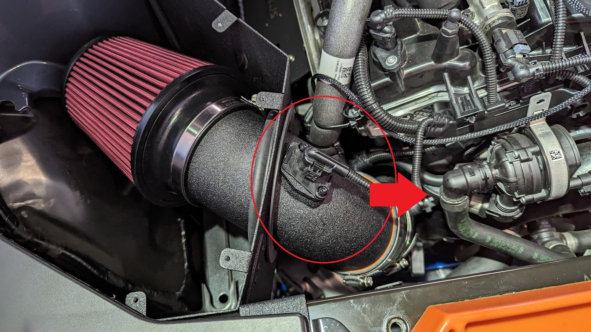

Hi all. It's me with your weekly MST intake installation question. No, the car is not fully put back together yet. Yes, I have two small children and travel for work, which means installing parts 20mins at a time. Everything is installed and working fine, but I'm curious about the orientation of your intake pipe. The mass airflow sensor only fits in one way, depending on which way you installed the pipe, which means the connection is going to either result in the wires pointing towards or away from the heatshield. See the orientation of mine below, pointing away from the heatshield:
This is the way the instructions say to install it. I've watched just about every YouTube video on this install and it's a mixed bag. I'm having some fitment issues, which I think I've narrowed down to the Verus Engineering motor mounts that were recently installed. I'm not saying these two parts are incompatible, just that the likely slightly different way the motor sits in the engine bay now has resulted in a tight fit for the intake. At any rate, I'm curious which way you installed your intake pipe if you don't mind sharing!

Yeah, No idea why Toyota mislabels that. Translation issue from BMW? It's 100000% a Temp Probe (and looks nothing like in that illustration). These cars do NOT have a MAF, or changing things like intake and turbos would be impossible with JB4.
To prove it, disconnect it and start the car. If a MAF equipped car tries to start without a MAF, it'll freak the fuck out.
Even on Toyota parts sites, if you look at the 'vehicle fitment' section, you'll see this part-number is a Toyota part, for Toyota ECUs and is not compatible with the B58. https://toyotaparts.mcgeorgetoyota.com/oem-parts/toyota-mass-air-flow-sensor-2220422010
Yeah, I don't know. Just going by what Toyota calls it. What you're describing is the way it worked on my old GTI VR6 with its mass airflow sensor setup.
