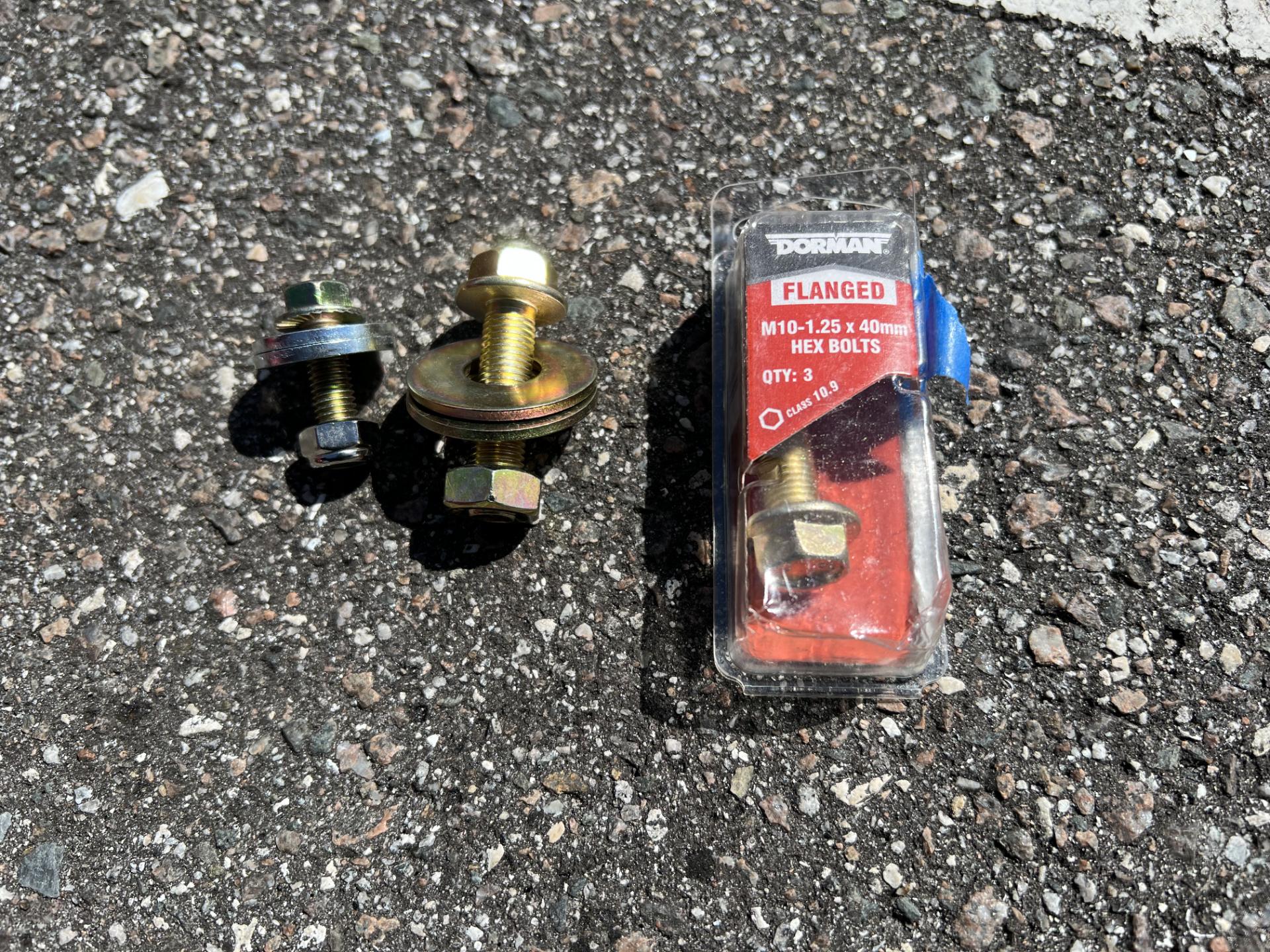

  • I had to source my own hardware to bolt the heat shield to the car (example attached). The provided bolt was not long enough to thread the nut along with the included washers. I used M10-1.25 x 40mm bolts and two washer I had that fit (all class 10.9).

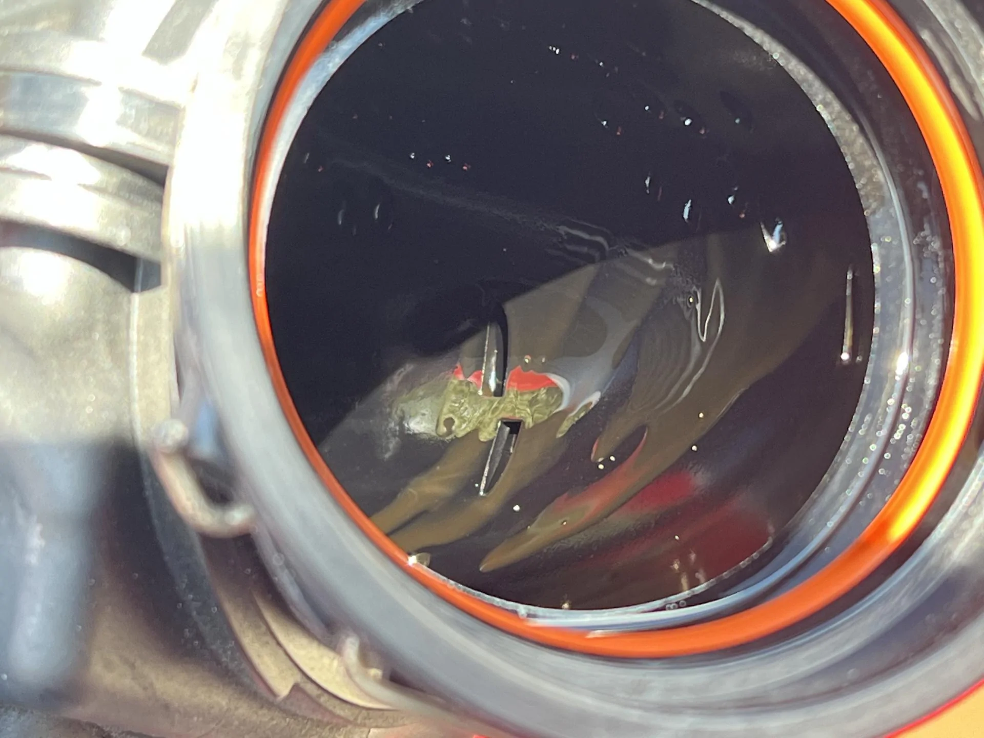

  • I found some oil in the stock intake. Anyone know if this is a normal or abnormal amount?
