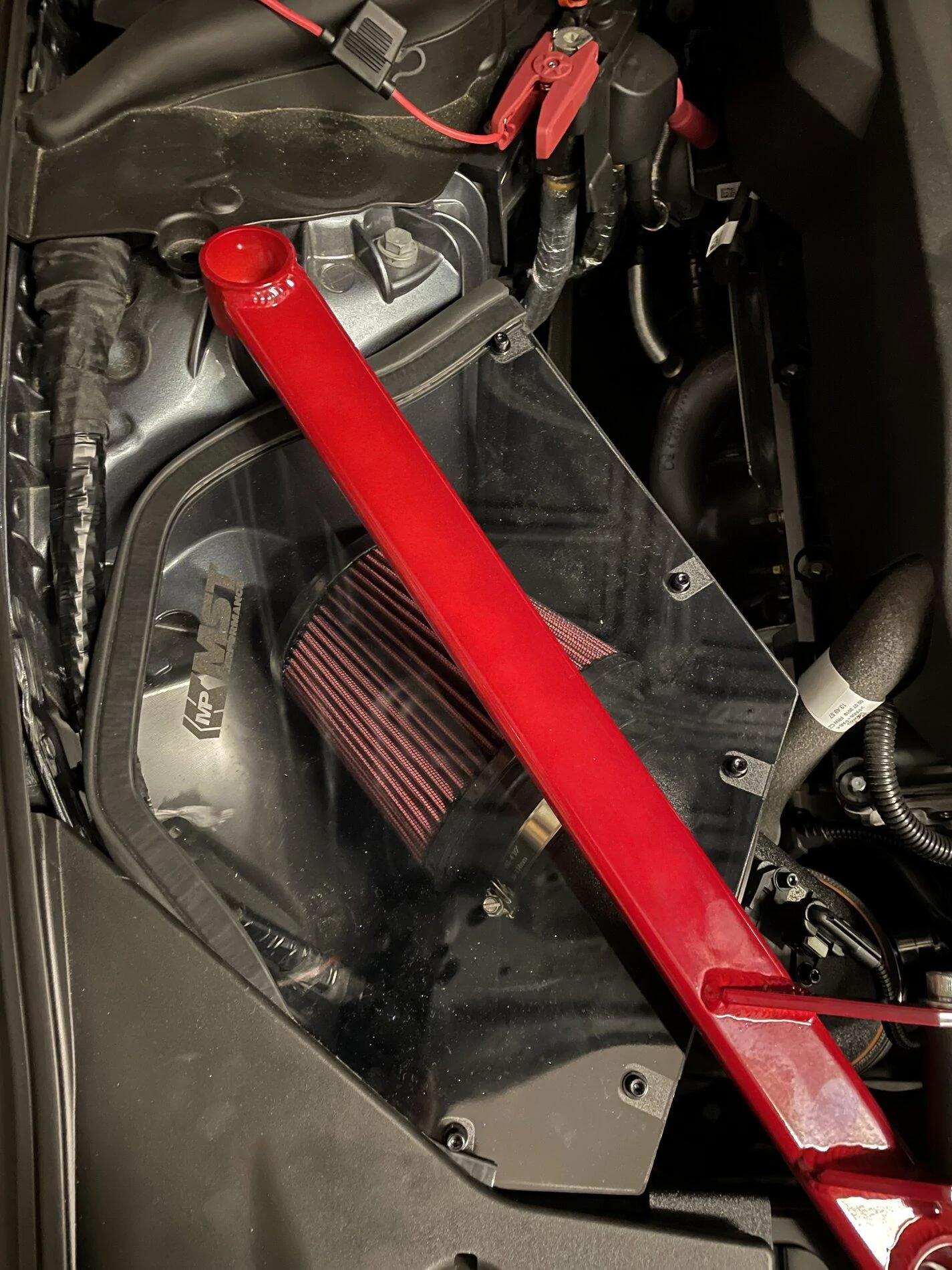

Used some pliers to try and get a better fitment. Still kinda crap b/c some of the corners don't match the original lid, but it was enough to be able to get it installed. I'll grab some pics tomorrow since the one I took today is potato quality.

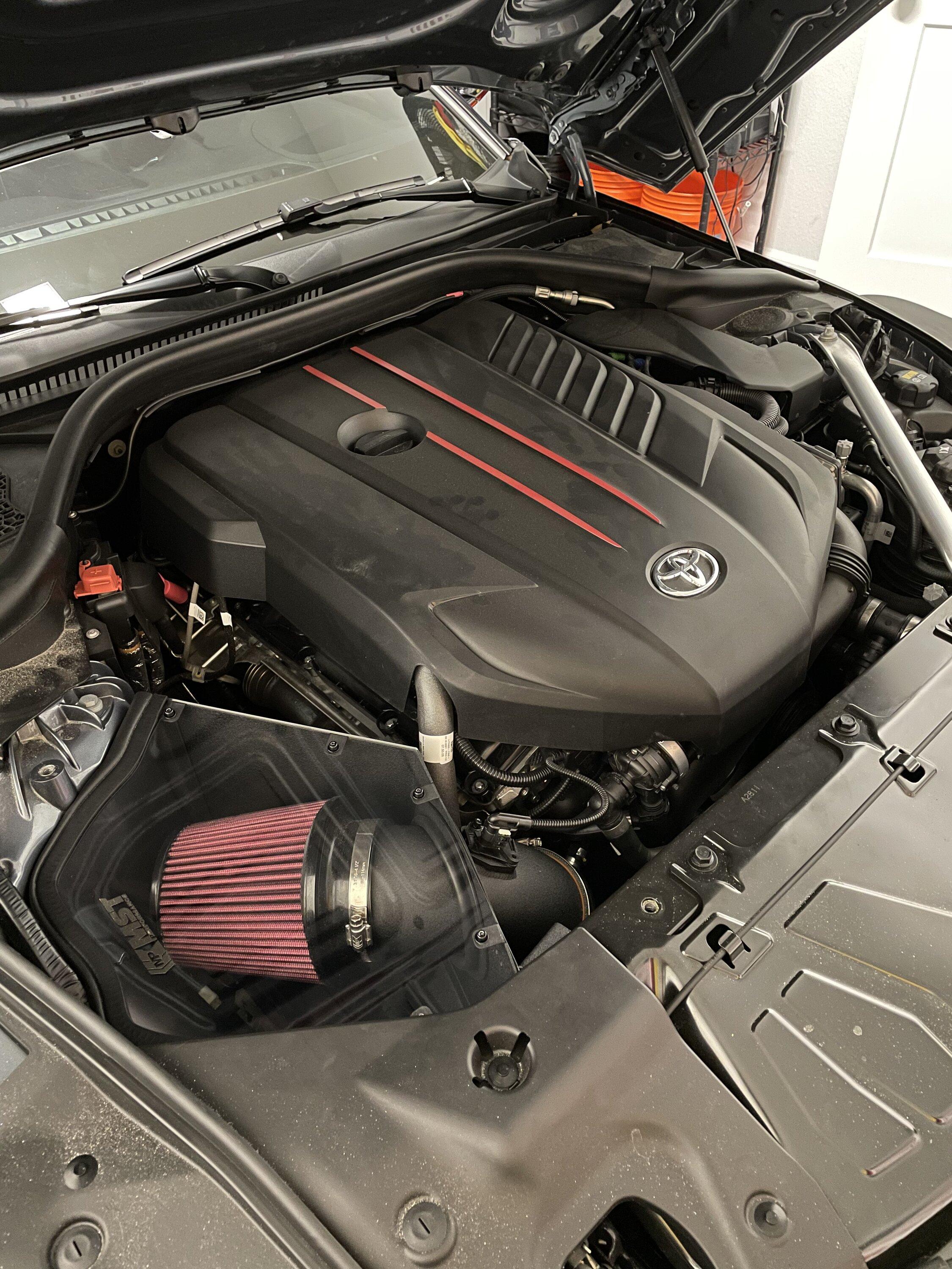

What I ultimately ended up doing was taking the rubber edge off of the black, non-clear cover that I was replacing and put it on the clear cover since it was already formed to the body of the lid. It was much easier to put on that way and it turned out good. Here’s a pic I took:
I wasn’t able to get the bottom most screw in because it didn’t align with the hole on the heat shield, but then again I wasn’t able to get that screw in for the non-clear cover either. The heat shield is bent in such a way that I’ll need to bend it back in order to get it to align, but I didn’t care enough to do that. Just a fitment issue with these MST intakes.

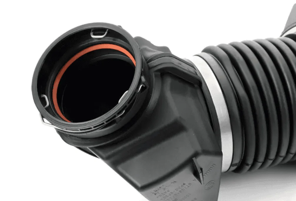

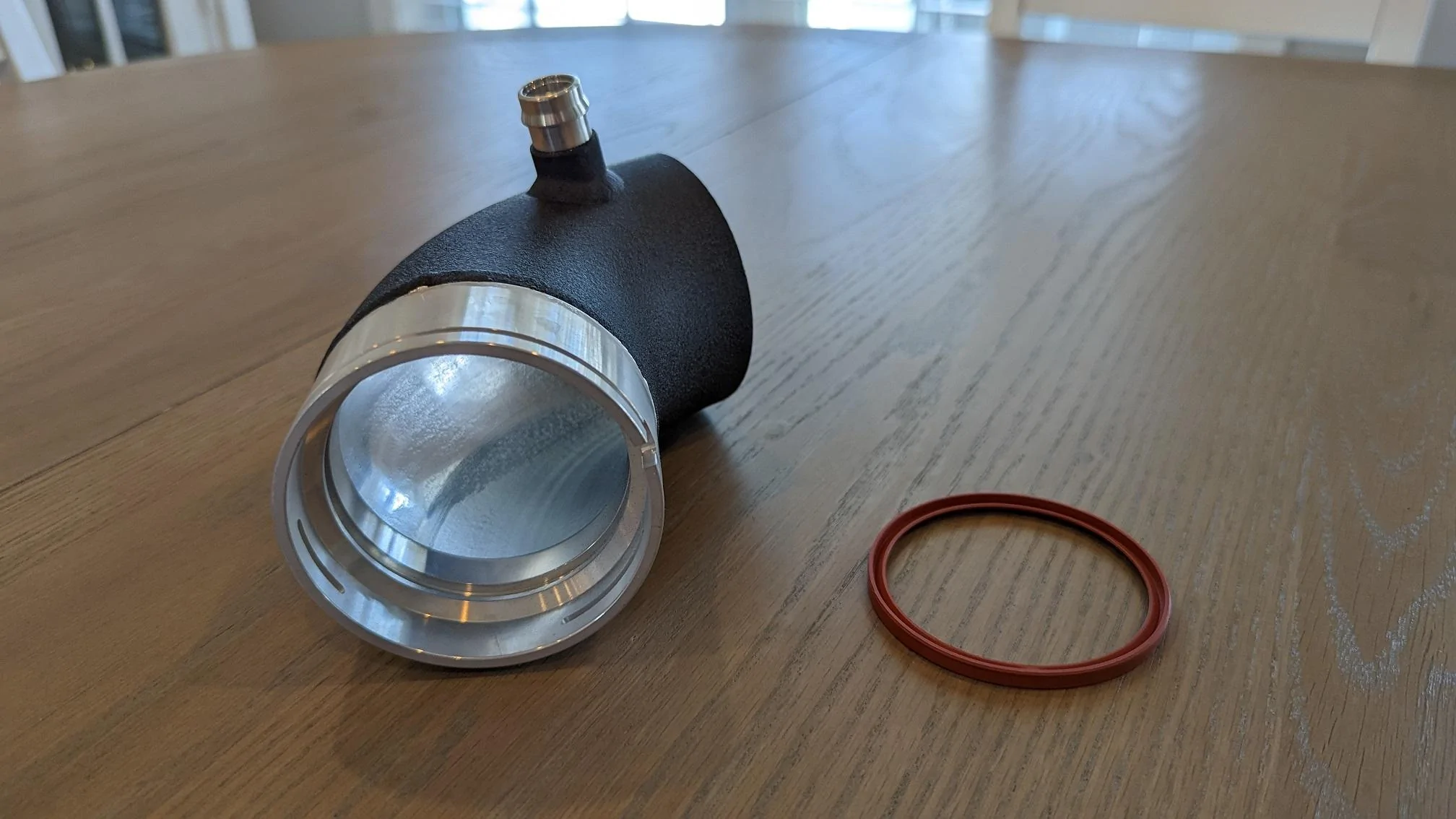

Unearthing this post rather than creating a new one. I think a YouTube video unnecessarily sent me down a rabbit hole. For those who have installed the MST v2 intake, have you taken the gasket on the right out of the stock intake and put it into the inlet pipe on the left that comes with the MST kit?

Yes, you need that gasket and the MST doesn’t come with its own, so you have to reuse the stock one.

I just installed this, and I initially made the mistake of not including the O ring, but after watching a YouTube video of the install, I took everything back out and added it. I watched like 2 or 3 just to be sure and they all mention it as part of the install. The instructions MST provided weren't very great :doh: .
It was a bit of a pain fitting the whole O ring into the insert. I didn't think it was going to fit at first, but once I got most of it in, I just ended up using a folded paper towel to squish the last bit in and it fit flush.

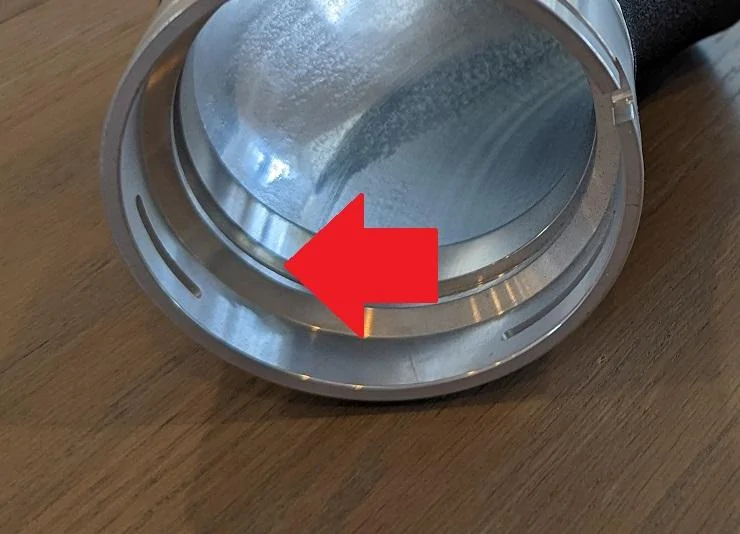

Thank you both for confirming this - much appreciated. I was having the same issue squishing it in there, which is why I ask. Since the top and bottom of the gasket isn't the same, do you remember the orientation it was inserted? Shining a light in the inlet pipe, it's not self-evident which way it should fit (groove towards or away from turbo?).

Maybe this will help?
