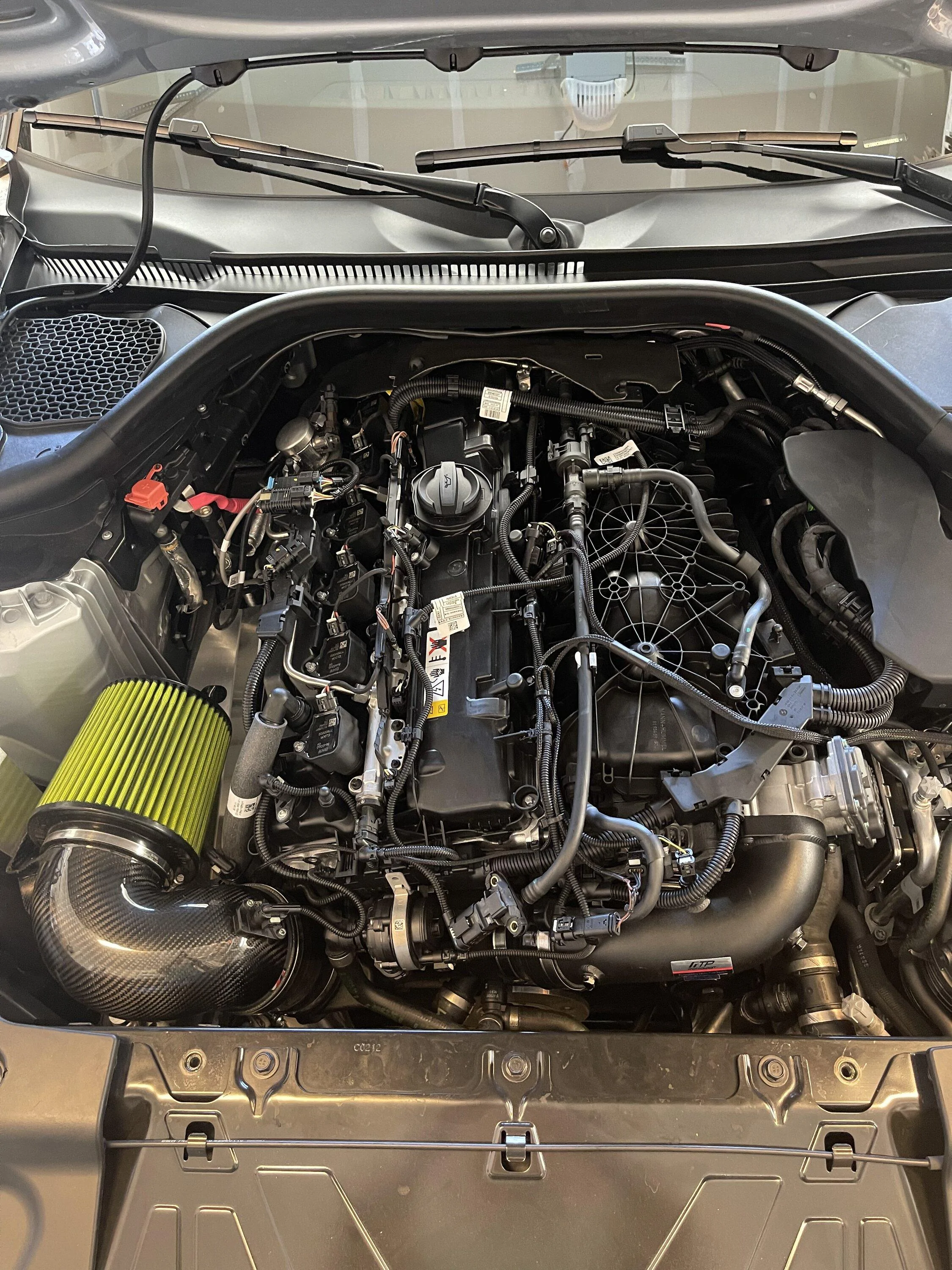

The only other input I can add is that the temps would only stay low enough not to pull timing for only the first 15 minutes of driving if it was in Summer. When I first installed the Injen it was in November so i didnt have any issue for the first few months until summer came around. Also I am in Arkansas and the humidity is more then Las Vegas. Not sure how much of a difference humidity matters but it is a variant. Jesse recommended me the Armaspeed intake so i put it on and it definitely helped keep the temperature down low enough to not cause the issue anymore. Not sure if there is a way to go back almost two years to look at the jb4 data but if it's a possibility I will be happy to try.

My spec for reference; '23 Manual - my engine code is B58B30C (340hp UK/EU) - built Aug-22.
I'm coming up to 1 year of ownership and I plan on bringing the car to the main dealer until year 3 for servicing until warranty expires as I don't have tools/right space to do oil changes at home.
I am happy with the stock power, however, very unhappy with the muffled intake sound and exhaust sound killing the B58's glorious sound.
I am not going to put an aftermarket exhaust yet, but after reading a lot of dyi posts here on intakes, and seeing Youtube vids, I am relatively confident I'd like either an EVenturi, MST or Armaspeed intake system, to add lots of induction and spool sounds and make the experience so much more exciting.
Here's my noob/dumb questions:
- Between Eventuri,MST and Armaspeed, which one is know the be the safest/most reliable/highest quality?
- Do any of these ever cause CEL?
- If CEL occured, can it be cleared at home with an OBD scanner?
- Once cleared would the CEL then raise questions from the tech?
- If you were doing what I want to do, i.e. custom intake but dealer servicing, would you put the stock intake back on for servicing or just leave the aftermarket one on?
Thanks to anyone willing to help.
An intake shouldn’t cause any trouble with CEL or servicing, in fact my dealers tech is the one that recommended I get the arma speed intake when I first got the Supra and I loved it. Had it for a year with no problems and recently sold it for the dinan intake and inlet because I like the brand more. Did lose a lot of sound but feels like a much better fit and I prefer the look
JoshuaQ
Joshua
May 6, 2021
311
210
PNW - WA
2021 GR Supra 3.0 Premium
Eventuri will be the highest quality - then armaspeed - then MST.
None will cause a CEL, nor will they provide any butt dynoable power gains. The OEM intake is fantastic. See if there are any UK based companies that offer an intake rensoator delete. I know verus engineering in the US offers it.
I cannot speak to experiences with MST or armaspeed, but I have the eventuri. There's some increased noise, but the two latter intakes will provide louder noise.
I got Armaspeed. No change in driving, just noise and underhood looks. It felt exactly the same from stock to Arma. I bought it for the looks and sound, so it works out perfectly.
