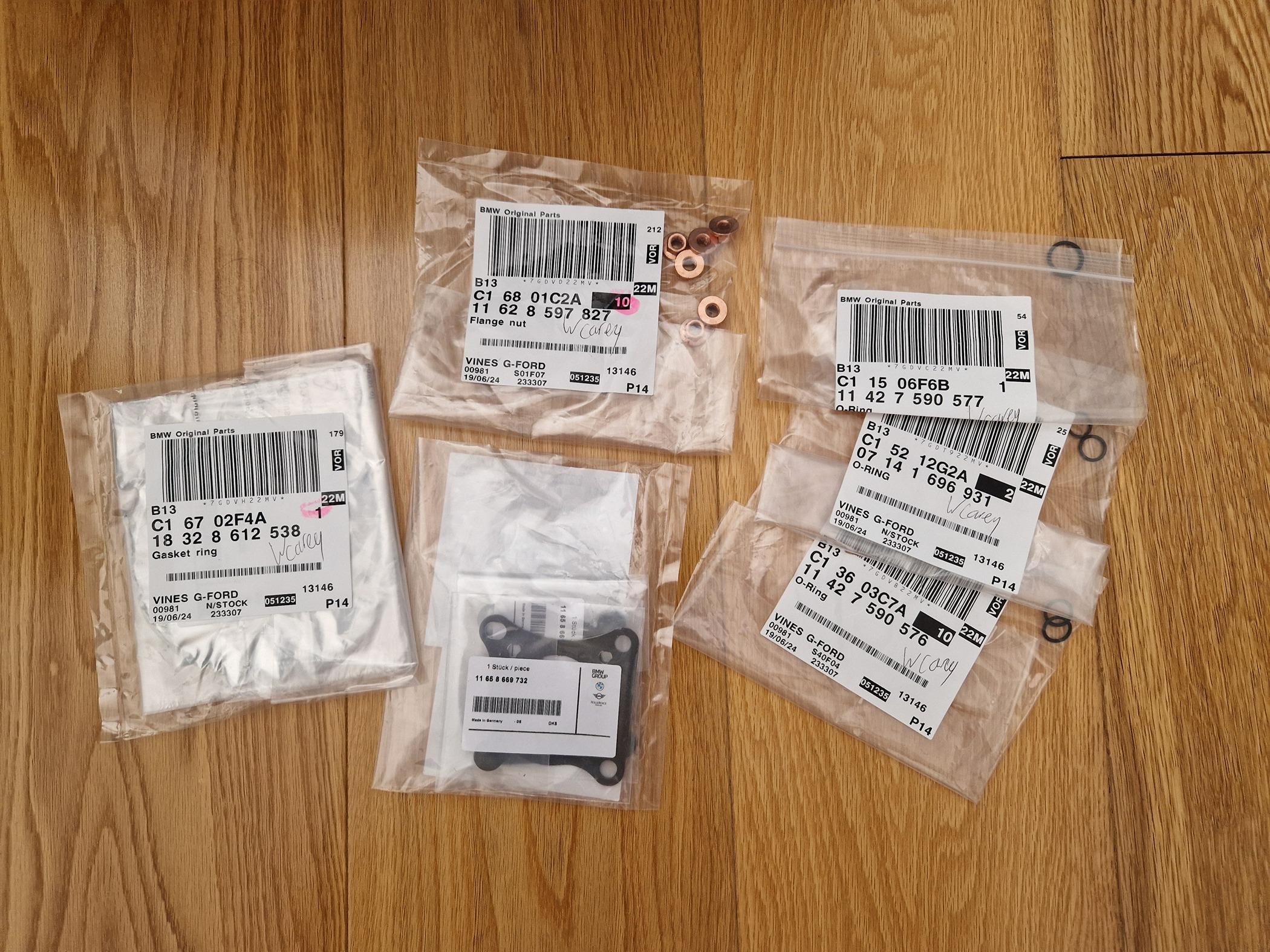

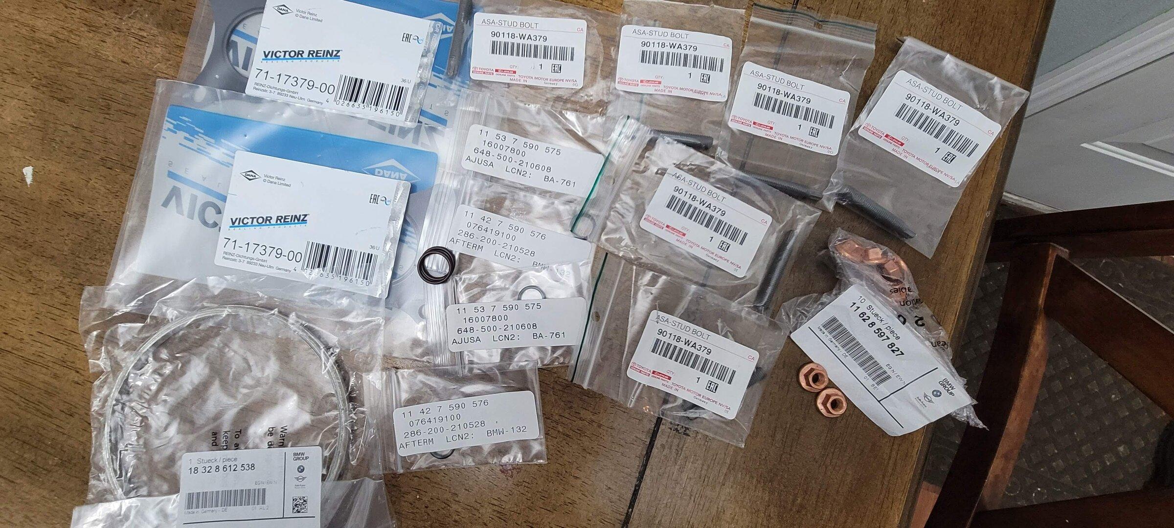

For 2 port turbo. Here are the nuts, bolts, gaskets, and 0-rings that are recommended to be replaced when doing an oem-body turbo swap. This wouldn't apply if you're going top mount or using a turbo that doesn't use the factory turbo housing - basically, anything outside of a Pure turbo. Posting this to help others as I struggled to find these part numbers myself. Feel free to add or correct anything that may be missing or inaccurate.
71-17379-00 qty-2
90118-WA379 qty-6
11628597827 qty-1
11537590575 qty-2
11537590576 qty-2
18328612538 qty-1

Do u have to replace the studs and nuts as well? Thank u for your hard work I’m gonna look into these as I’m about to install a pure on a 6 port ?
82
8,474
14,125
By the book, yeah, you do. Do you really need to? Ehh. Maybe not.
I did.
MYA90SUPRA
Feb 11, 2020
466
454
Wyoming
2020 Supra premium
I did.
That is interesting. I could see changing them if they were old and rusted but everytime that seems a but much.
