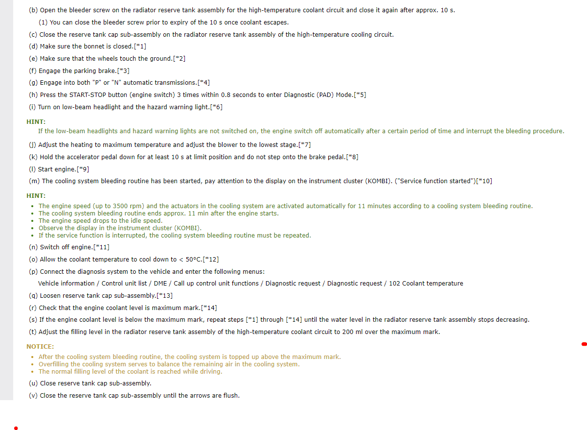

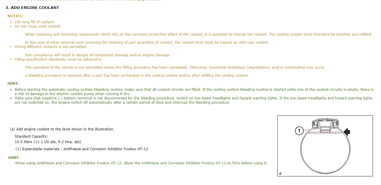

Coolant fill procedure below.

Thank you for the info! Very helpful especially the coolant process straight out of TIS.
