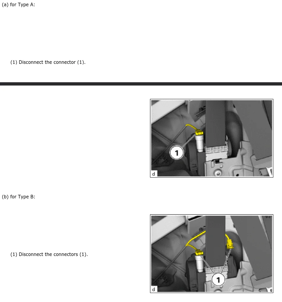

Here's the screen shot from the manual. Type B shows an extra electrical connector which should be for automatic tensioning.

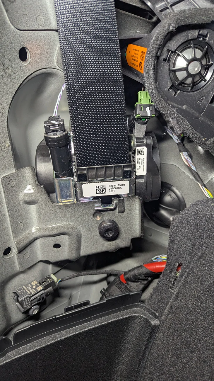

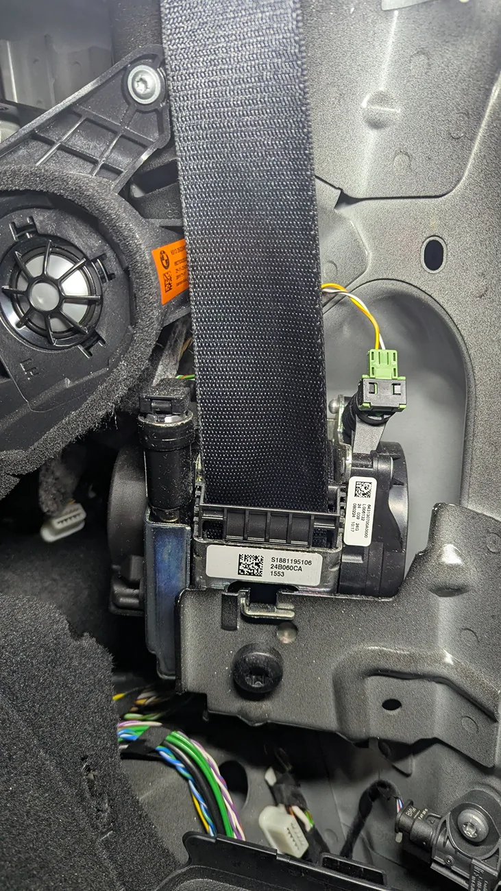

After a bit of disassembly, cuts, broken clips and a few lost bolts, I got to the outer seat belt assemblies on both sides.
From the looks of it, they are the same. Except for the bent tab above the bolt which I'm guessing is to make sure the sides can't be switched up. This is easily fixable with some pliers.
So, it should be possible to use the assembly from the passenger side on the driver side, or to get the get a passegner side assembly from the right hand drive versions :)

UPDATE:
I've ordered the belt for the passenger side, adjusted the tabs and it fit right in on the driver side. The car is not throwing any error codes, seems it's working as expected.
