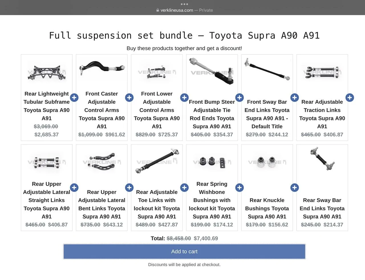

@razorlab - thanks for the reply. Any reason I should skip the cheap alternatives like Megan for $200? I'd lean toward the SPL or Verkline simply because the build quality seems better and +$200 more is moot if I plan on keeping the car say until I am too old to drive it anymore.

Megan toe arms have horrible adjustment design. I would go for verkline as SPL has quality issues. I have lost count of how many SPL bearings and broken toe arms I have been through. Their support is pretty good but I got sick of replacing things and generally being weary on track with them.

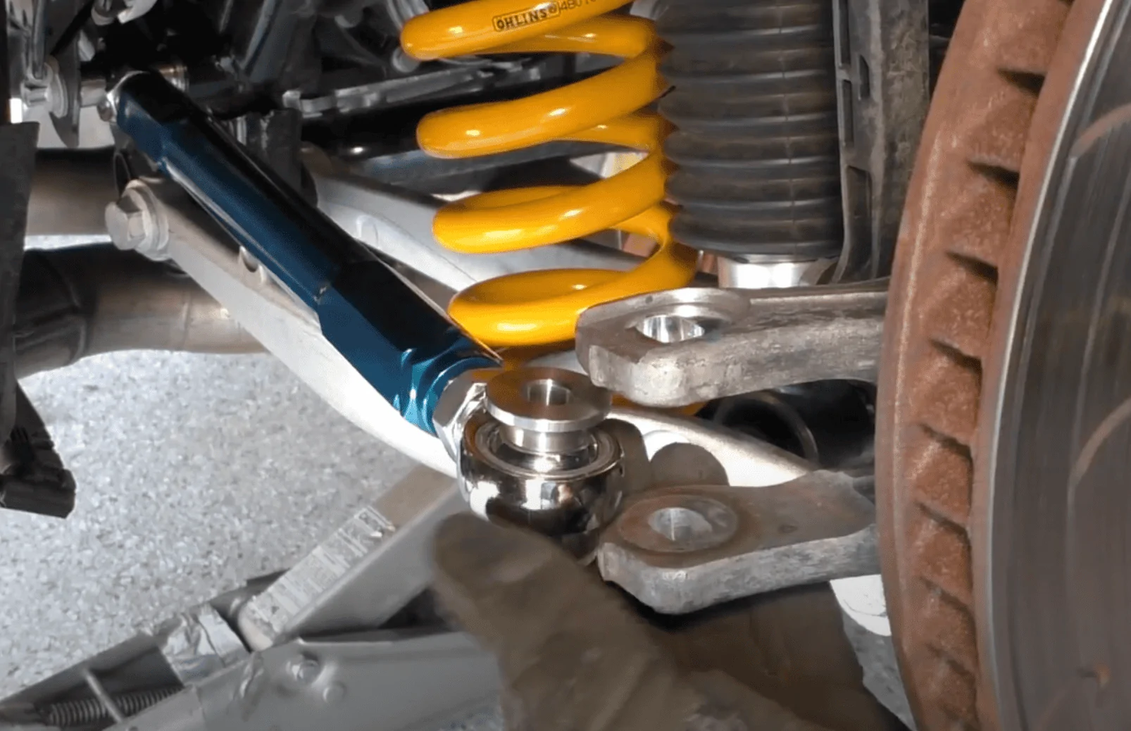

As a side note - I found Farkle from the BMW side who's done a video about the install and a little comparison. We've actually worked together on some BMW F30 projects a few years back. He did a nice write-up on the SPL and Turner arms and install on the G-platform, M2 side. (Adding here for this forum's archives.)
