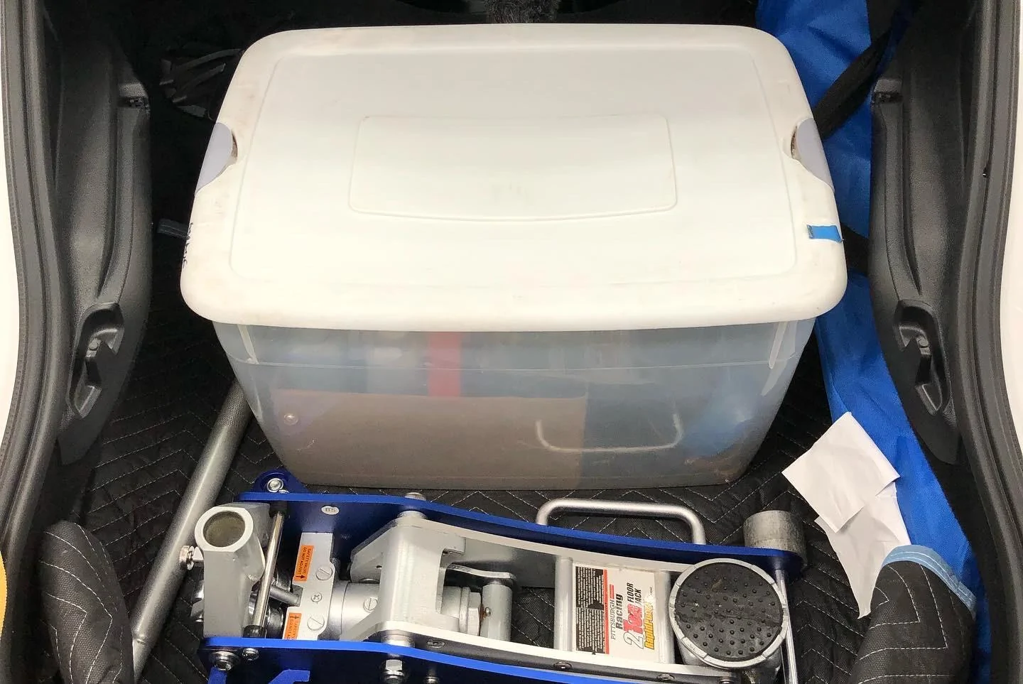

You can fit a good amount in the back if you do it in a smart way.
Jack
Jack stand
Folding chair
In the plastic bin:
Tool bag
Extra set of brake pads
Tire pressure gauge
Cordless impact
Torque wrench
Shop towels
Microfiber towels
Glass cleaner
Quart of oil
Zip ties
Piece of wood to drive up on if i need to jack the car up
Rolled up waterproof tarp

BMW jack pads for your jack stands.
8,698
17,044
Yea get those pucks!
Fun fact, out of the 41 track days I have done in the Supra so far I have only had to jack up the car 2 times. Both times because of a rock in the front brake dust shield.
I actually stopped bringing a jack and jackstand because I just borrow one from the 50+ people that are there.
