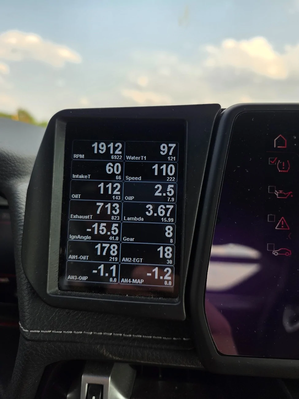

Track, track length, elevation: Silesiaring, 3.64km, no elevation change
Top speed: 221kph / 137mph
Number of laps: many
Turbo: custom Pure800-sized
Peak boost: 1.5bar / 22psi
Cooling modifications: 777 Hood vent, Wagner intake manifold, Koyo aux cooler, PWR HX + radiator, Verus oil cooler PWR core
Oil and weight: Motul 300v 5w40.
Ethanol level: no e specific tune, 98 benzin (us 93) +5L E99/tank add on = ~e10. ~461whp
Max temp: 37.5C/100F
Peak oil temp: 143c/290F - after 1 attack lap
Peak coolant temp: 121C/250F
Peak charge temp: -
Peak IAT: 66C/151F
No log.
What else can be done? Run e30 mix?

No log? So where are you getting all the numbers from?
Don't track in 100F and think the car will stay cool?
Islindur
Aug 25, 2018
741
697
Poland
Had:Yellow 2l Have: Red 3l
CAN based display, by no log i mean no logging file like MHD to look at and share here.
In lower air temps i regulary see 270+f oil temps anyway.
8,823
17,312
So you are doing that all from memory of something you saw on a display? There is no log file of any kind?
Islindur
Aug 25, 2018
741
697
Poland
I try to provide as much data as i can now.
I plan to include logging after the season with other changes, thats what I got atm.
