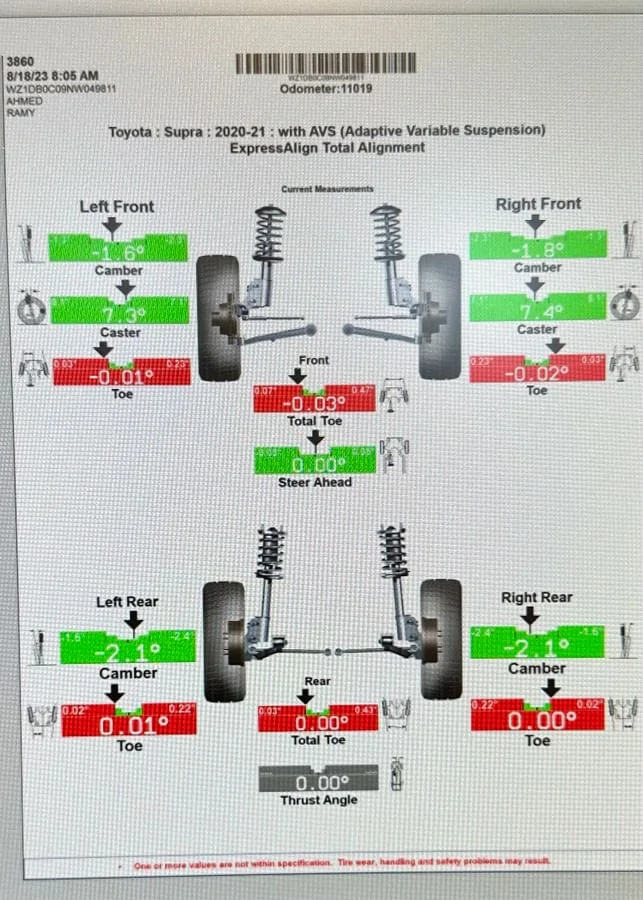

You basically have no toe-in in the rear so that is why it wants to kill you. On power, the oem bushings will basically flex enough to toe out the rear and you get drifito machine dynamics.
I run about 2.5mm toe-in in the rear. Not sure what that translates to degrees. I do my own alignments and use a mm ruler.
Even with that setting, I get even tire wear and I drive to/from events and on the street, but not a daily.
Total toe in, or 2.5 mm each side?

In addition to minimal front camber, he's running stiff sway bars and upsized rear tires. I can only imagine that he is probably plowing through corners, aggressively braking to get the front to grip, then aggressive on the throttle getting the rear to sort of grip before snapping when he lifts.

In addition to the alignment, you mentioned that you have your rear sway is on middle stiffness. You may want to consider softening up the rear bar to gain a little more rear compliance.
