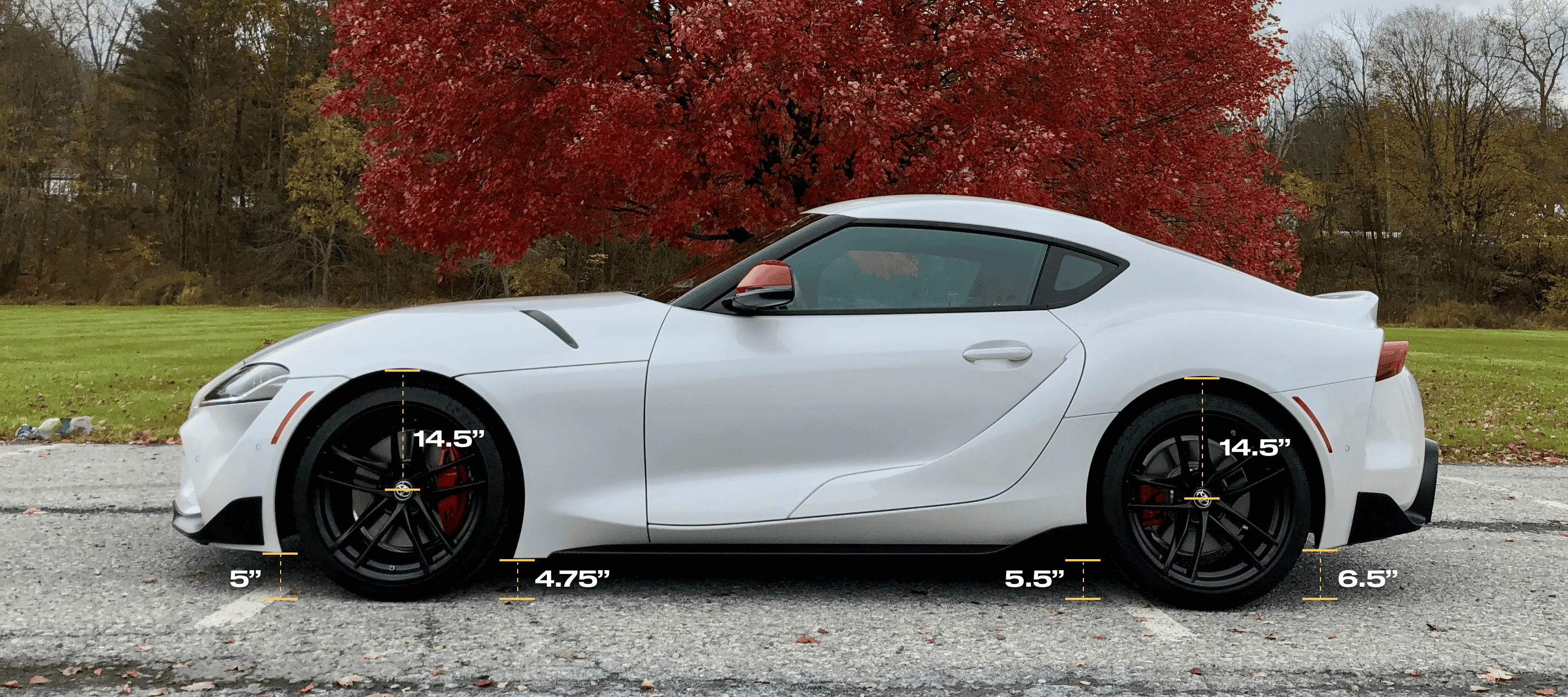

The napkin math I did shows something like Ohlins are too low, but what Vorshlag is recommending might be too high. I know Razorlab posted his someplace, I'll have to go find it. But, just trying to get some data points and reasoning behind the numbers.
First off, avoid Vorshlag like the plague. They have no business doing anything with the MK5 Supra. Secondly, don't listen to any setup advice from them on the MK5 Supra. Thirdly, find anyone else.
If you are asking about OEM measurements, here you go:
