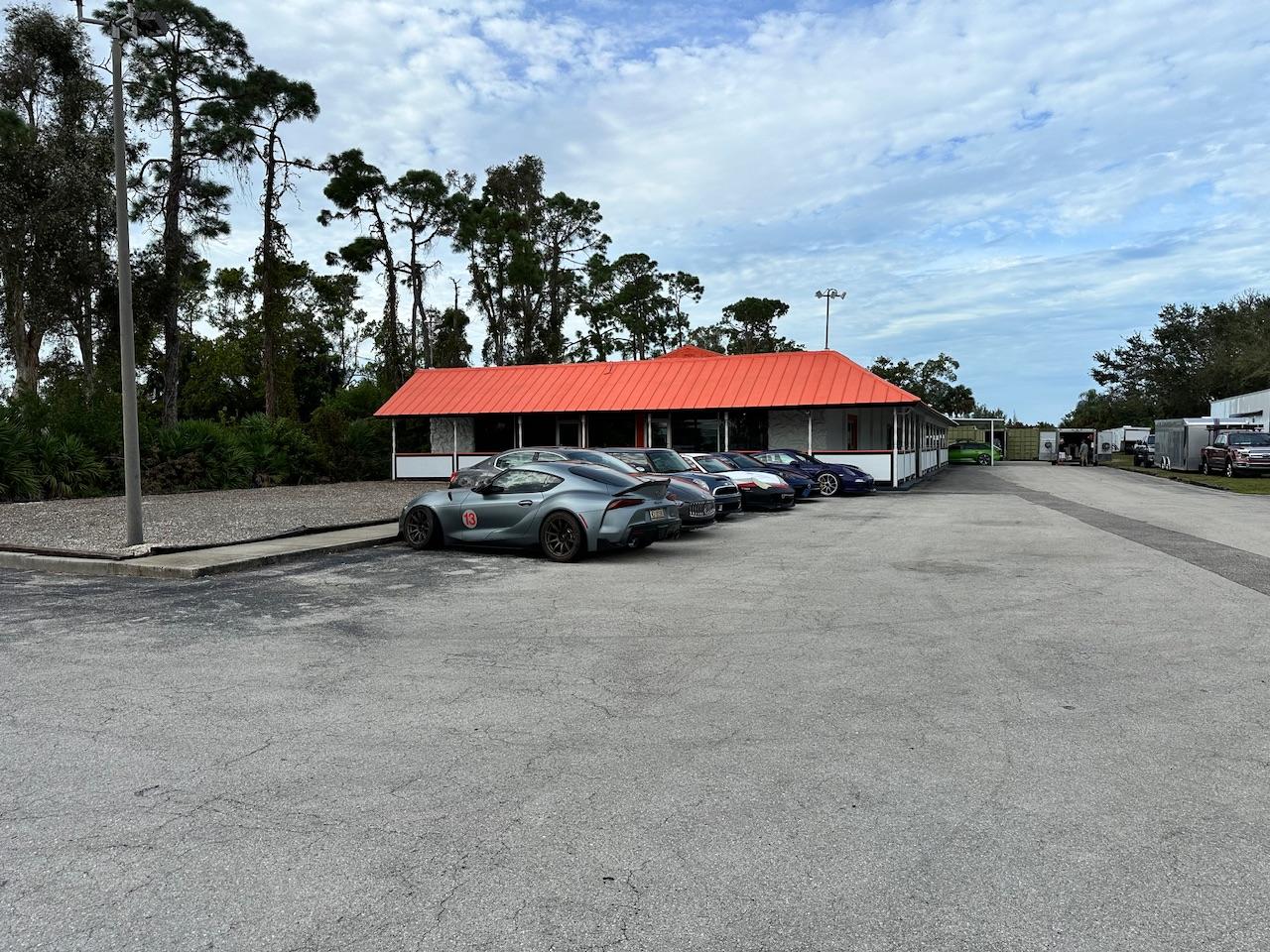

Still there ? Hopefully picking her up tomorrow… this will be the last time I have to go in for anything other than consumables ?

I am laughing WITH you.... but: "last time i have to go in" on a track car is.... wishful thinking :)
