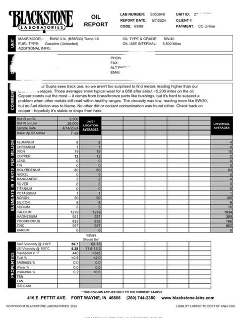

I know this can freak out many people. Take a deep breath…. But with Bryan (Brianna) is on vacation, I thought I’d squeeze in a quick track oil thought ? ?
Neighbor buddy‘s recent report above. Sounds like they like the 5-40 he’s running but the report suggests the oil appears thinner. Probably from our constant heat, schweaty SWFL, over 100+ Fahrenheit on track. As for myself, I‘ve never sent my oil out & don’t track during the summer. I’ve put the Turner MS suggested track oil or the mac daddy Motul
https://a.co/d/bIanZd4
Chemical engineering thread ? below if any of the new guys didn’t know about it:
https://bobistheoilguy.com/forums/threads/bmw-b58-engine-oil-recommendation.337089
EDYVW is my fav by far. Page one:
“That engine is designed around heavy W30 and lighter 40 grades. But, you could pretty much run anything in it. There is no such thing as overkill. Take into consideration that when you say "grade" that is KV at 100c. Your BMW in regular driving is running around 109-113c. That means that at regular driving, your oil is bit thinner than you think. That is why HTHS is important and not grade per se. There are different oils, some meeting minimum requirements, some exceeding it. Generally, oils with lower KV100 but really good HTHS are top of the line oils. Motul Gen2, Castrol 0W40, Castrol Edge 0W30, Pennzoil 5W40, etc. are all superb choices. Motul X-Clean+ 5W30 would be prime example of superb oil, as it has KV100 of 11.6 and HTHS of 3.6 and it is LL04. Valvoline European Vehicle is at 13.1 KV100 and HTHS 3.7, which is really good. Again I would go with approved oils for LL01 and LL04, regardless of weight. If you decide to track vehicle, than we are getting into different conversation.”
and page 25 quote from edyvw:
“They are not designed with grade in mind. Different markets have different recommendations. Initially, that engine in Europe was recommended for LL04, here LL01FE, now LL17FE, and moving to LL19FE and LL22FE. The reason is CAFE and WLTP. Tuned B58 are running 15W50 and 5W50 on tracks in many instances.“
