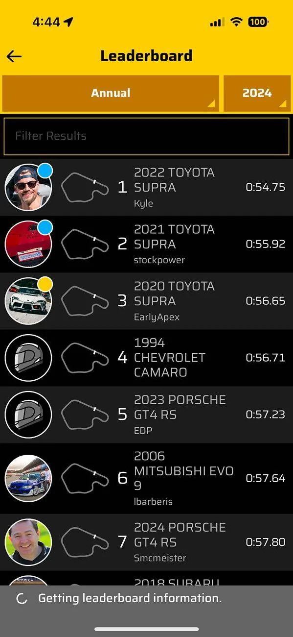

I never used the Catalyst to compare, but I know there is a lot of Catalyst at the track, people seem to love them. Unfortunatly, I wasn'T ready to pay the price
The one big thing I like about the Catalyst is the ego feeding feature of the leaderboards. ;) Well, that and comparing laps with others.
Like Kyle, Peter, and myself in the top 3 slots for the season at Lime Rock. Viva La Supras!
