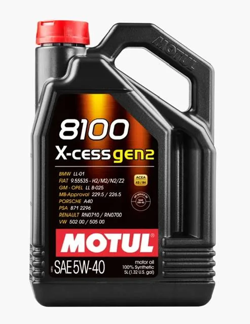

Can we just change the subject to oil? What oil is everyone using?
This one ? and it meets the fancy BMW LL-01 specs ?
Sir, did you not get the memo? 9 out of 10 interneters believe that running thicker than 0w-20 will cause world food shortages and the third coming of something apocalyptic. Nevermind that myself and others have proven this false by actual real world data.
