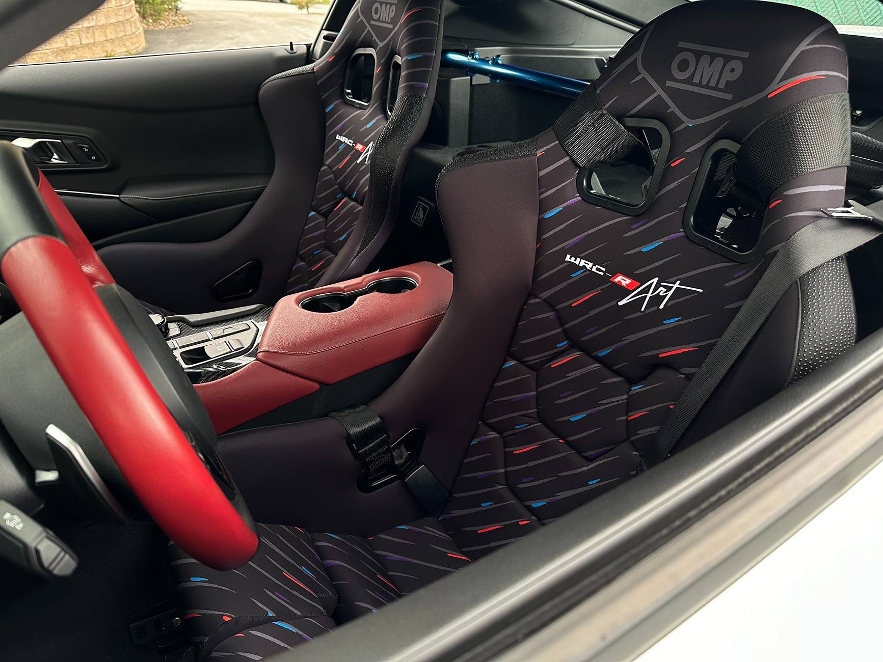

you'll want to route the lower belt through your lap belt hole on the driver side, otherwise you might submarine in a crash
Hah, was about to point out the same thing. Also want the same on the side by the trans tunnel.

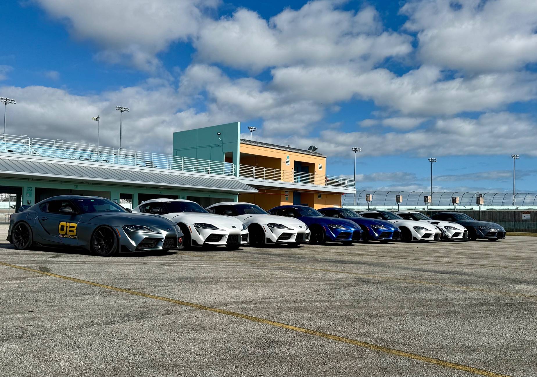

That second blue one from the left is quite a looker ?
Nice bunch of owners as well ?
wish PDG or TNIA events had these many. most events i'm 1/3. happy to see you out there @Gabe
FARA’s HPDE Academy & Chin might be worth considering as well. I really like em
Sebring is also a must do, if you haven’t done it already ?
