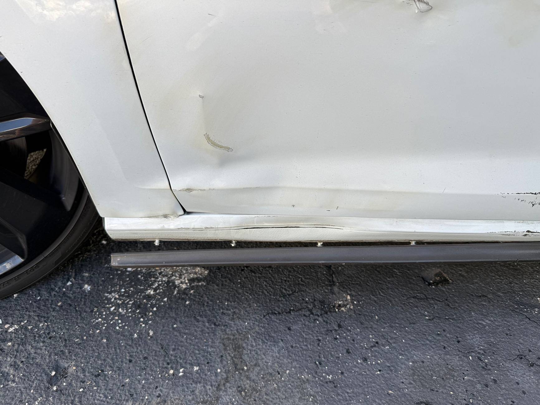

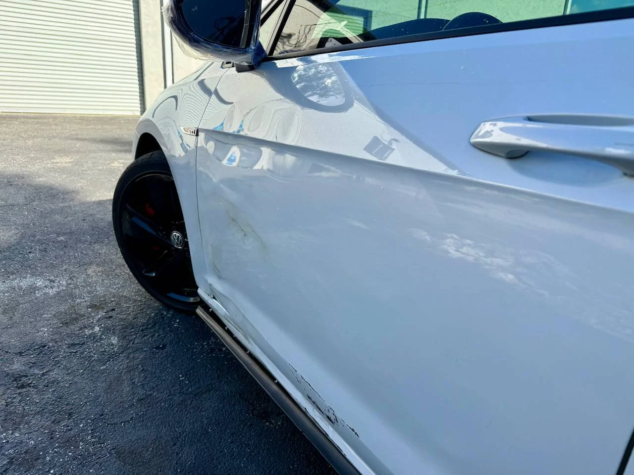

The wife had her 1st whoopsie in a LONG time.
So, I’m hunting for a salvage door ? Guess I’ll be still wearing my knee pad to my next track event. Supra seat(s) are delayed yet again.
