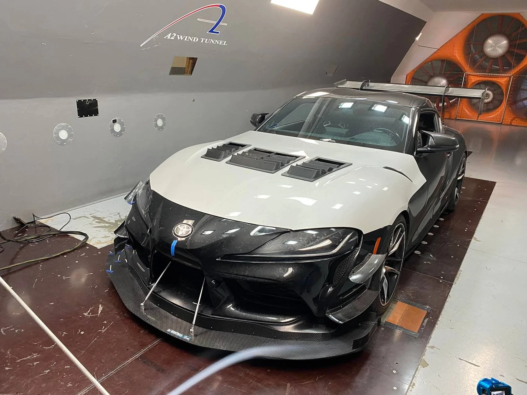

More like a bigger lip... no tunnels or anything... weak offering. I run their cold air duct tho.

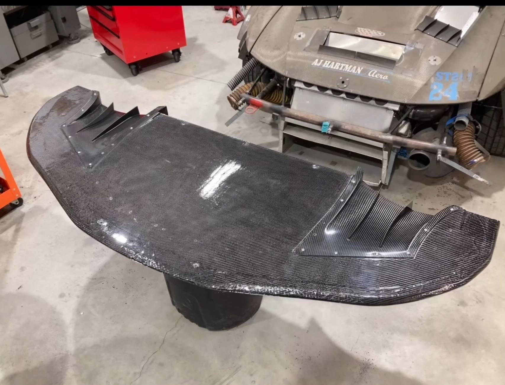

AJ Hartman testing his splitter, with very nice tunnels, should be out on the market soon with canards:
I like those hood vents:thumbsup:
