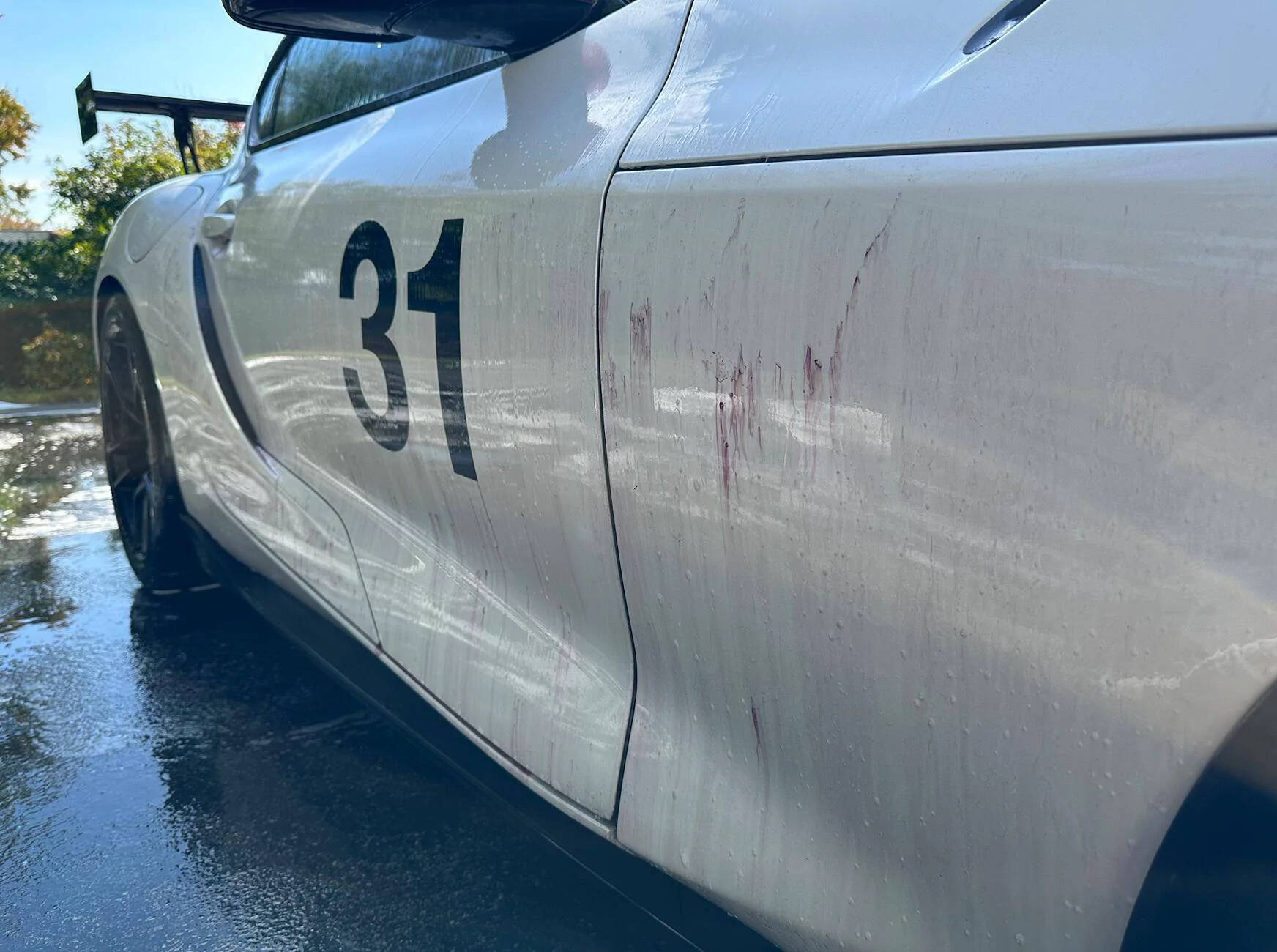

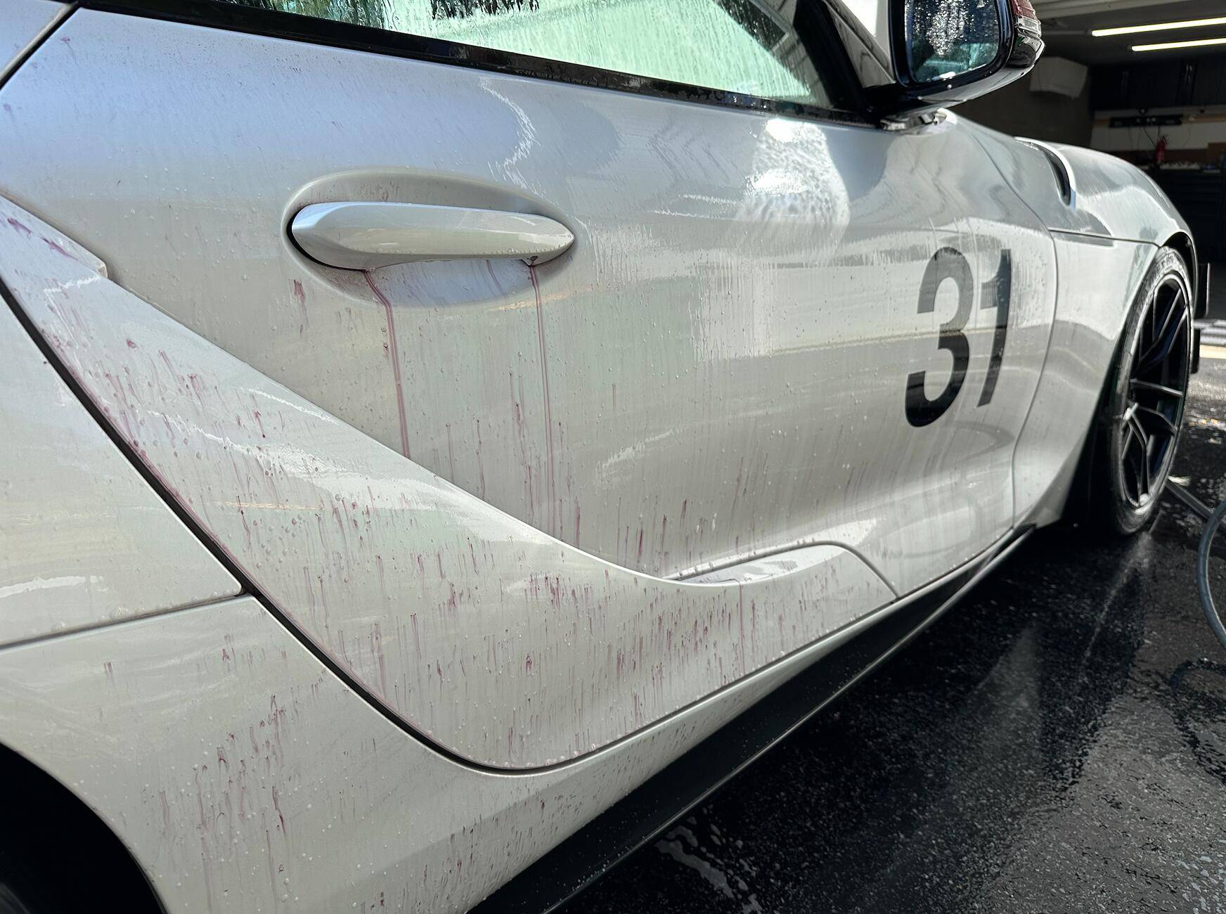

If you guys think DTC60s and DTC30s make a mess of your paint...Hawk Blues laugh at you. The dust rusts when you look at it wrong and manages to be corrosive at the same time. Hawk still makes them, they're cheap, and they like heat. They are treacherous on the street when cold. They're the epitome of old race brake pad compounds.

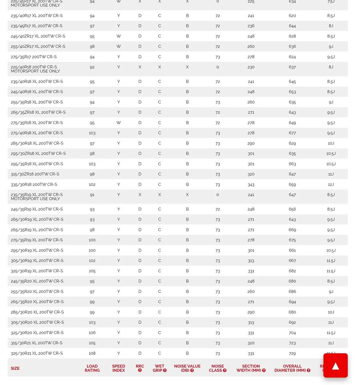

CRS sizes + actuall thread widths if any1 is interested. Last column is used rim width for measur.ent.

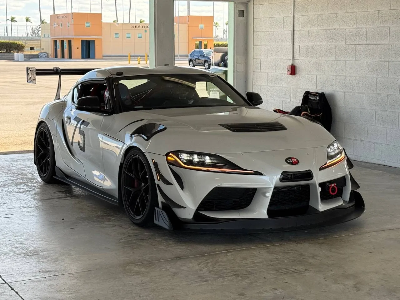

3) I drove @Gabe’s mean track machine ? Wow…. his car is no joke. Dude is on the right (build) track!! Looks even better in person AND rock solid going fast ?. The downforce and seats were track bliss. I could have pushed it harder - but he was in the car with me ? lol. Normally we all know you should put experience 1st & foremost…. But in his case, if you’re able to do it, can fix it yourself, and can afford it - Amen - Enjoy it!!!!

it was really awesome to get to know you and get some of that experience.
Riding shotgun on my car was an eye opener! (THANKS!!) I didn’t think a Supra could be driven THAT fast and sharp. Can’t even imagine how it should feel going all out on it! (That felt kind of all out to me tho)
this was my first track weekend so my focus is to learn the line and the braking / throttle points. Going slow I think I got most of the corners except that “S” turn where the yellow tires are…. I’m all over the place there. I think I got it so-so only once in the entire weekend!
because I’m so slow, I’m not using any of the downforce, but maybe in the future!.

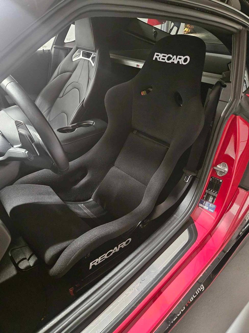

Do a seat 1st ;) I did recaro pole position, more comfortable than stocks for me.
