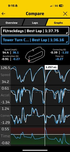

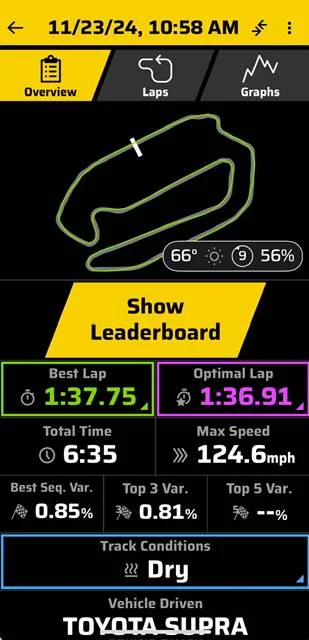

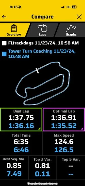

Have you considered a Garmin Catalyst? It shows you areas you can concentrate & improve on. Even has a voice coach while driving. Tons of data you can review on the unit and app (below) while at the track.
Multiple datapoints compared to your optimal or “friends” that share with you. Don’t have to wait to offload it, able to view on the fly, between sessions, whatever. Really makes it easy.
Once you get your variance down (like Tower Turn below ⬇), then you start looking at what else you can to do to the car. I’ve got a lot of time left on the table. So that’ll be my focus. Improving on my schlopy driving (braking harder & later above is a good example where he was much faster) & more consistency.
