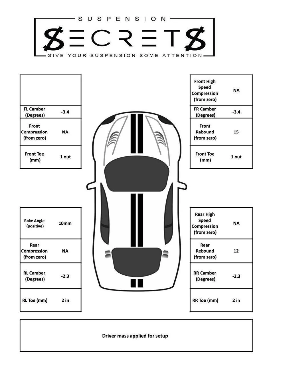

These are the alignment settings that were recommended by a really good suspension shop in the UK. I bought a set of camber plates from them, and after a couple foe exchanges, they sent me this based on my parts (200tw tire, Ohlins etc...) and use case (amateur time attack build)
Thoughts?

I prefer my front toe 0.5mm out otherwise looks really good if you’re not rotating too quickly with that much toe out. My front camber is -3.4 and rear camber is -2.7 with 2 mm toe in the rear. This is best for me pushing hard on flat & bumpy Sebring. At Homestead my toe stays the same but camber is slightly less negative (front & rear). If I know I’m going to frequent Homestead more.

That shop is very competent and this is a reasonable alignment for a modest track build. You can potentially run more camber, especially with grippy tires, soft sidewall tires, or aero etc. I would trust their feedback if you need changes made - they will steering you in the right direction.
Thanks a ton Kyle for the advice. (enjoyed watching you at COTA)
